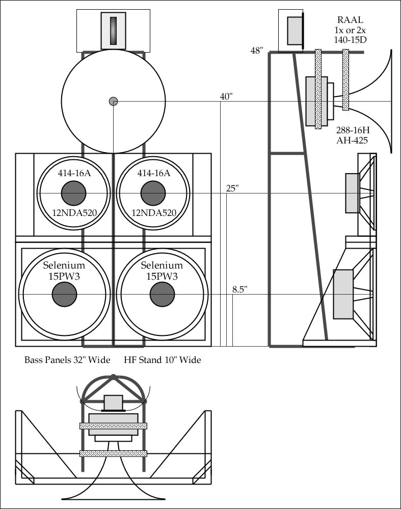

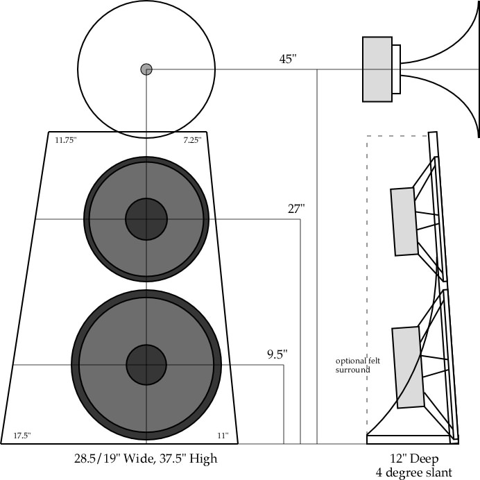

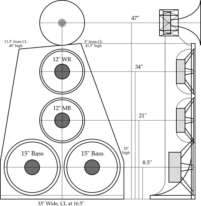

Impressive. But ...
Did you actually build any of these big dipoles ?
And did you measure them in your room to determine the real equalisation requirements ?
And, most importantly of all, did you listen to these dipoles ?
You do realise these are nothing close to Orion. Orion has small baffle, small drivers, low Qts. They were chosen by Linkwitz for Orion driven by the obsession of having constant directivity.
With his baffle and driver selections, the equalisation requirements become as they are, for Orion. But your drawings are not like Orions...
![110073d1213227432-beyond-ariel-azura_frame.jpg](https://www.diyaudio.com/forums/attachments/multi-way/110073d1213227432-beyond-ariel-azura_frame.jpg)
18" + 15" dipole
![113513d1218009279-beyond-ariel-azura_slant_15.jpg](https://www.diyaudio.com/forums/attachments/multi-way/113513d1218009279-beyond-ariel-azura_slant_15.jpg)
![86295d1180244476-beyond-ariel-dipole.jpg](https://www.diyaudio.com/forums/attachments/multi-way/86295d1180244476-beyond-ariel-dipole.jpg)
