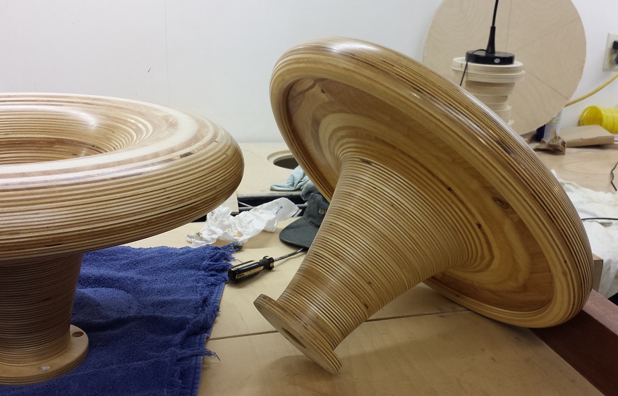

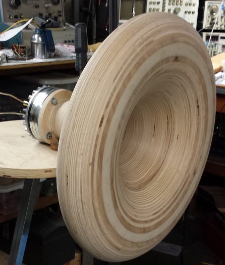

Here's some pictures of 1.4" throat 425Hz JMLC horns turned from layers of Baltic birch I did a year ago. I've also done 1" throat variations at 1K and 600Hz.

Endlessly interesting thread as usual. Wonderful woodwork too. I'm not sure these ugly horns have much WAF, but I know the elegant tractrix horn Pseudosphere from geometry. Constant negative Gaussian curvature. Something special.

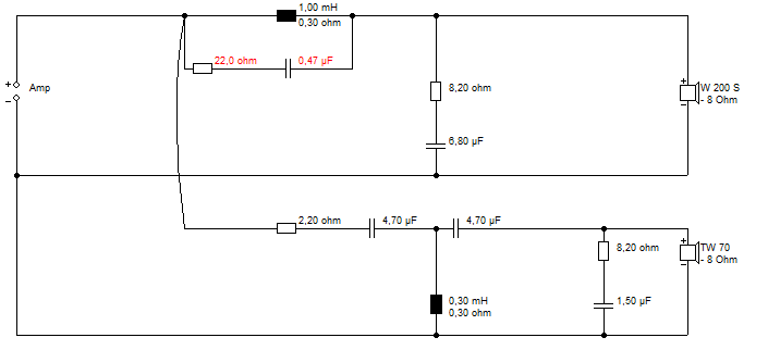

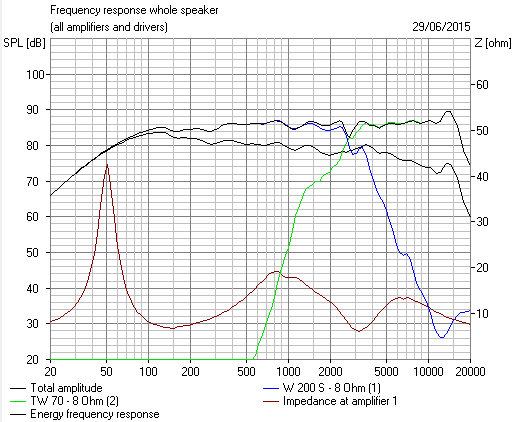

I'm really not sure whether valves were what provided that lovely tone anymore. I know exactly what you are talking about Lynn. My Dad's radiogram had room filling tone in spades. Voltage or current drive can get you there if the impedance is flat IMO:
And TBH, I get a nice tone from some current efforts. Even with solid state and CD and ferrite speakers. This is with lively drivers.
But there is work to do on magnetic materials. Which really is the WORST non-linear crossover component in measurable ways. I have real trouble with this 7kHz tank notch across a ferrite bass coil. It adds something good, but gets harsh. I don't know if that is distortion from the coil ferrite in a highly resonant circuit, or a rocking mode from the bass.
A bridge technique might be the real way to compare AlNiCo to ferrite and even air coils.
Perhaps I should buy some good air coils and sort it out! Images more to explain myself well than promotion of particular styles. :eek:
