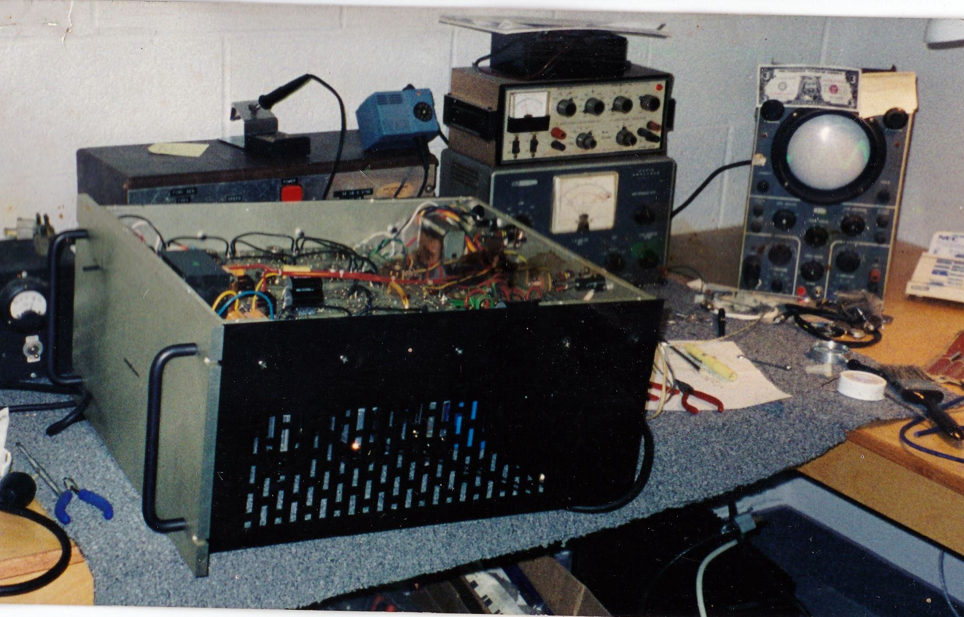

My preference for vacuum tubes is based on two factors: performance at the device level, and a strong subjective preference.
* Performance at the device level: lowest proportion of high-order harmonics (a spectrum with a fast decline in harmonic structure), freedom from hard overload, freedom from overcurrent damage (no protection circuits required), and low capacitance at the driving terminal (60 pF vs 1000 pF for MOSFETs), in addition to the capacitance itself being highly linear (MOSFET capacitance is nonlinear and difficult to drive). As a minor point, these devices self-heatsink, and operate reliably at high internal temperatures.
The downside is they wear out (after thousands of listening hours), require a high operating voltage (typically 250V to 500V), and dissipate lots of heat. However, for a Class A amplifier, heat dissipation works out the same, which is why both transistor and vacuum-tube Class A amplifiers max out around 20~30 watts.
The wearing-out is a complex picture. Vacuum-tubes shift operating parameters in the first 10~20 hours of operation, remain stable for 1000 to 3000 hours afterward, and slowly decline in performance as emission from the cathode or filament falls off. If the vacuum tube is defective (has gas remaining in the envelope or is built with contaminated metals), then it won't operate satisfactorily in a fixed-bias circuit (commonly seen in medium to high power PP pentode amplifiers).
Marginal or near-defective tubes will operate in a self-bias circuit, but won't sound or measure all that great. (Double-checking the steady-state voltages and currents will reveal a bad actor ... drift is usually a bad sign. Good tubes fall in a pretty narrow window, about 5~10% scatter in parameters.)
Transistors have long lives, although this is a function of die temperature and how many times they are subjected to overload, and then fail suddenly without warning. The failure-mode is frequently a short, which then takes the driver stage with it, along with the emitter resistor. The circuit board can be scorched if this happens, depending on how quickly the fuse or protection circuit activates.
So the real question is, will the devices be available ten or twenty years from now, when failure occurs? Thanks to the guitar community, it looks like the classic pentodes (EL84, EL34, KT66, KT88, 6550) will be manufactured decades into the future, along with the simple discrete analog components needed to build a guitar amp. The low-tech manufacturing of vacuum tubes has the advantage of smaller capital requirements (compared to silicon manufacturing), and steady sales of millions of units into the replacement market.
* Strong subjective preference: I switched from transistors to tubes back in the early Nineties. I'm struck by the fact that just about any dumb tube circuit sounds pretty nice, while it takes a genius-level engineer to makes a good transistor amp.
I had the remarkable good fortune to work with Bob Sickler when I was at Audionics in the Seventies ... who knows what he'd be doing if he was still around. Gary Pimm has a very unusual current-mode MOSFET amplifier, although I still (marginally) prefer the original direct-heated-pentode version. Nelson Pass is a great guy and a tremendous asset to the DIY community, but based on several demos I've heard at hifi shows, his subjective goals are very different than mine. If I was told I could never listen to a tube amp again, I guess I would try the new Benchmark amplifier.
