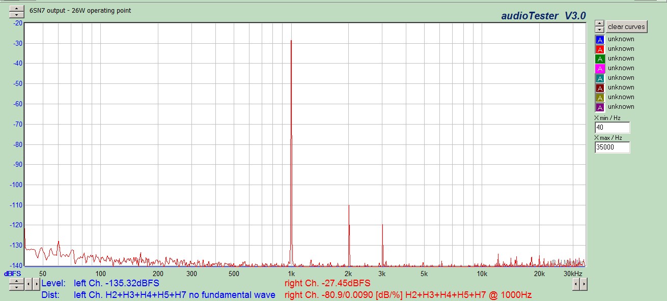

I very much appreciate Zigzagflux's experience with the RC-coupled 6SN7 input stage. A tube as linear as a 6SN7 (and there are so many to choose from!) isn't going to be working very hard to deliver 12~15V rms into each 45/46 grid. It's also nice that 46's are plentiful and a good alternative to 45's.
The weird thing about the Karna amplifier is that it is so damn transparent; every little stupid change in the system is audible. It still sounds like a 300B amplifier, just much more powerful than SET's, except for the gonzo transmitter-tube SETs with 1500V power supplies.
It's hard to argue with an input stage that looks like this with 20V output to the driver grids. Just think what a 45 could do with this. Overall result is around 26W at 4 ohms.
Output at 1W is a barely noticeable 2nd at -135 dB (-93 effective). That's a world better than what I was getting with the first stage IT, consisting of a lot of 3rd and 5th.

Man! The 2nd harmonic is at 80 dB down, the 3rd is 90 dB down, and there's nothing else! Astonishing! All with zero feedback.

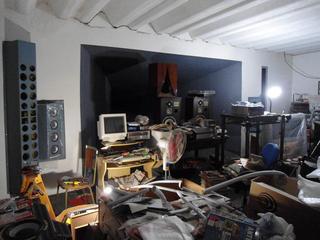

Someone mention big speakers? Someone mention horn bass speakers?
See below an correct example for an true exponential horn for bass, from an friend of mine:
...I never heard bass sooooooo clear and clean, PERIOD.
Brazilian Backstage magazine plus people from Selenium made an technical review from those "little thing"
and they were quite impressed with the result! Far lower THD and HUGE SPL than every another option. Almost 109dB/1W/1m to less than 20Hz.
Unfortunately, I only heard bass demos because the system is disassembled for reform ...
SURE this will be my project beyond the beyond the Ariel (ahem ... TQWT, in my case), when I have a terrain with room for such a venture.
Is there a tip, if someone from DIYA have a good space on your garden... and made every 10k$+ subwoofer seems like an kid toy without dynamics or clean sound.

Excellent result! I have always believed in 6SN7 family / 6FQ7, work excellently with RC circuits or current source (see Morgan Jones book about low THD valves); these tubes are indicated for this function.It's hard to argue with an input stage that looks like this with 20V output to the driver grids. Just think what a 45 could do with this. Overall result is around 26W at 4 ohms.
Look forward to seeing how the Coleman Regulators work on the 46 and 300B; that was another motivator to rebuild the amp from the ground up. Along with the bifilar Monolith IT; able to get a few dB less distortion over the Lundahl.
Not to digress from the speaker discussion, but you are intending on using the amp to drive the new speakers.
I myself have similar results in my testings, but with the 6FQ7, which can replace the 5687 without having to change the case/socket, only rewiring the pins (good news for Linn Olson). And I have an little amp for Stax phones who have an balanced stage with E88CC Siemens RC coupled to an 5687 trafo coupled to Stax. I have some complains about some high order residual HD, and this originates from 5687 according my measurements, not from E88CC... The E88CC receives signal RC filtered directly from ESS9018K2M balanced voltage-mode out. Simple as that.
I have to echo what Lynn says, those measurements are incredible. Are you using the Pimm pentode CCS or a solid state one? And what is the operating point of the 300B?
