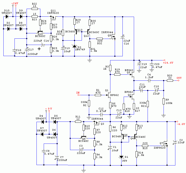

I managed to get rid of the hum finally, but not with the trafos connected as in post #248 If I shared the negative supply winding with another supply anyhow I connected their grounds I got humObviously there's a ground loop that affects the -V supply. Chasing it is the only way to go - try different ground connections between DAC and preamp, dividing signal and power ground. When you find the solution analyze the ground path so that doesn't happen again

Anyway, in the meantime I received my toroidal trafo ordered specifically for my application, so the preamp has separate windings and everything is OK now. Super silent, no hum, no noise and it sounds marvelous. I will try with BF862 and J310 in the following weeks.
p.s. It's a bit cumbersome that I need 1.3V from a 36V DC supply so I have do drop a lot of voltage. I use LM317 to pre-regulate to 15V DC then the shunt reg set to 5.5VDC then two LEDs in series to further drop to ~1.3V... life is hard

Is the voltage output form the shunt determined by the zener D3? i am planning to build another shunt for my dac that requires 18 V dc.
Thanks to JUMA especially.
kp93300
I suppose you are talking about this preamp (disregard the cap. multiplier). If that's so, you should know this too.
Answers:
1) C14 can be anything from 47uF to 470uF and C17 is "the bigger, the better" type.
2) Use good parts from reliable suppliers, but don't waste your money on "Le Boutique Audiophile" nonsense. The value of the coupling cap (C1 in preamp sch.) should be adjusted according to Zin of the following stage - 10uF will cover you down to 10k. Wima MKP 10 or Siemens stacked foil is what I use in that position.
c) yes, 24V AC will do the job. If you go higher than that Q11 will need a bigger heatsink.

Yes, D3 sets the output voltage. Just take care to provide at least 20V AC before the rectifier.

I refer to the cap multiplier in this schematic :
http://www.diyaudio.com/forums/attachments/pass-labs/180140-jfet-boz-j310-preamp.png
I want to seek clarification -----
I have to change Q1 to BC558 and reverse the polarity of c3, c5 and C2 ?
Is there a great advantage in building the cap multiplier before the salas shunt ?

I wondered about this also, a while back, and then I came to the idea that since the salas shunt reg is so good why not put a salas shunt reg (instead of cap multiplier) in front of a salas shunt reg. I never tried it though.
It is probably over kill.

cap values and BC 548, Bc 560
Hi Juma,
I am starting on the negative rail of the power supply for bf862.
I notice that C2, c11, c10,c19, c13and c16 are all 22Uf.
Can i substitute all these for 47 uF ?
Can i substitute BC 548c with BC 548B and BC 560 C with Bc 560 B.?
