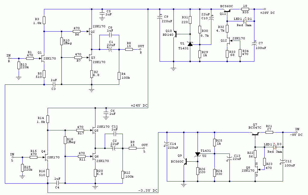

I received a request for version of this preamp that uses 2sk170BL (Idss about 9mA). Right now k170 is easy to get and BF862 is a SMD component (not convenient for old hands and eyes
), so here is the schematic.
The gain is a bit higher (9 dB) and the PSU is a bit different (be exact with input DC voltages +28V and -8V).

Those who have already built B1 and just need some additional gain, can add just the gain stage (and the PSU) in the existing box. Coupling cap (C3) is not needed if your B1 already has one at the input.
Wow, thanks I think I will try this. Do the sk170 jfets need to be matched?
Are you saying this needs its own power supply, or is it fed off the existing one?
Russellc
If you are talking about gain stage from post #286 it's just one JFET per channel, but both channels should be same.
It needs -3.3V and +24V (both very, very clean, the neg. rail especially).
Gain stage is designed to use 2sk170BL with Idss about 9mA (8-10mA). Voltage of neg. PSU is chosen for amount of gain we aim for and Idss of JFET at hand. That determines the Rs and Rd too. I always aim for Id between 70% and 90% of Idss.
yes, this is the one...I see only one fet, I was getting confused, that question concerns the BF862 preamps SK170s. sorry.
The one shown for the Preamp the thread concerns (BF 862) appears to be perfect for it? Post# 283
Russellc
PSU shown in post #283 is something that I use lately. I like it very much. You can use whatever PSU you like providing that voltages are right and noise is low.
