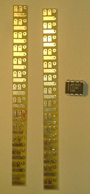

I have seen a guy on YouTube use a solder wick role as a way of spreading solder to tiny legs. i think it helps with heat as well. Impressive!
Juma, I got my BF862's today. All I could do was laugh. Anybody who works with those little things regularly should be commended. Oh Yeah, I got 30, but i don't think that was enough.![]()
You can get solder past from Kester -- I apply it with a really fine tweazer -- then you hold the part down with a probe and just touch the critter's legs with the soldering iron (I use a hako with a needle tip.)
If you have a lot to do you can adapt a toaster oven -- there's a specific protocol of heating and cooling that you're "supposed to follow".
The RatShack protoboards have enough space between the traces to use "0805" components. For me, this allows a lot more components on a board.
Lastly, the gates of the paralleled BF862s will fit on the long runners, but not all smt transistors are configured the same.

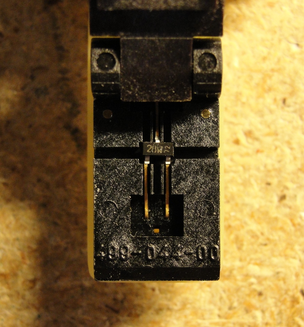

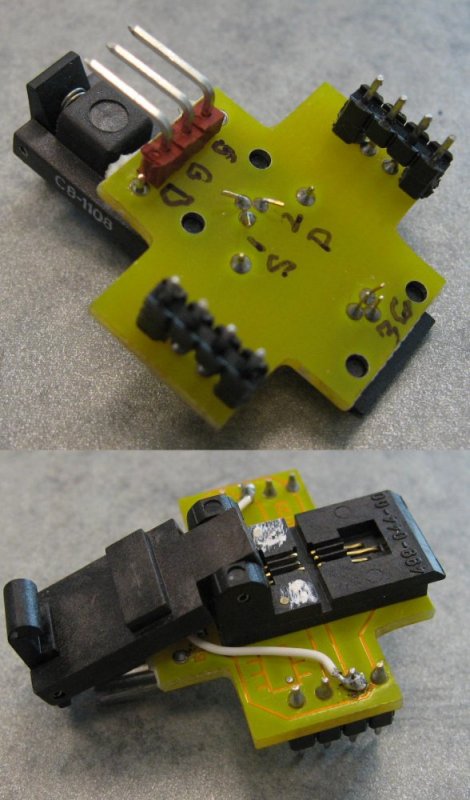

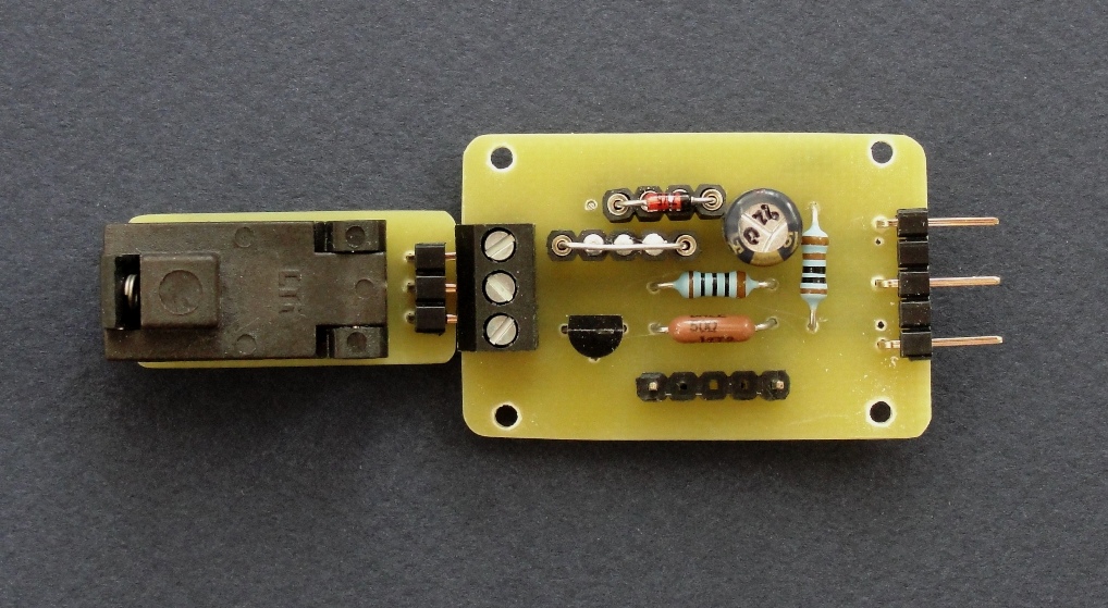

I finally got around to hacking a BF862 adapter together for my jfet sorting jig, using a 6-pin SOT-23 clamshell-type ZIF socket available reasonably cheaply on E-Pay. I had to do some rewiring, but I now have a jig that plugs into the "J170" socket on my tester, so I won't go insane trying to sort parts. I've had a strip of 100 parts waitng around for this development. I wont be doing this preamp, but instead have an RIAA amp that will use gain blocks consisting of a BF862 and a p-channel small signal mosfet. I'll be starting another thread for that project whaen I'm more sure of results.
Anyway, if you search on E-Pay for "SOT-23", you'll run across a lot of parts, and several Chinese/HK sellers offering the socket. It's originally intended as an adapter for some PIC-type device in a 6-pin SOT-23 package, but it will accomodate a 3-pin SOT-23 just fine.
That looks like the one from emcs2009 for $50 - SOT23-6 to DIP 8 PIC -
looks like the clamp presses the transistor down into a recess with the 6 (?) contacts underneath, yes? and connect the pins to external cctry for testing as per your photos.
Are there some extra transistor on the pcb? If I may ask, what do you use them for?
There's nothing extra on the PC board, though there are a few spots here and there for surface mount components. I added a 1k 805 resitor on the board (not visible) as a gate stopper, as the BF862 is very slippery. I've had problems with spurious readings in test jigs before due to oscillation with far less slippery devices - all my new test/sorting jig designs incorporate gate stoppers.
Just for clarification, a fair number of the wires you see labelled in the top pic are the gold-plated contacts coming from the socket - I labelled the ones I wanted to use and traced out where the PC board connections went with a VOM (I'm old, but I ain't stupid...). The red-based right angle header was added by me, and that's the bit that plugs into my jig. I cut traces and added jumpers to connect the chosen contacts in the socket to that header. I also removed a second PC board that was sandwiched on top of the one you see in the pictures using a hot-air pencil (a great tool for removing parts in plated-through holes where a fair number of pins are involved - the dragon's breath does it...). The header went into some of the holes left behind by that removal.
The Farnell socket looks like it's a better quality - at times, you do more or less get what you pay for. Instead of removing contacts (a direct solution - I still may do that), I marked the socket with white splotches indicating orientation). I may still amputate contacts... Chop, chop (think first, chop later...)
