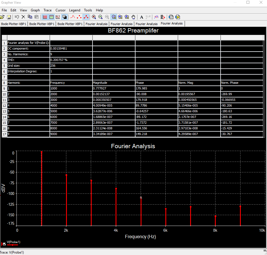

That was fast build and measure... Oh wait !
No, it's just a malevolently adjusted simulation...
I'll show you mine, if you'll show me yours.
I don't do thd measurements .
If you did, you would observe that THD% is, somewhat, a function of the bias voltage.
I have built this preamplifer...
No need for that, although bias voltage is not the only parameter that influences the end result and the THD will not tell you much about the way it reproduces music (yeah, music, not single sinusoidal tones).If you did, you would observe that THD% is, somewhat, a function of the bias voltage....
Ears are quite sensitive to load line optimization and that's easy to check with a simple circuit like this.
I'm one of those funny people that build preamps and amps exclusively to listen to the music. Numbers don't impress me although they are not meaningless. Still, i find "designing by ear" process far more enjoyable and effective.
I don't need to prove anything. I know this little preamp sounds good and few dozens people (that I know of) which built it confirmed that. I don't sell anything, I don't have to take care of market trends or what customers want. I just do what I like and when I'm happy with the results I share them here.
