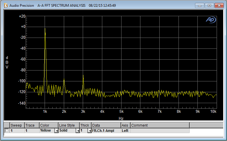

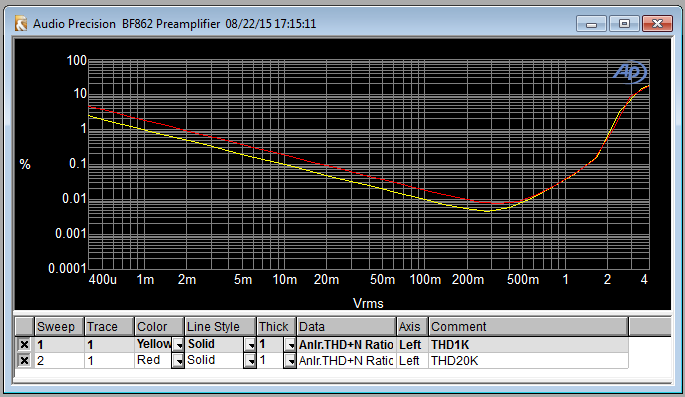

I put one together -- by tweaking the supplies V+ to 22.6 and V- to 6.2, was able to get the THD% down to 0.005% very good indeed!
YMMV -- with the original values the result (2%) was worse than the sim (0.2%). Depending on the gm and Idss of the JFETs other voltages may be optimal.
