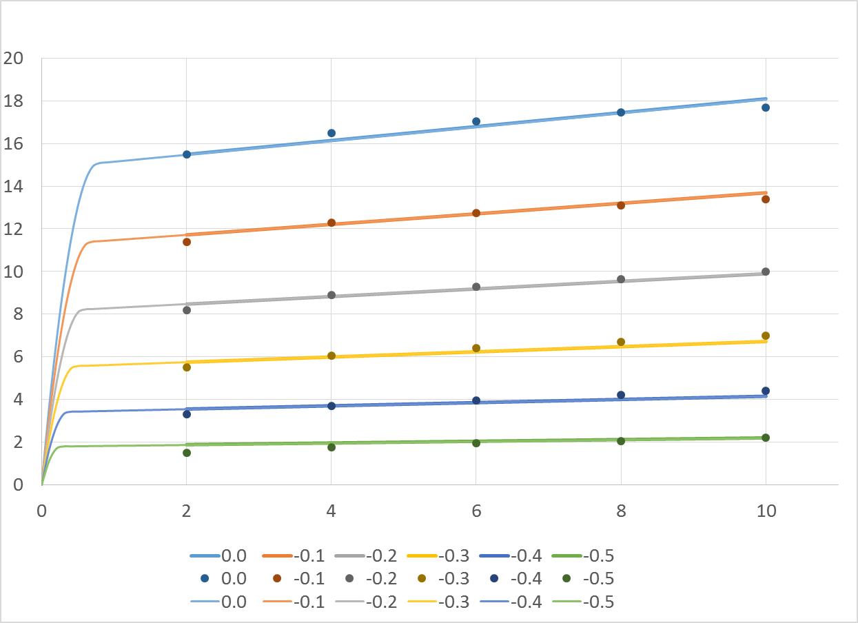

So here is what I did to get a useful SPICE model for the BF862:
I started from the model NXP publish on their website. FWIW, I plugged in the values Mark found for Is, N and Rs when he wore pants again.
Then I took the Id values from Fig 8 of the datasheet at Vgs = 2, 4, 6, 8 and 10V and tried to fit
The numbers I get are
lambda 2.196E-02
VTO -0.7680
Beta 2.516E-02
When I plug these into the spice model and let LTSpice do Fig 8 I get slightly different results. So I fit the above formula to the spice results to get new values for lambda, VTO and beta. I compare these to the ones I got from fitting Eq1 to the datasheet and use the ratios to adjust the parameters. Feeding these into the spice model yields the values I get from my original parameters and Eq1.
The results are all summarised in the attached figure. The dots I read off Fig. 8, the thick lines are fits of (eq1) with the parameters mentioned above, and the thin lines are the results from LTSpice when I plug in
Lambda 2.244E-02
VTO -0.763785
Beta 2.592E-02
These are the values I use from here. A .lib file with the full model follows in the next post.
What they give me is that the model of the preamp circuit I built with the BF862 roughly reproduces the values I measure in vivo.
The parameter values NXP give on their website do not at all.
(Eq1) Id=beta*(1+lambda*Vds)*(Vgs-VTO)^2 The numbers I get are
lambda 2.196E-02
VTO -0.7680
Beta 2.516E-02
![Kennlinie.png Kennlinie.png](https://www.diyaudio.com/community/data/attachments/527/527657-71a9d74a0ae37dc47cf571ea96a5ee4f.jpg)
Lambda 2.244E-02
VTO -0.763785
Beta 2.592E-02

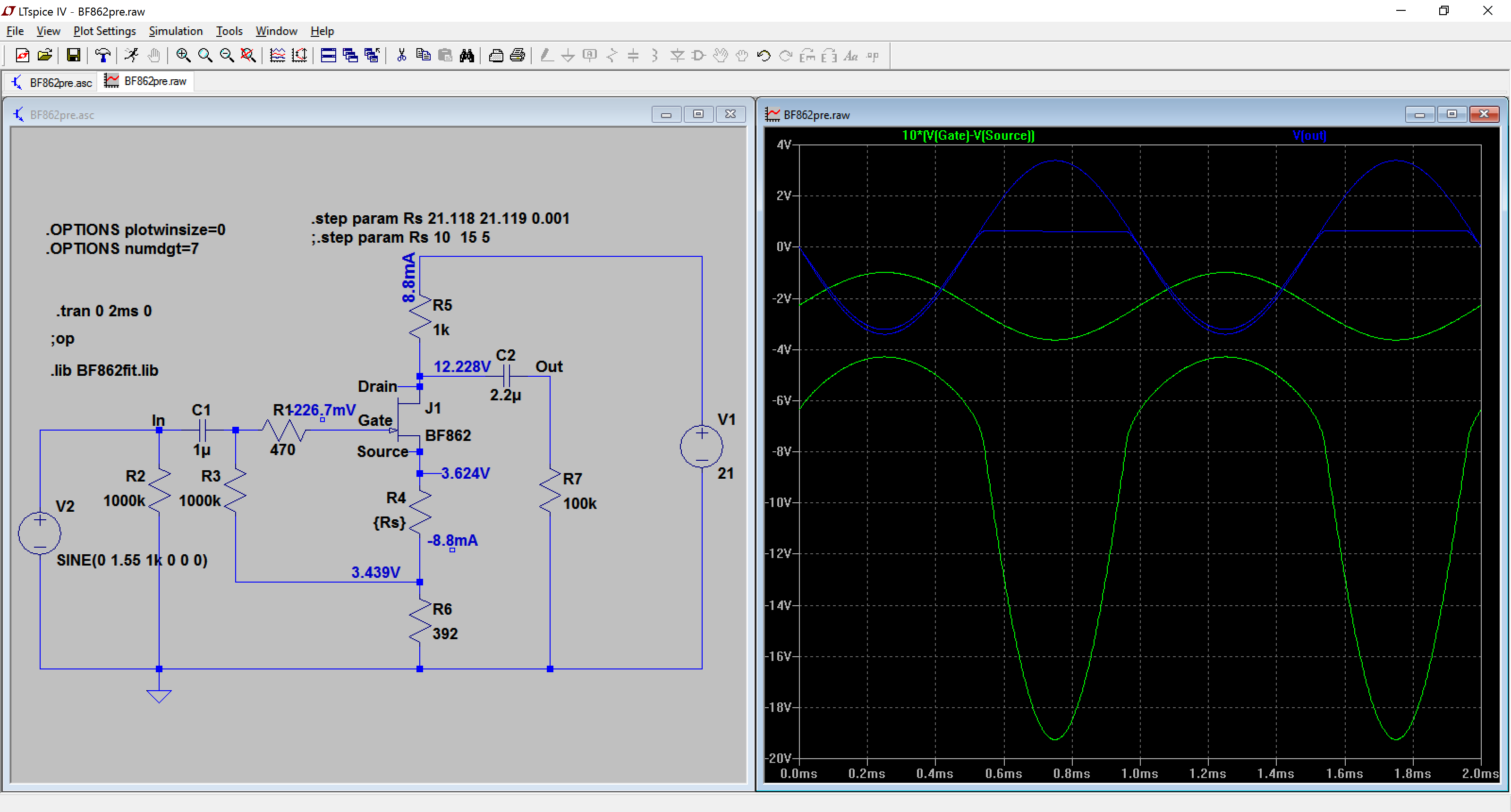

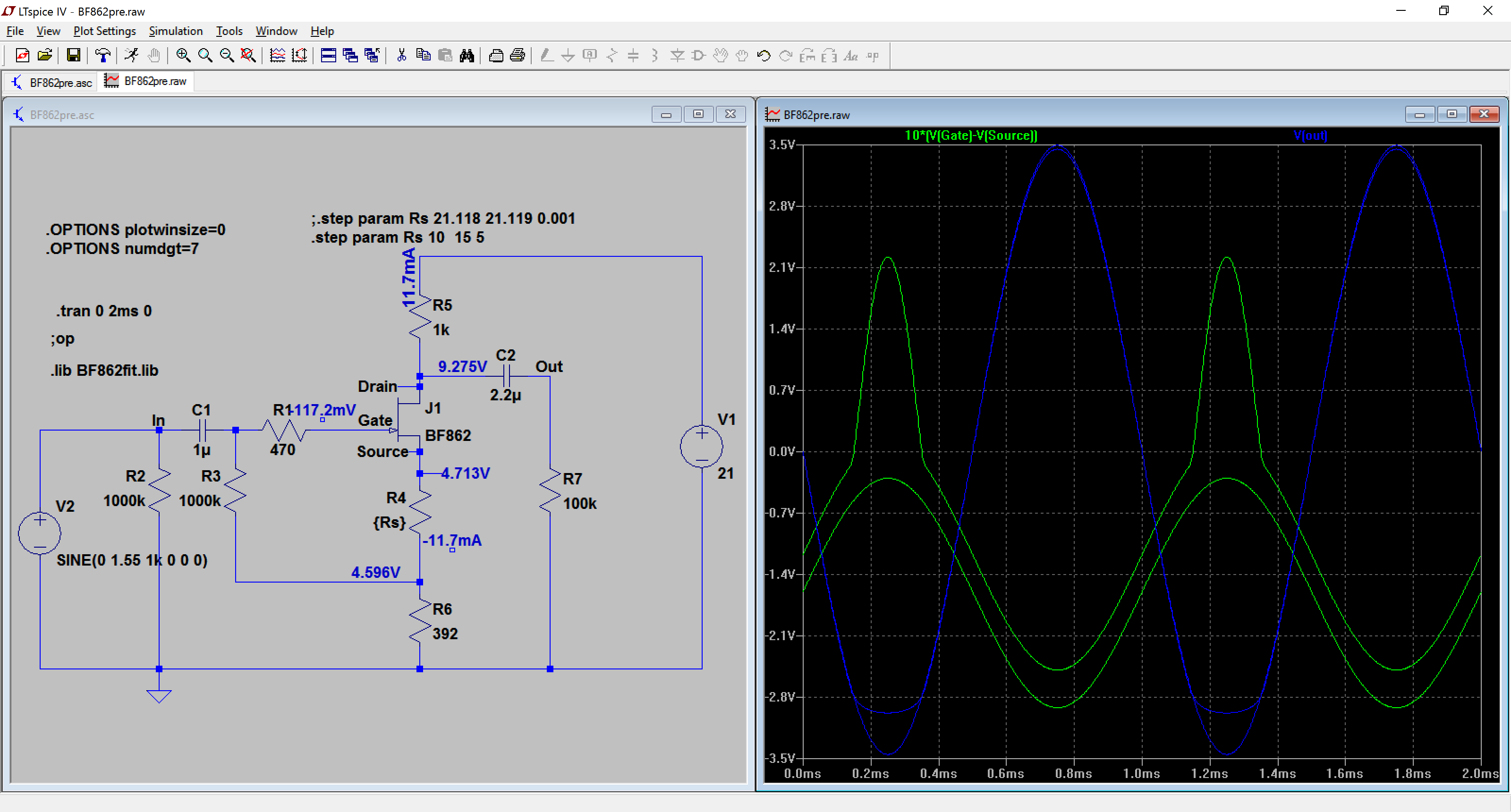

The purpose of the exercise was to address an issue I have with the operating point in my circuit, I believe.
That is, the preamp starts to clip before the M2 behind it does. You can also see this in the simulation screenshot attached, where the jfet suddenly goes into forward bias.
![clipping.png clipping.png](https://www.diyaudio.com/community/data/attachments/527/527695-38820801b0e1b9dc10b28a135ca2f956.jpg)
Playing with the simulation I find that I can avoid clipping by raising the source resistor from 10 to 15 or so Ohms.
Alternatively, I could tamper with the values for the drain and degeneration resistors (R5 and R6 in my schematic).
Question to the pundits, which is the preferable course of action?
And while you are looking at my simulation: Can anyone explain to me what happens for source resistor values between 21.118 and 21.119 Ohms?

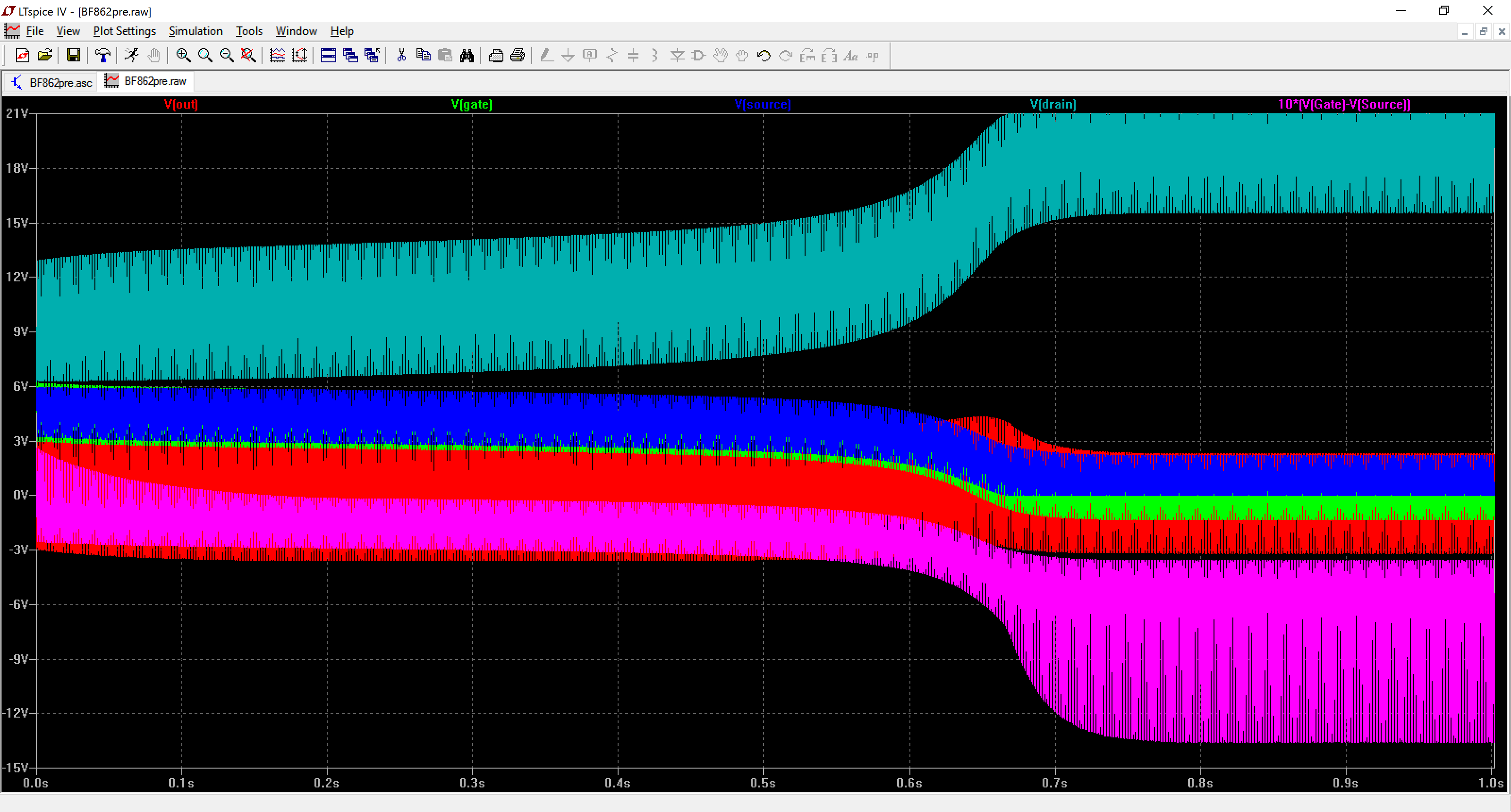

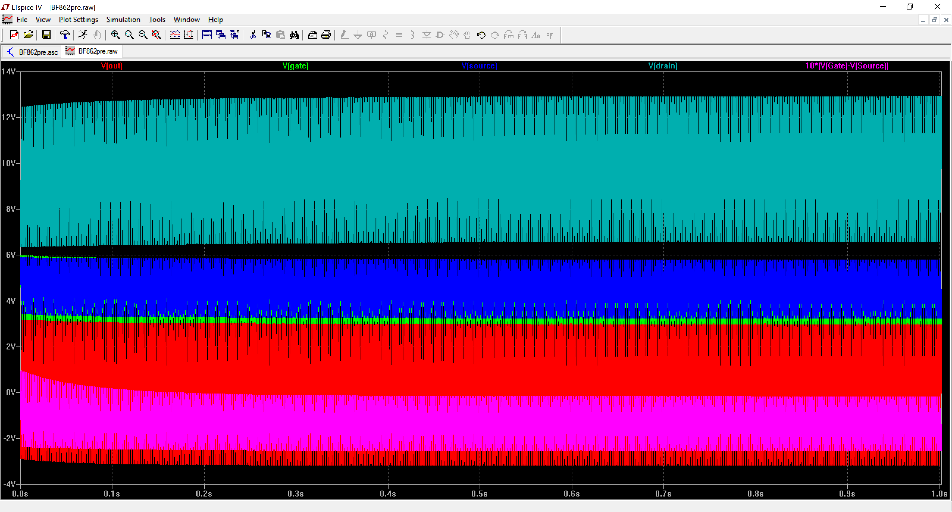

Thanks for the hint, there is some time evolution, but now I see a lot of weird stuff.
E.g. if I use "Skip initial operating point solution" everything settles quite fast, but to a totally different operating point far from reality.
If I leave that box unchecked the evolution is a function of the input amplitude.
Small amplitude, not much happens.
V2 amplitude to 1.6 and the whole thing drifts apart.
I wonder whether I should put any more energy into this simulation or just go back experimenting.
The graphs attached are V2 amplitudes of 1.4 and 1.6.

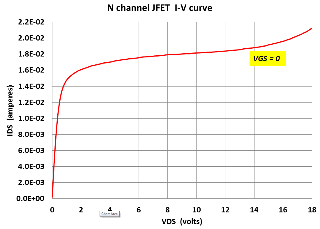

Typical practice is to choose the net drain resistance (drain load resistor || next stage input impedance) such that the trough of a max amplitude sine wave, requires ~ 80% of adjusted_Idss. In other words, when the input signal commands the JFET to conduct the maximum possible current, that current is comfortably less than adjusted_Idss. (in fact it's 80% of adjusted_Idss). Even in the worst case of maximum signal amplitude you'll never get up to Vgs=zero, you'll always have some safety margin.
And what do I mean by adjusted_Idss ?
adjusted_Idss is the value of Idss which you are 100.000% certain, every single one of your JFETs will exceed. Maybe you plan to pre-test and sort out your JFETs, accepting only those units with Idss>10mA. Then adjusted_Idss=9.5mA.
Maybe you will not or cannot pre-test and sort your JFETs. Maybe you are stuck with whatever probability distribution of Idss, that comes from the manufacturer. Then adusted_Idss = 95% of datasheet minimum Idss.
Be sure to double-check your SPICE models, to verify that modeled Idss is less than or equal to the adjusted_Idss you have decided to abide by.
Obviously you can design your circuits however you see fit, you are not obligated to follow typical practice if you have other ideas.

Idss is a function of Vds, but I guess we are talking Idss at lowish Vds, b/c looking at the load line this is where the safety margin needs hold.

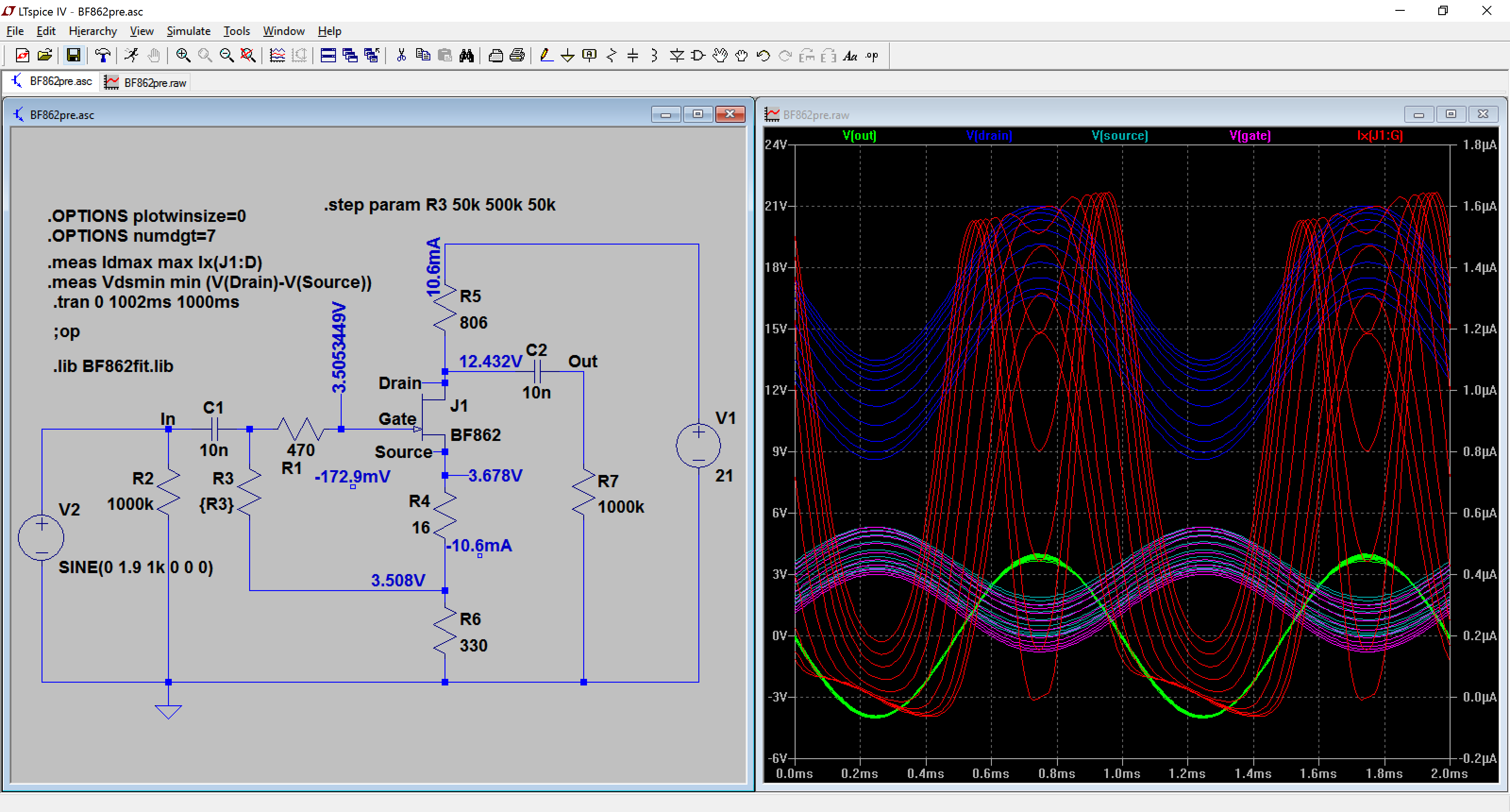

So went back to simulation. The whole contraption is pretty sensitive to the value of R3, the resistor that ties the gate to the bias resistor.
Cycling it from 50k to 500k the gate current (red) has a ball.
With rising values for R3 the gate current develops a dip where the gate voltage has a minimum. At 500k and over the dip tries to go negative, but the simulation clips at zero.
The sim runs for a second, shown here are the last 2ms. For all values of R3 the levels develop in the first 100ms or so.
Gate currents are on the order of 1uA, is this a value that is expected? If not where can I tune the model to remedy this?
For example, you wouldn't want to operate the attached JFET at VDS < 2.0 volts or so, because that's where its measured I-V curve is not flat. Caution, this is not a BF862! It's just a random NJFET I-V curve that I measured a while ago. I have no idea whether your BF862's curves will stop being flat at 2V, or 1V, or 3V, or somewhere else.
The transition is usually defined as to where the gate to drain junction pinches off (same Vp as gate to source). So it's easy to keep track of the sum of the voltages and at Vgs = 0 (Idss) the knee is at Vp. The knee points form a parabola.

I had added the pinch-off points as dotted line in the pdf posted earlier. The characteristics on the data sheet are quite a bit rounder, though. Unfortunately I find it difficult to measure my own curves. Thats why I am looking how other people would dimension their circuits.
Scott,
There are limitations of the standard model with these short channel devices, unfortunately there are no free simulators (that I know of) that support the higher level JFET models unlike LTSPICE's support of higher level bipolar models.

No,.......Idss is a function of Vds,............
Id is a function of Vds, Vgs and temperature.
Idss is a fixed value when Vgs=0, Vds =10V and Tj=25°C

But watch for gate leakage when you do this.
Gate leakage is very dependant on Vds and Tj.
For High Tj and High Vds gate leakage can be 1000 times higher than for conservative operation. Don't go to combined High Vds and High Tj. One or other should be kept low to avoid Ig and the higher one should be respected, not ignored.
