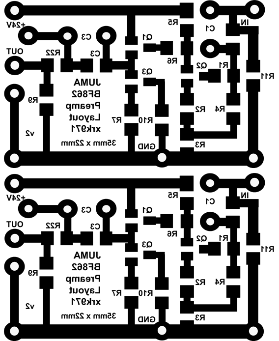

Hi X,please post the PNGI etched them myself - I can post a PNG file for the iron on transfer if you want. No Gerbers available as the layout was hand drawn in PowerPoint![]()
BF862 Preamp Layout v2
Here it is, with some improvements added based on lessons learned with version 1. I added through holes for input film cap, and more holes for connection wires. The external border enclosing the traces (for one channel) should be scaled to 35mm x 23mm. You can check with a ruler and adjust scale on your printer until it works.

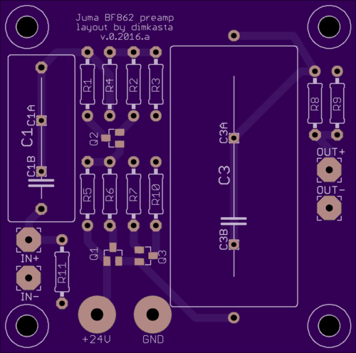

I played a bit on eagle. I will try the preamp at some point. I already have the jfets.
Here is my layout
Untested so far, but I am attaching the eagle files, so feel free to check them and make any changes you want

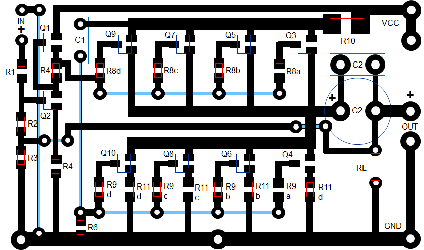

Maybe something like this? 39mm x 64mm:
![586034d1481838813-bf862-preamp-bf862-ha-layout.png](https://www.diyaudio.com/forums/attachments/pass-labs/586034d1481838813-bf862-preamp-bf862-ha-layout.png)
I have never made boards before. I'm sure this is the right place to discover though. I was looking at the Pre-sensitized boards from Parts Express. Would that work? What is the process?
I might start another "Easy Peasy" etching your own PCB's with household materials.
Use laser printer to make transfers onto special paper. Iron on transfer to copper. Etch with muriatic acid and peroxide (or vinegar but slower).
