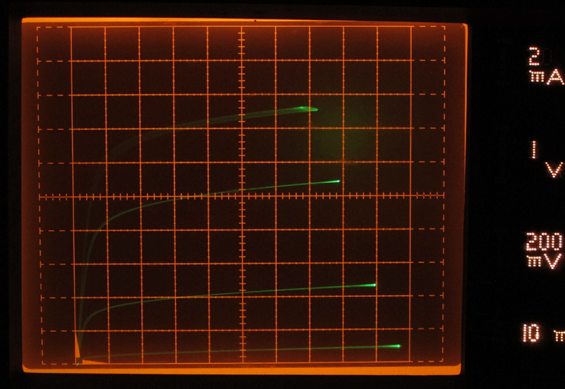

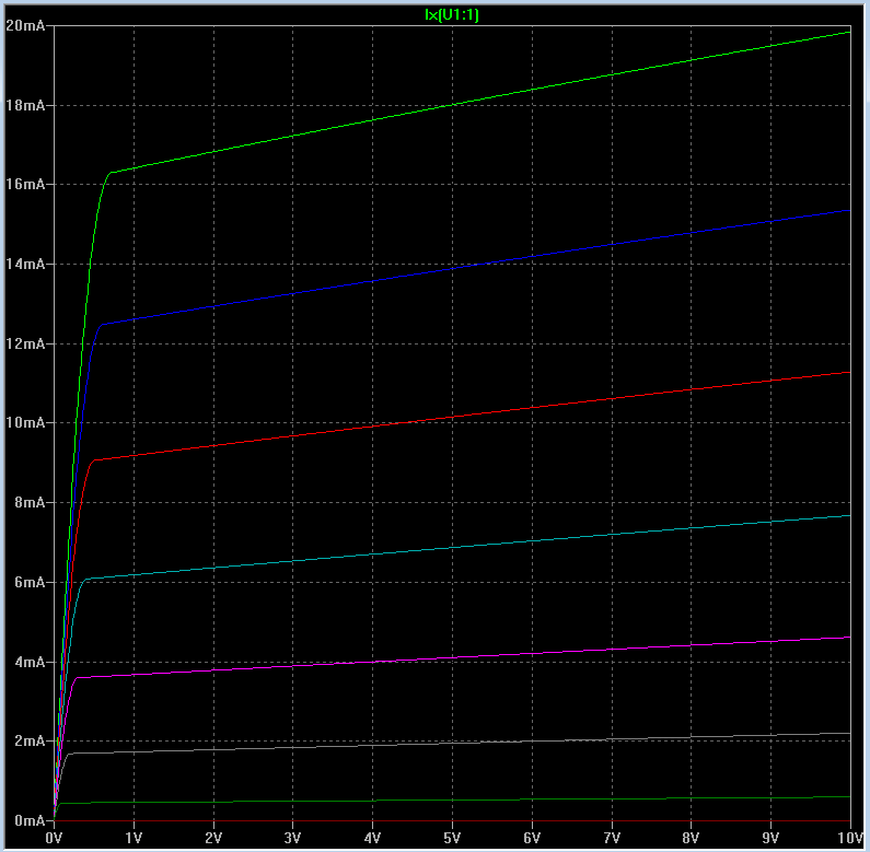

Change VTO in the NXP model from -0.57 to -0.7 and report back (that will get you in the ballpark.) The VI graph in the datasheet checks out well with my curve tracer.

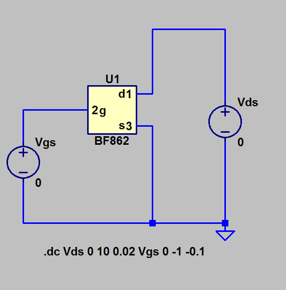

I put it together, ran it, and LTSPICE popped up a helpful error message telling me exactly what was wrong: the resistor "Rg" has an extra character string at the right end of the line. LTSPICE does not recognize this character string. When I deleted the string, I got the results shown below.
_
Just ran the sim - it works correctly - thank you.

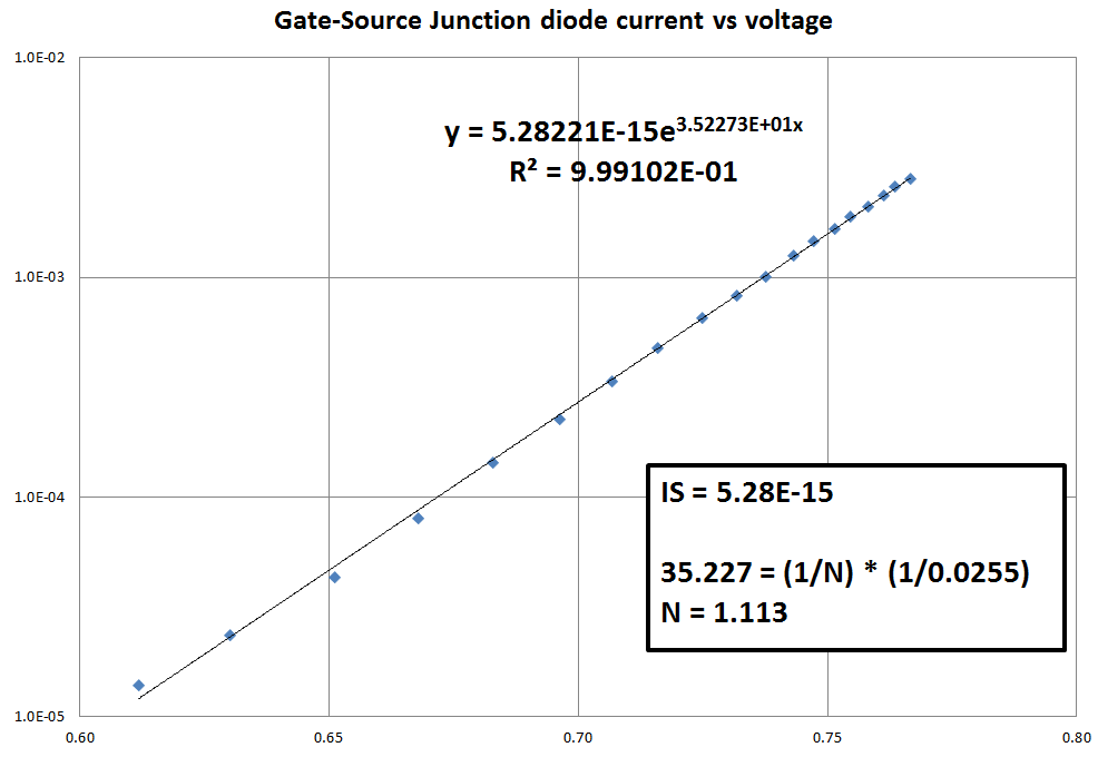

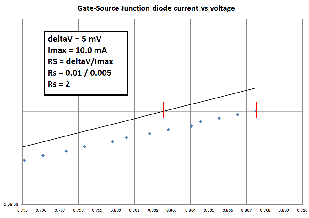

I just measured the forward bias characteristics of the Gate-to-Source junction diode of one single BF862 JFET. It may have been a weirdo freak device but ... this one's measured data is best-fit by the SPICE parameters
IS = 5.3E-15
N = 1.11
RS = 2.0
The NXP model displayed in Post #384 by member Bonsai, says
IS = 4.246E-10 (different by 5 orders of magnitude!!!)
N = 1.0
RS = 0.0
Let the buyer/designer beware

a) isn't a lower gate-source current rather good news for the designer?
b) you got something wrong in the legend of the second graph
Thanks for the catch! Ohm's Law wanted me to calculate series resistance as R=V/I giving (1/2) ohm rather than 2 ohms. Kids let this be a lesson to you, don't perform datafitting in your bathing trunks, late on Sunday afternoon, in the pool cabana sipping a margarita.

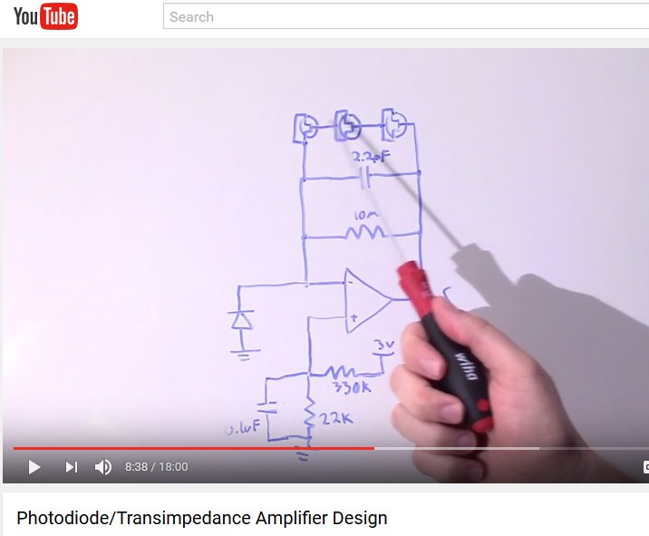

It is indeed good news that the extrapolated zero-bias forward current is so low; lower even than the datasheet's specification VGSoff (1E-9 vs 5E-15), unless you're using the diode as a clamp and want accurate simulation of I vs V in forward bias. Maybe this guy, who's using three of them in series to prevent opamp saturation, might be one such person.
