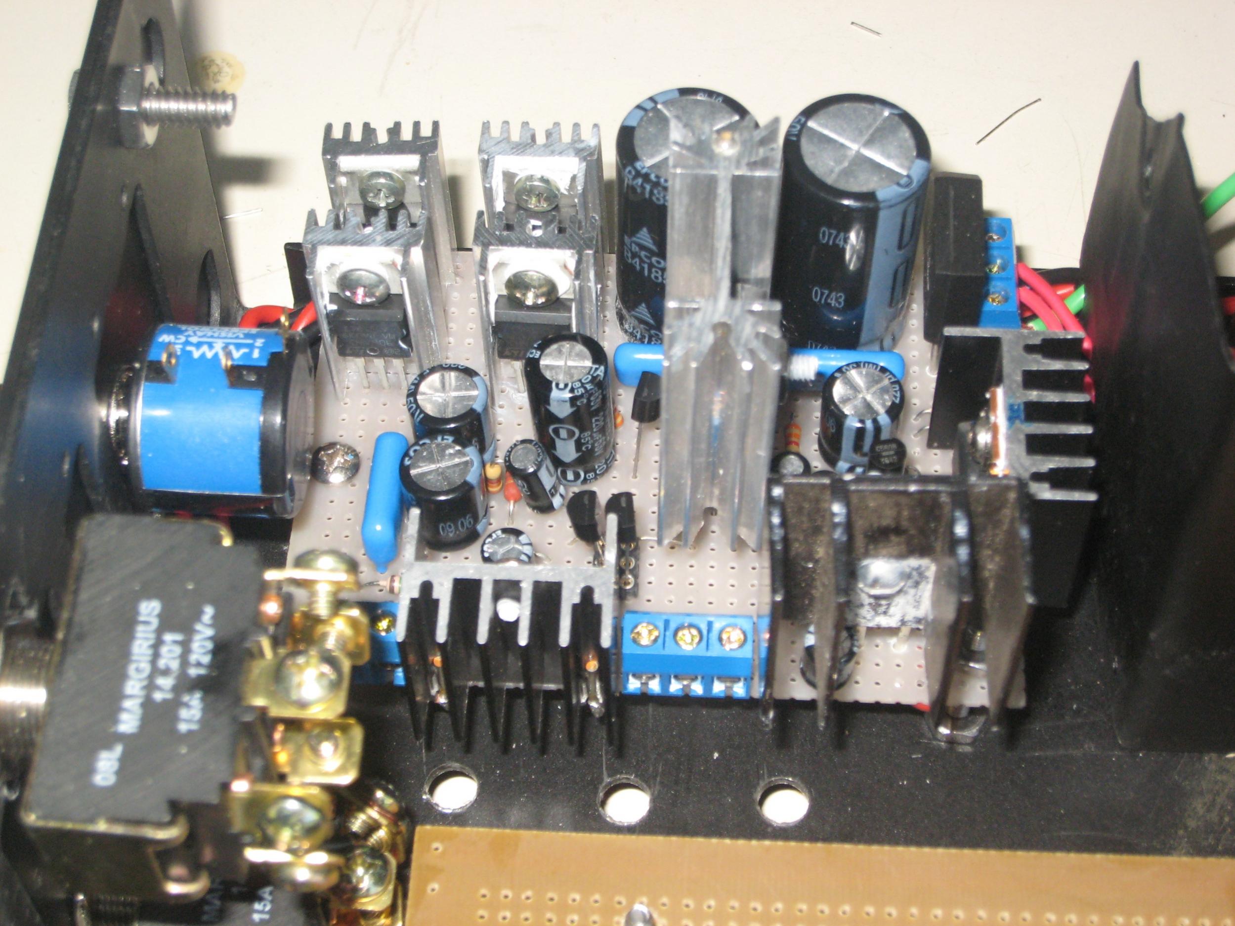

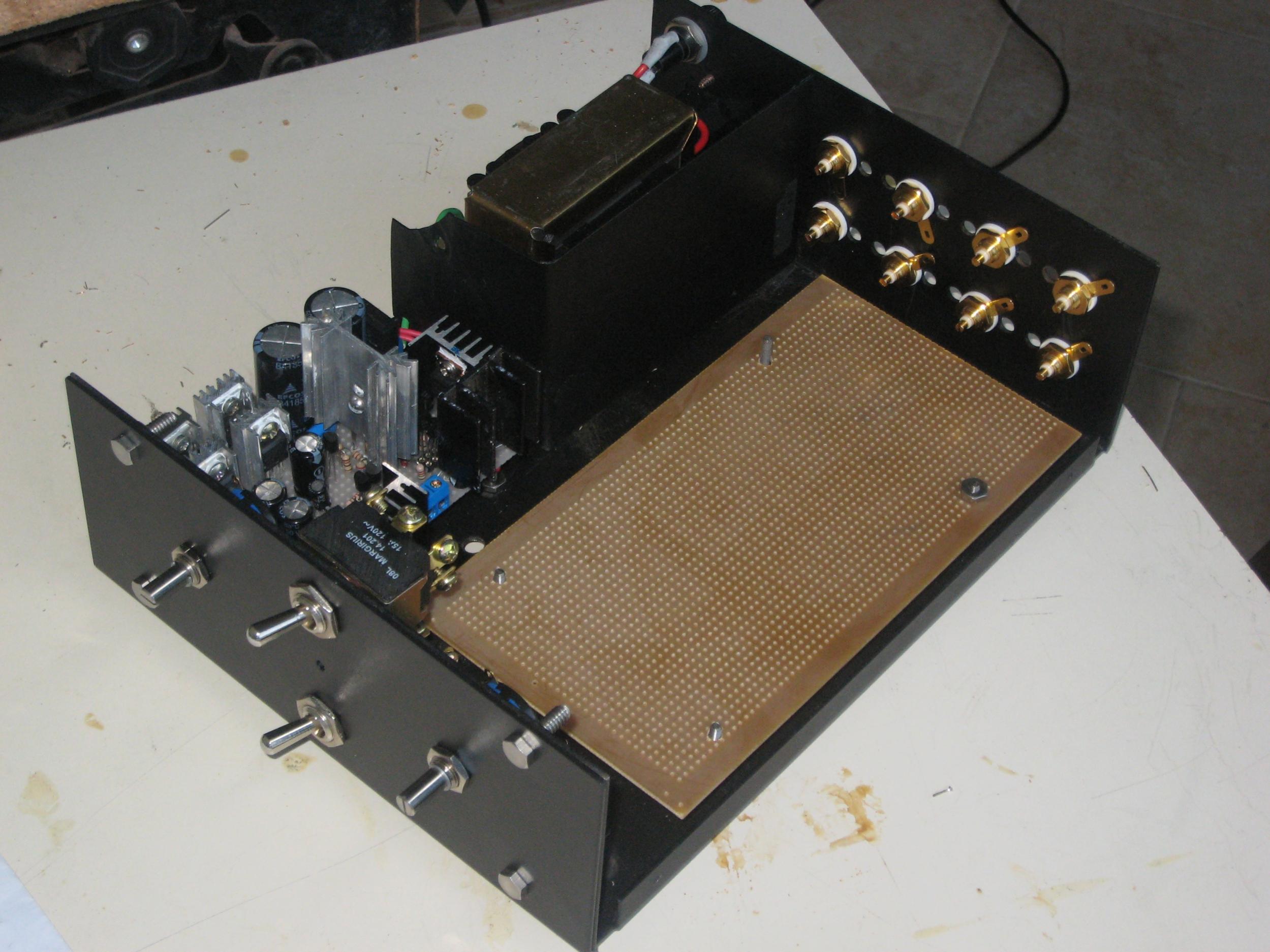

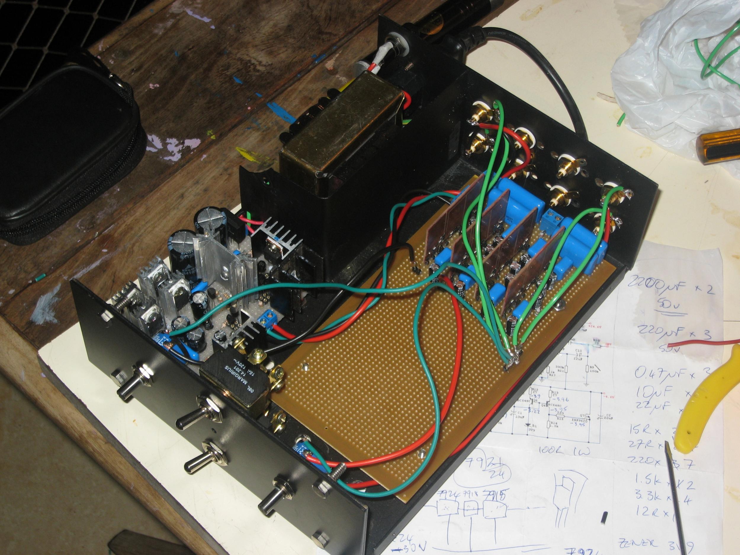

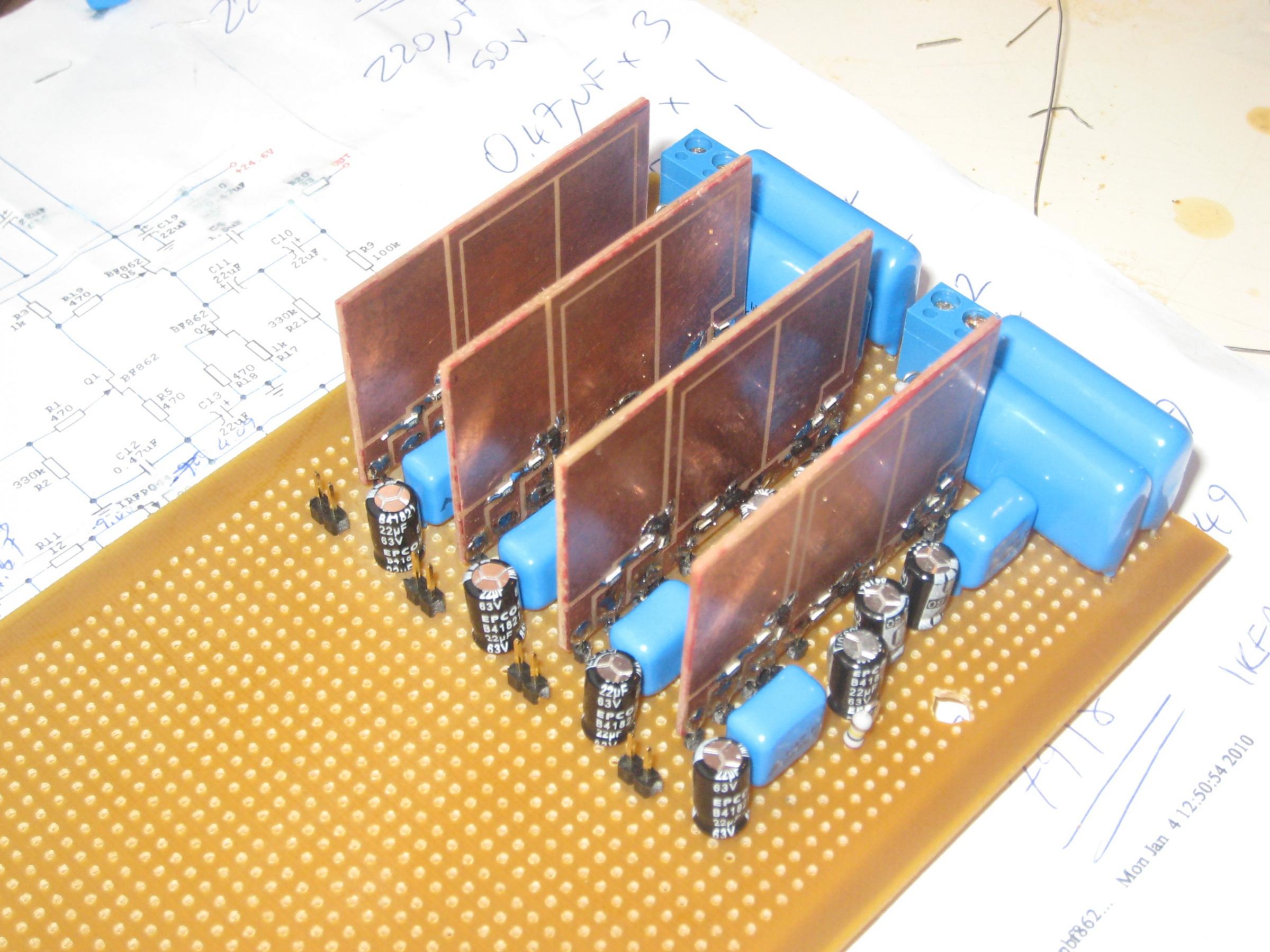

Here are a couple of photos of progress. The big bare board will have all the buffers on it - the idea is to put buffer circuits on PCBs and mount them vertically to help with heat. Since I need a whole bunch of identical buffers this means I can sort of mass-produce them...Power for the filter buffers is a problem still to be completely solved, but the preregulation is handled by the part already done.

Do the heatsinks in the photo I posted look to you like they'll be adequate? The black one in lower right I think is a bit dodgy (it's on the shunt mosfet in the +ve reg, which has to dissipate most power, right?) so I think I'll try to change for something larger. I'm hoping the others are OK.

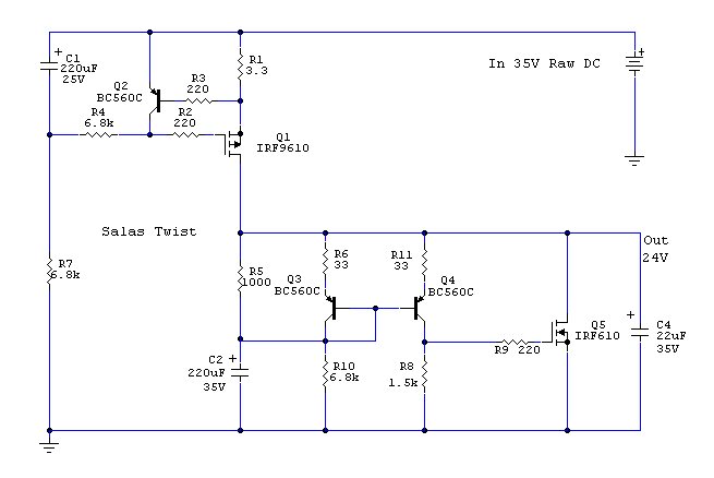

Better use less current mirror shunts than revert to 3 legged general reg chips. There is sufficiently low output impedance in the discrete regs so the interaction between client audio circuits to be adequately low. Try to sub the Zeners with resistors and use larger caps across them. The subjective definition will leap up. Also explore remote sensing. Just an example in the attached picture. R10 can be a mutliturn 10k. That will let you have precise Vout(s) also. Shunt regs were very effective in the DCB1S after using LM317/337 for some reason. Same on even higher PSRR OPA627 line stages after IC regs and after batteries. Maybe its the CCS part in the shunts not moving current dynamically in the lines before the regs, don't know.

Hi Salas,
Thanks for your answer. I'll likely have some questions once I have had a chance to study your circuit a bit, but I wanted to clarify something in case it wasn't clear... The whole project includes 18 buffers; the four output buffers are like the ones on this thread, the other 14 are symmetric buffers in a system of active filters. For the output buffers the PSU will definitely be discrete, since it is already built 🙂 ; the question of using 7809/7909 is for the active filters, which obviously need different regulators, since voltages are different (+/- 9V).. For these the original plan was to adapt your circuit from the symmetrical B1 thread, but current demand is quite high (14 buffers drawing about 13mA each), so my query on another thread started this idea (AndrewT's suggestion) of using 2 or 4 pairs of regs.
(Of course, if allthis was already clear, my apologies...)

use one "global" CCS for several locally situated shunt reg parts
I was wondering about something a little like this, although I'm not sure I know how to do it. I'm going to try and post a schematic later...
or use one global shunt reg for several stages , where each stage have own cap multiplier
I'm sorry ZM, I've used cap mutlipler PSUs before, but I don't understand what you're suggesting here...
Ditto. ''Works like glue'' as Papa would have said. I would prefer the former for output impedance reasons. Gyrators are also good filters but have relatively high and irregular Zout.

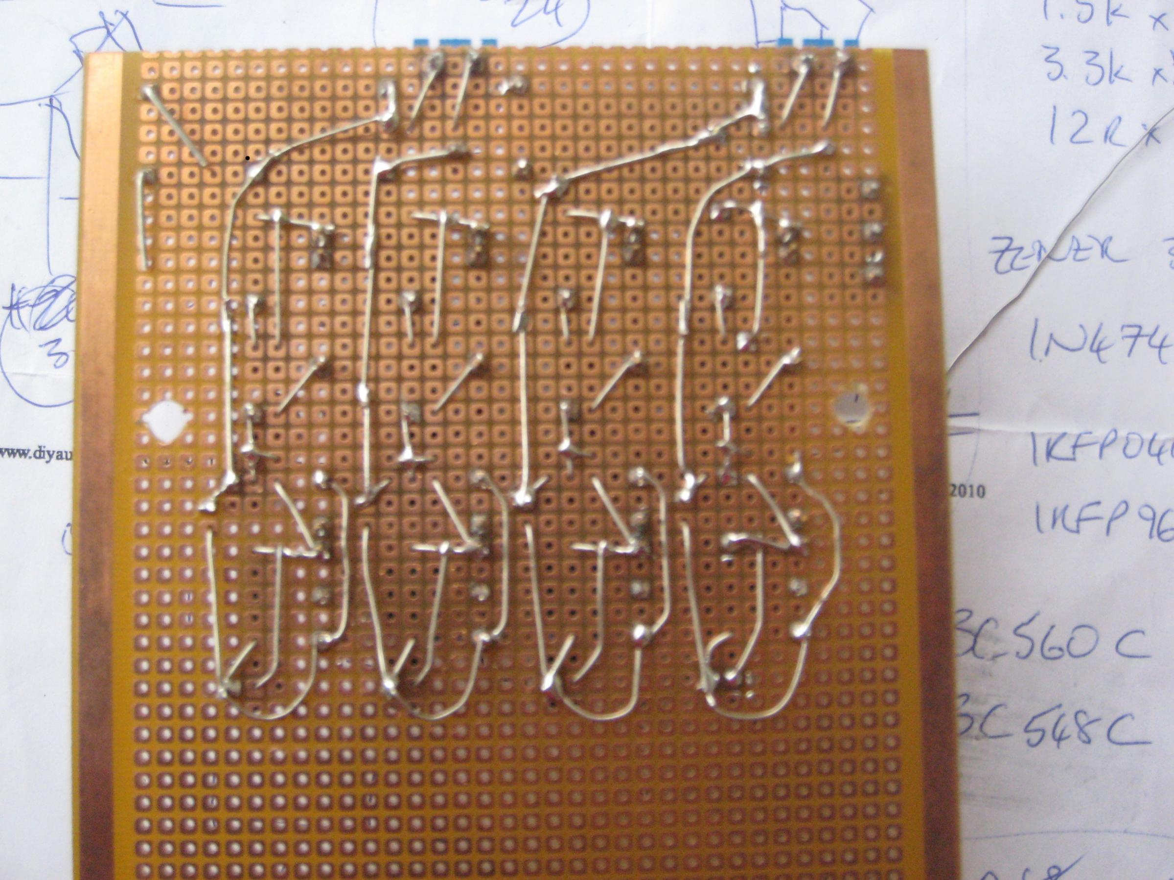

I've taken a couple of afternoons of work this week, as a sort of holiday, and I've spent them soldering.... Things have progressed well: I've attached a few photos that show the four output buffers I need for my project. The four PCBs each contain the three jfets and all surrounding resistors, all SMD, to make one channel ofthis preamp, but with all capacitors on the main board. In the second photo you can see how the four are designed to stand upright (for better heat dissipation - possibly unecessary but can't hurt) and better use of space (definitely an issue with this project). The third photo shows the p2p wiring on the bottom of the main board, although without power and earth connections. The fourth photo shows everything mounted and ready to test two of the output buffers, although all wiring between boards is just temporary.
So I checked for Dc offset and so forth, and there being no problem I connected everything up and hit "play" on John Coltrane's "Blue Train", hoping to hear " veils lifted" and so forth, only to hear instead a thin, distorted, horrible (althouh recognizable) sound... Worse, it's exactly the same on both channels, so (probably) not a bad earth connection or something easy...
I dug around on this and other threads to see if I had made a simple mistake wiring the volume pots or something like that, and checking one of juma's opsts I found the mistake... You can see it for yourself on the first photo, where the source resistor on the middle jfet says "1001".... 😱😱😱: 😡😡😡
Of course, in retrospect I should have checked the schematic in post #23 more thoroughly after juma alerted me to possible problems, so the fault is all mine... and fortunately I have plenty of 10R SMD resistors on hand, but unfortunately (as you can see in the second and fourth photo) to change them is a major "unbuilding" job... Oh well... I know how tomorrow afternoon is going to be spent...

No biggie there, it could happen to anyone 😉
What worries me more is your layout, those big copper surfaces and long traces - I pray it works all right in the end 🙂
It's turning out to be tough to get the pcbs off the main board to change the resistor... I'm considering trying to touch-solder a nornal resistor in parallel, which would look ugly but might be less intrusive than breaking everything apart to get the boards off...
The big copper surfaces are there to help with the heat generated by the gates. (Shouldn't be too bad, but I thought something ought to be done.) The only long trace I'm worried about is the input, all others are nice and short, and in this case the input will have to go through several other buffers before it even gets to these, so I figured it was a small concession to keep eveything else short.
