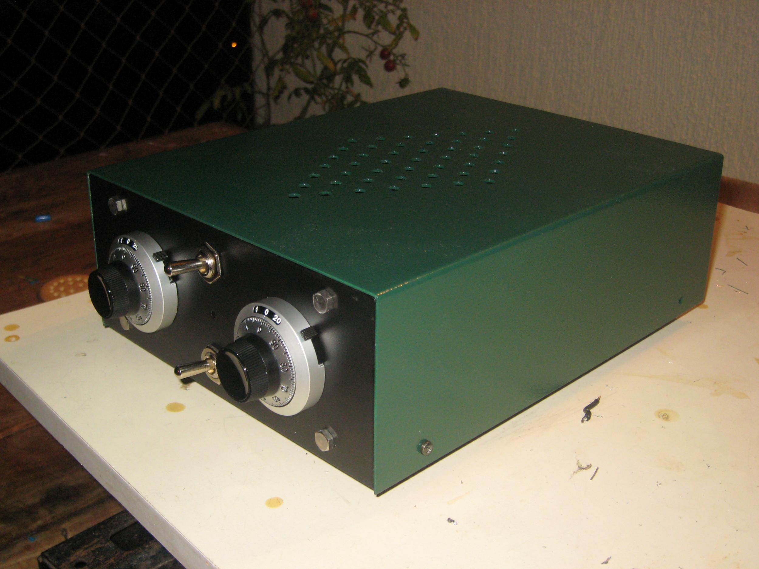

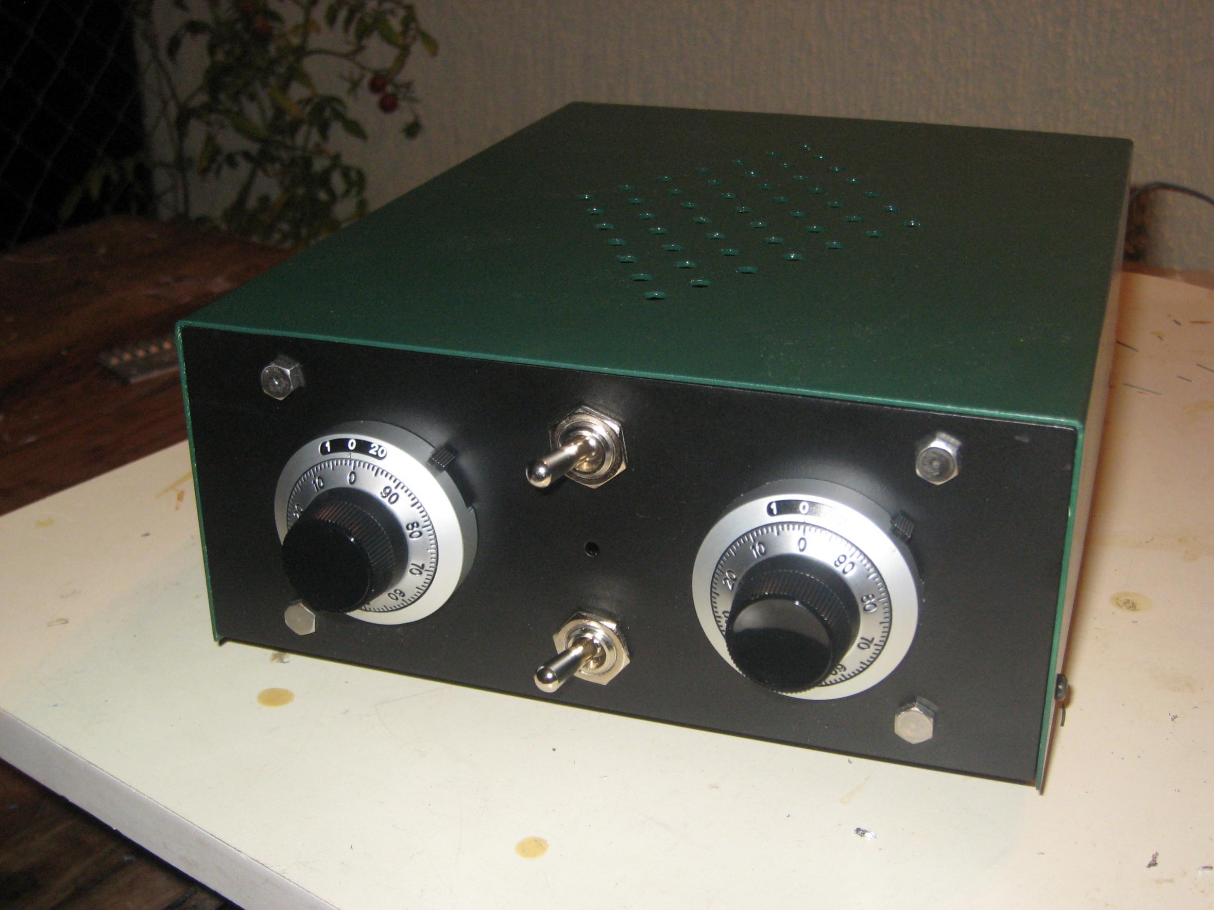

Hi Guys,
Well, at least two out of the four buffers are working - one didn't work when I tested it, but it's probably something simple since two are OK. (I didn't check the fourth yet... I wanted to listen for a while first...)
In the end I managed to get the boards out and switch the 1k for 10R without nasty band-aid type solutions, although it was pretty hard work.... Maybe that'll teach me to check things more thoroughly...
All off-board wiring inside is strictly temporary, just good enough to test whether things work, since it'll all have to be redone after the crossover section is done. Nonetheless, I've been listening to the music I use to check new projects (Artur Pizarro playing Beethoven Piano Sonatas, Elisabeth Schwarzkopf singing Strauss, among other things), and it sounds very good indeed! Right now I'm testing it with the mini-Aleph-J juma helped me with (which is also BF862!); I'll have to wait to try it with the F5 in the living room, which is where it's really intended for.
I've included two photos of the box closed up - I'm using 10-turn wirewounds for left and right volume, hence the complicated knobs. One switch for on/off, the other for choosing between two inputs. The hole in the middle is for a LED to show power, when I get around to it... I've decided there is no reason that hifi equipment has to be black or silver, so I decided to use what in the UK we call "British Racing Green" (probably people from other places don't call it that
) but in the end it looks a little like a piece of army surplus equipment... Oh well... (Next time I'll use fire-engine red...)
As always, any comments on the build are most welcome. I'd be particularly grateful for any suggestions on how to economise space, since I am beginning to think I'll have space problems for the crossover section. (Posts about that stage will be in the corresponding thread on the B1 crossover.)

Hi Guys,
... I've decided there is no reason that hifi equipment has to be black or silver, so I decided to use what in the UK we call "British Racing Green" (probably people from other places don't call it that) but in the end it looks a little like a piece of army surplus equipment... Oh well... (Next time I'll use fire-engine red...)
Absolutely famous all over the world and that will be the colour of my next Aston Martin!
But pls leave red to Italians and our Ferrari! Even if few people know that the "official colour" of Maranello team is yellow. Red was the racing colour for all the Italian cars, as well as white (and later silver) for the German ones, blue for French, etc.
