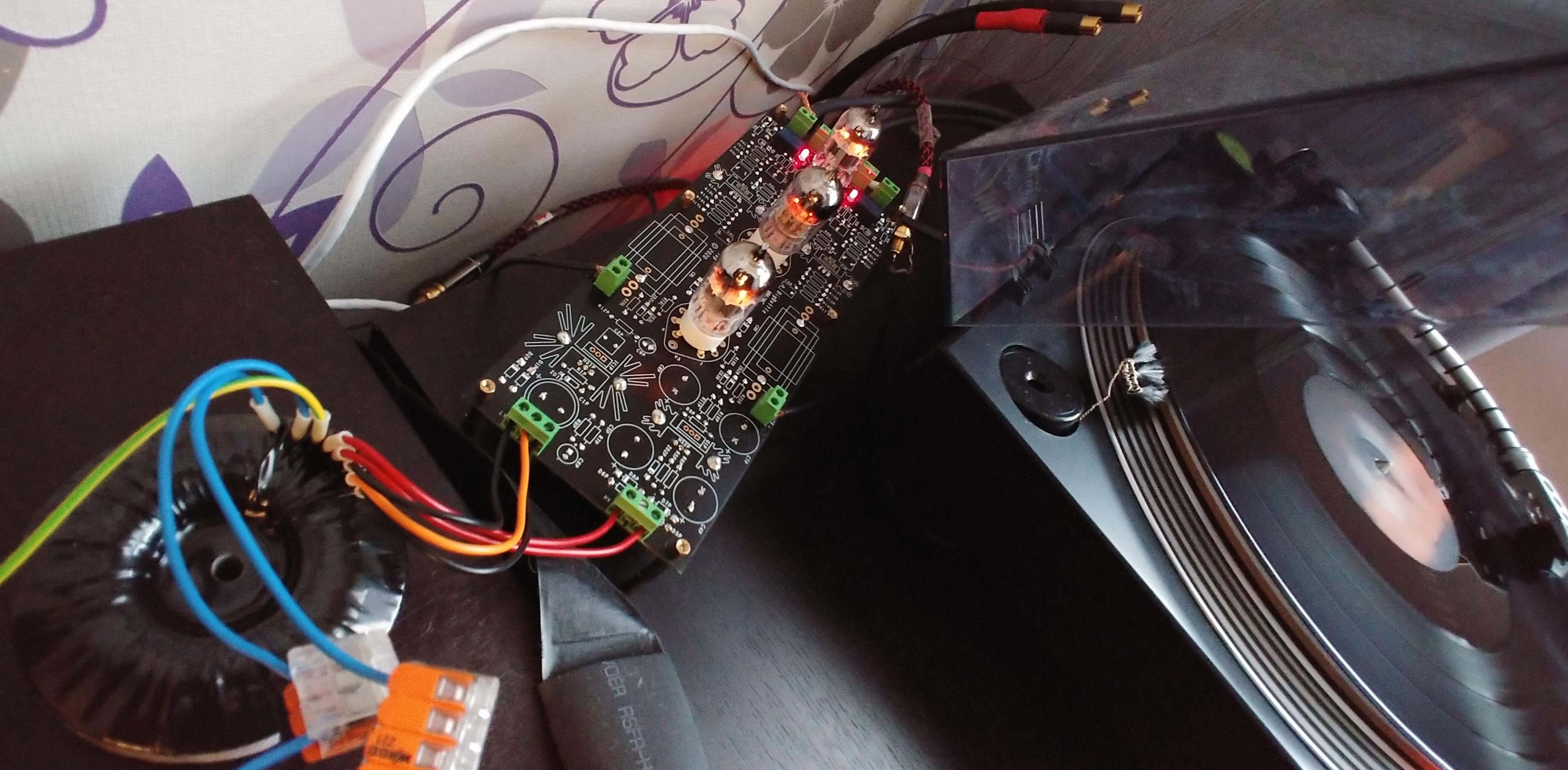

No resistance between yellow/green and blue ones.Check resistance between yellow/green and blue ones - yellow/green to blue and yellow/green to the other blue , just to be certain
Thanks, it worked. Connected the board and measured the voltages without tubes. They are very wrong, actually same as mentioned by Marra:You can safely connect 230V to blue and blue
I wonder, if solution was found.I have connected the L/V side of things and my unloaded heater voltages across pins 4 and 5 are 6.49v. With the valves in place the heaters glow and the voltage drops below 6.3 volts. Using 6DJ8's with Craigs suggested mod.
With the H/V connected I have the following readings all measured to ground :- V1 pin 1 135.2V pin 2/3/7/8 0V pin 6 135.2V
V2 :- pin 1 149.9v pins 2/3/7/8 0v pin 6 150.2v
V3:- pin 1 236.3v pin 2 17.25v pin 3 16.69v pin 6 236.3v pin 7 17.17v pin 8 16.67v. I forgot to say the led's do not light up.

Thanks, put tubes on and they light up. Will check more tomorrow!Hi Neilsek, without tubes fitted those voltages are correct.

With valves in my voltages seemed to be within range and I had nice sound for a few LP's. Developed a fault so is being for sent for sorting.
