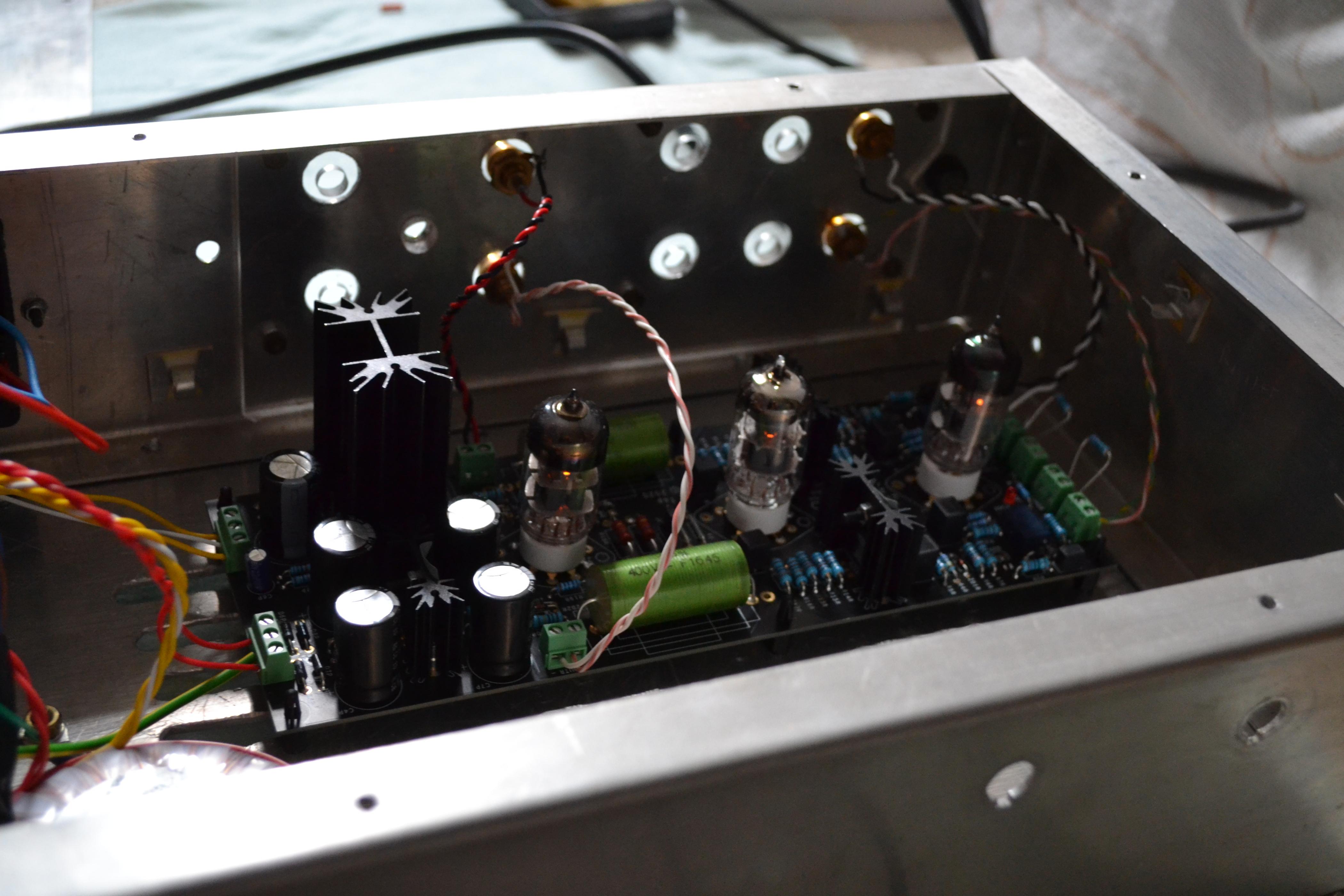

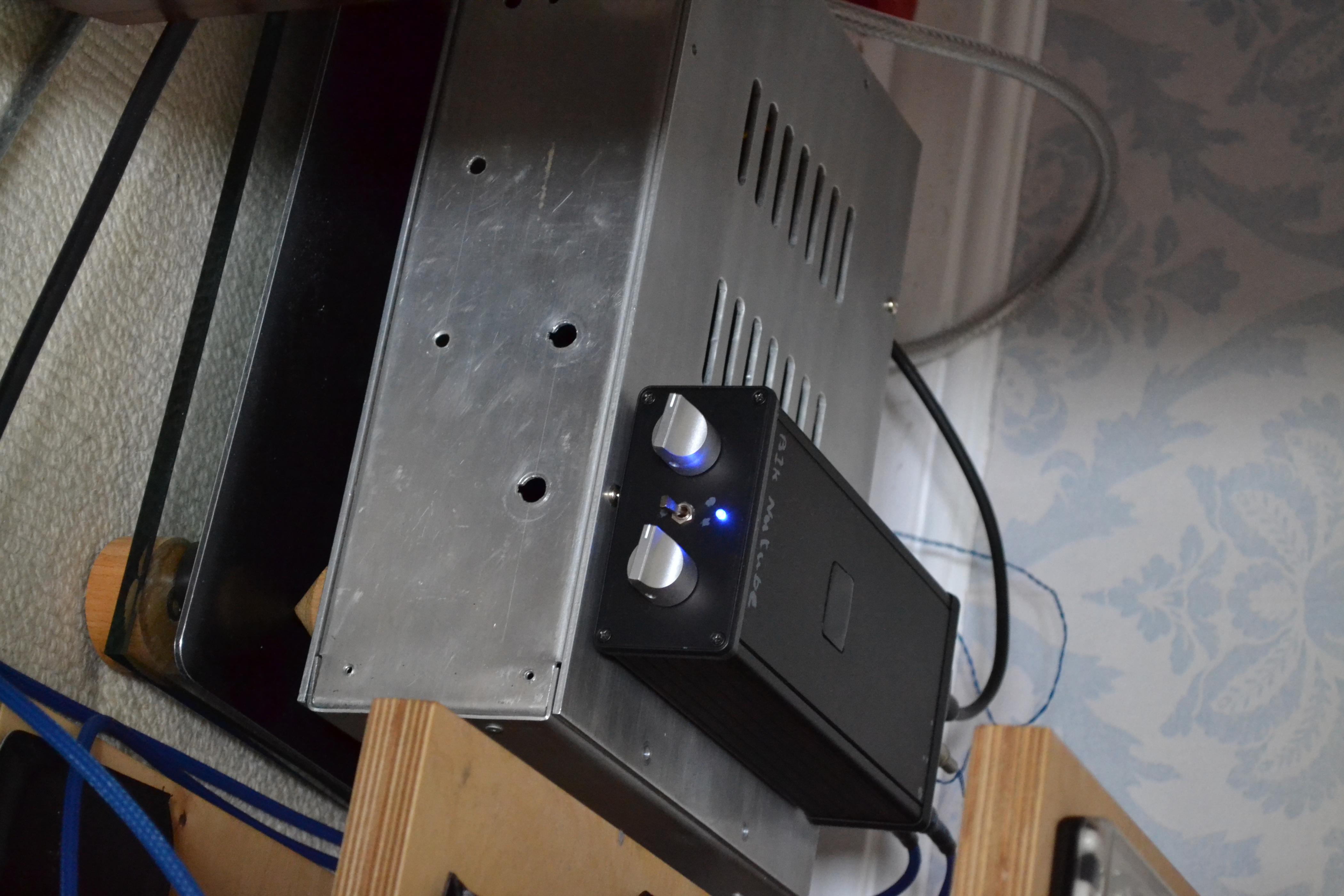

Though I would show my build, with exposed valves on the top of the case.
Using heatsinks I had in the spares draw, the heater regulator will be bolted to the underside of the top panel to act as heatsink.
The transformer isn't exactly to spec, again it is to hand, so there is a bridge rectifier fitted for the heater supply.
So all components fitted to the 'back' apart from valve bases, fets and relays, plus the heater reg once moved.
The case was chosen to not be too bulky, so it is a nice snug fit.
Had to figure out how to connect the input sockets and MM/MC switch with short wires, so ended up with extended wires from the transformer so the base could be removed to give access.
Rear view.
Lastly in situ in use.

![dJpdagX.jpg](https://i.imgur.com/dJpdagX.jpg)
![1krmNe2.jpg](https://i.imgur.com/1krmNe2.jpg)
![0NjuXqi.jpg](https://i.imgur.com/0NjuXqi.jpg)
Rear view.
![DuGX4Tq.jpg](https://i.imgur.com/DuGX4Tq.jpg)
![k3hs49S.jpg](https://i.imgur.com/k3hs49S.jpg)

Nice! What case is that?
Rear view.
Had to search for your question in the middle of the post.
Case is WA77 All aluminum amplifier chassis / Preamplifier case / AMP Enclosure /DIY box (215 *70*272mm)|Amplifier| - AliExpress
One says top, one says bottomIt seems as the pcp have screem print on both sides,is there a side that is top and bottom.. or is just to pick one side.
Is one side mirror of the other?
For exposed valves, populate the bottom.
For enclosed valves, everything goes on top

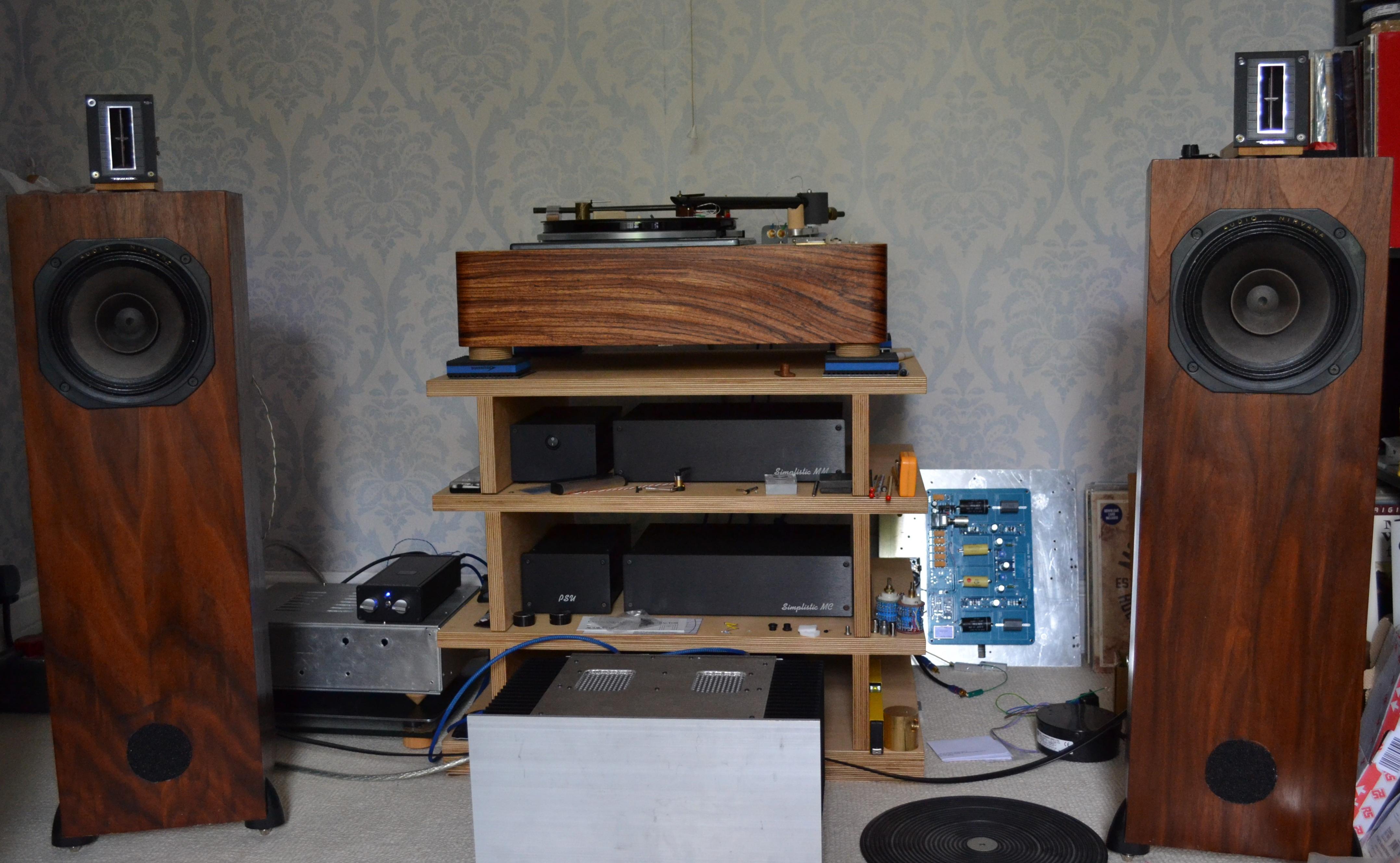

My BB3 board arrived back after being fettled (big thank you to Alan) so I fitted it back into it's temporary case and wired it up. Now in place in the test system and sounding pretty good. For those like me using ECC88's with 6.3v heaters it's worth fitting a taller heatsink on the regulator. Hopefully I will get a longer listen tomorrow. A couple of pics.
![DSC_0946 (2).jpg DSC_0946 (2).jpg](https://www.diyaudio.com/community/data/attachments/771/771461-95f757b3fe113f027dc6bdfe9a1fc104.jpg)
![DSC_0942.jpg DSC_0942.jpg](https://www.diyaudio.com/community/data/attachments/771/771432-573da9b543c2d3a0f166e55d6eb97c90.jpg)
![DSC_0944.jpg DSC_0944.jpg](https://www.diyaudio.com/community/data/attachments/771/771447-c0212a45dec2baf9b90cb91cb41d56a0.jpg)
Fantastic....My BB3 board arrived back after being fettled (big thank you to Alan) so I fitted it back into it's temporary case and wired it up. Now in place in the test system and sounding pretty good. For those like me using ECC88's with 6.3v heaters it's worth fitting a taller heatsink on the regulator. Hopefully I will get a longer listen tomorrow. A couple of pics.
Good to see ot up and running. Easy fix too I believe?
What was the cause of your problem ? Overheating ?
Dry joint somewhere I think?What was the cause of your problem ? Overheating ?
