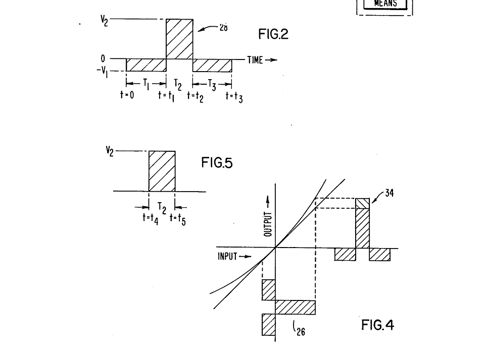

john curl said:Hirata distortion measures something different than THD. You can actually lower THD and INCREASE Hirata distortion. I don't even understand the mechanism completely, BUT I have measured it.
Hi John,
The Hirata distortion measurement technique has always fascinated me, but I have never implemented it. How did you implement your Hirata distortion measurements?
Thanks,
Bob

Bob,
Some time ago, I tried myself to do some Hirata measurements (on some opamp based gain stages), using a MC1455 timer and MAX303 switches http://datasheets.maxim-ic.com/en/ds/MAX301-MAX305.pdf to generate a test signal from a dual DC power supply (I tried all four waveforms), multiturn pots as attenuators, and a HP3478A 5 1/2 digit multimeter to measure the output. I haven't played much though, as I concluded that the sensitivity is quite low. Almost anything better than a LM301 opamp gain stage showed nonlinearities buried in the noise.
Certainly only breadboarding the thing had an impact on the circuit performance, for sure a finished instrument would do much better. However, I am still skeptical regarding the resolution and sensitivity of this method, at least for power amps. I also find Hiraga's statement "It was found that high-quality amplifiers with a total harmonic distortion of 0.01-0.001% show a nonlinear distortion of more than 0.04%" at least confusing, as no correlation with the THD numbers is provided.
It could be a very good tool for evaluating speakers, though. I haven't tried this so far.
