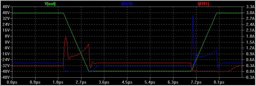

OK.... the quest for the perfect driver stage continues with unexpected results.......
I really haven’t got time to analyse the circuit operation now, but a quick sim revels that, under fast slewing conditions, a BJT driver suffers from cut-off operation also, even so the the MOSFETs did it cleaner and more abruptly - particularly so due to the rise of Vgs of one MOSFET pulling up the bias source and switching the other one off.
So, it is looking like there is more than one mechanism at play here, causing device cut off, and MOSFET drivers may very well not be out of the race yet.
If anyone else finds this topic sufficiently interesting to investigate further than what I have so far, the basic LTspice *.asc file for the monster 20 BJT pair output stage is attached. I'd appreciate any feedback.
Andy C's RET models are used.

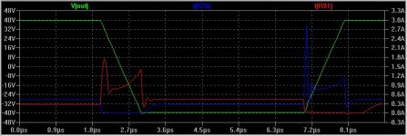

Attached it the results of the quick sim. The green trace is the output waveform, the OPS being driven with a 80Vp-p squarewave slewing at 80V/us.
The red and blue traces are the collector currents for each driver transistor. As can be seen, during the positive and negative excursions of the squarewave, the driver transistors are being alternately cut-off.
Without putting too much though into the circuit operation before finishing this post and taking my schnitzels of the stove, I tentatively put the problem down to the competing NPN and PNP output transistor base currents being drawn through the 5 ohm biasing resistor between the driver transistor bases.
Glen
Glen

Right. I'm just working through the best options and analysing the pro's and con's of both BJT and MOSFET drivers. I put my results up here to further discussion on the topic, but as usual it just raises the usual dismissive objections.
WRT to the rise in Vgs cutting the other off, I agree that if a MOSFET with a sufficiently high transconductance is used and the peak current demands are not too great, then it should not occur. We can of course pick hypothetical operating figures to prove that this is the case.
However, in my sims I was using Lateral Mosfets which exhibit a much larger rise in Vgs for a given rise in Id and my peak drive currents are a lot greater than 2.5A. My front end slews approximately 200V/us. Here the peak current well exceeds 2.5A.
Under these conditions, the rise in Vgs does indeed force cut-off operation of the other device. Vertical MOSFETs would be a better option here and I would have run a sim by now if I could stop LTspice from continually crashing each time I try to run the VMOS models Edmond sent me.
Whether or not the forced cut-off of the MOSFET driver under adverse slewing conditions due to the rise in Vgs really matters is another matter for debate, but it is actually nice to have a thorough understanding of the driver circuit operation and understand what is going on – and the mechanism is something to factor into the design and device selection. At least with a BJT driver it is one mechanism one doesn’t have to worry about.
Now what would be really interesting is if someone could actually put forward some ideas further to the LTspice sim file I have provided towards designing a very high current driver, either bipolar or MOSFET that doesn’t cut-off under fast slewing conditions.
If one runs that *.asc file provided in by second to last post, one can see for themselves that a speed up capacitor between the driver emitter/source leads does next to nothing to improve the situation at these drive currents, the only simple fix being to run an impractically high driver bias current (amps).
Hi Glen,
It is not true that one does not have to worry about cutoff of a BJT driver on the side going through turn-off.
While this usually is not a problem under low-frequency conditions, it is one of the defining problems under high-frequency, high-level conditions, whether the output stage is a MOSFET or a BJT. Having adequate ability to suck charge out of the output device(s) that is turning off is critical. In most cases, this will be the defining criteria. If you put enough standing current in the driver to always have enough current to turn off quickly enough the output devices, the problem you mention will not usually happen.
This issue is usually a function of the rate of change of the output current, rather than the output voltage. It is usually worse for BJT's.
It is true that YMMV in the use of the speedup capacitor.
Bob

Yes, I clearly confirmed that the BJT drivers suffer from cut off also in posts 2811 and 2812. It is the rise in Vgs of a low transconductance MOSFET that I said is one mechanism contributing to device cut off that one doesn't have to worry about when using BJT drivers.
Also, as stated in my last post, I agree that passing a large enough standing current in the driver solves the cut off problem (my LTspice attached sim demonstrates this - post 2811).
Just run it with the 5 ohm driver biasing resistor reduced in value to an ohm or less to put the bias current at ~1.5A.
Then cut off is avoided at 80V/us slewing, but a ~1.5A driver bias is totally impractical, and it is still not good enough for 200V/uS slewing.
