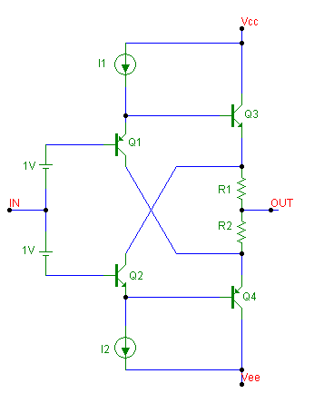

Do you think that also the harmless looking circuit below might have stability issues?

It depends where and how it is used.
Inside a feedback loop there could be issues, as I can confirm I have
used this circuit myself and other variations of it.
Another more stable variation is join the collectors Q1/Q2 together
and from this point connect a damping resistor to 'out'. This will
resistively isolate collectors of Q1/2 from emitter of Q3/4 which
can be a good thing.![nod :nod: :nod:](https://files.diyaudio.com/forums/images/smilies/nod.gif)
Yes, the connection scheme I described will loose some VCE on Q1/2
but usually Q1/2 in these configurations are run at very low currents
so it is not a big issue.
However as you have drawn, the simple stand alone follower should
be fine depending on bias current and load (reactive?).

Edmond Stuart said:
Hi Terry,

I've used a version of this with some success. It is the circuit that made me concerned about the capacitance of the Baker clamp diodes, as the Ccb capacitance of the transistors loading the VAS in this circuit is largely bootstrapped out. In some cases I've put zeners in the emitters of the input pairs to get the desired amount of bias spread, and tied the input bases together. This makes a good circuit to drive the HEC circuit I use.
Bob
Bob
