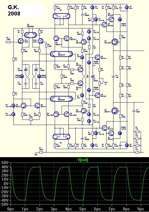

Also, now slightly off topic , after a gazillion design changes and flip-flops I have now actually finalised the design of my amp, deciding to forgo TMC, EC and all that fancy stuff (not the 1kW class A amp, which is another project). I have decided to just put my 12W amp topology with its 1k load resistor “crippled VAS” on steroids as an exercise to see just how good I can make it.
Shown below is an almost finished drawing of the input stage circuit board. With the compensation optimised for a 1MHz unity loop gain frequency, the front end simulates ~700ppb THD-20 driving 80Vp-p with an ideal output stage, and passes a 500kHz full amplitude squarewave as shown below

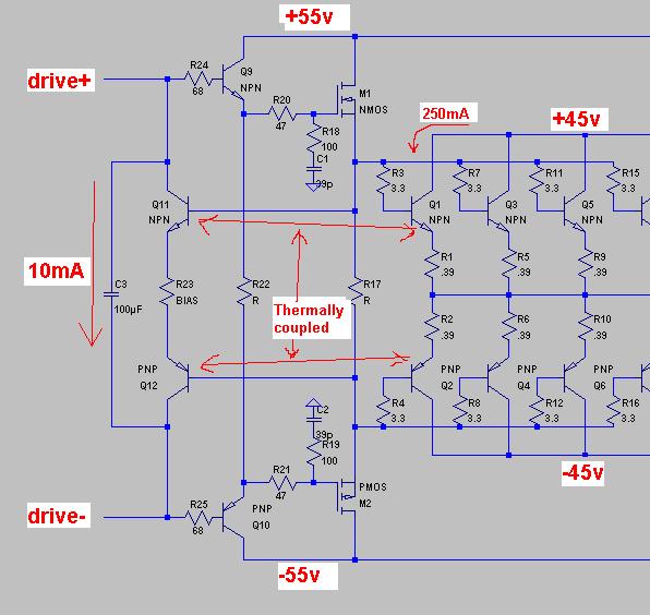

G.Kleinschmidt said:OK, here is what I have come up with for a VMOS driver. Nice and simple. The 20 pairs of output transistors run a bias current of 250mA each for 5A total bias.
Comments?

WRT MOS driver, yes I can see for driving 20 x OP BJT's it is a
very good option.
Question - Glen, why so much bias current? Why not concentrate on
the real challenge of ultra linear class AB? Much more fun than this
apparent overkill and waste.
T

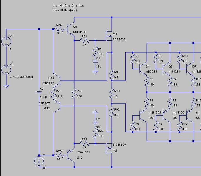

The idea is looking good so far, except that I had to add a pair of resistors (R91 and R91 in the pic attached) to compensate for the higher Vbe (about 100mV) of the small signal bias-spreader/temperature compensating transistors over the power output devices.
Also, Andy and Edmond, I've been too stupid so far to figure out how to get your modified 2SK1530/2SJ201 models working in LTspice. I keep getting error messages.

I think I may have found a possible mechanism for Nelsons complaint about MOSFET drivers for BJT's.
But before I get to that:
R91 and R92 (as described in my previous post) fixes one problem, but worsens another. When slewing at only 80V/uS the peak base current of the 20 output pairs peaks at 3A (mostly due to input capacitance of the BJT's).
The voltage developed across R91 and R92 by this base current, combined with the rise in Vgs for the MOSFETs, forces the driver stage to operate in class AB.
Now:
I can get rid of R91 and R92 and implement a more elaborate bias spreader circuit to compensate for the higher Vbe of the bias spreader feedback transistors, but that still doesn't get around the problem of the rise in Vgs of the MOSFETs, which will always force class AB operation of the MOSFET driver under fast slewing operation.
Referring to my previously attached schematic, the voltage developed across R19 is only small - a little higher than two Vbe junction drops. Once this voltage of approximately 1.4V is exceeded by the rise in Vgs for the MOSFET doing the driving at the time, the other will be cut off.
I hope I explained that clearly. I'm pretty sure it's right
This seems to me to be a major disadvantage of using MOSFET drivers for high power bipolar transistors output stages, and pretty much rules out the use of any simple bias spreader circuit if class A operation of the driver stage is desired under all operating conditions.

AndrewT said:how does using BJT as a driver solve this ClassAB drive?
Easy - Unlike Vgs, Vbe doesn't have a delta >1.4V.
So, despite the fact that one driver BJT at any instant may be conducting huge peak base currents for its half of the output devices, the other driver transistor will never actually be forced into cut off.
