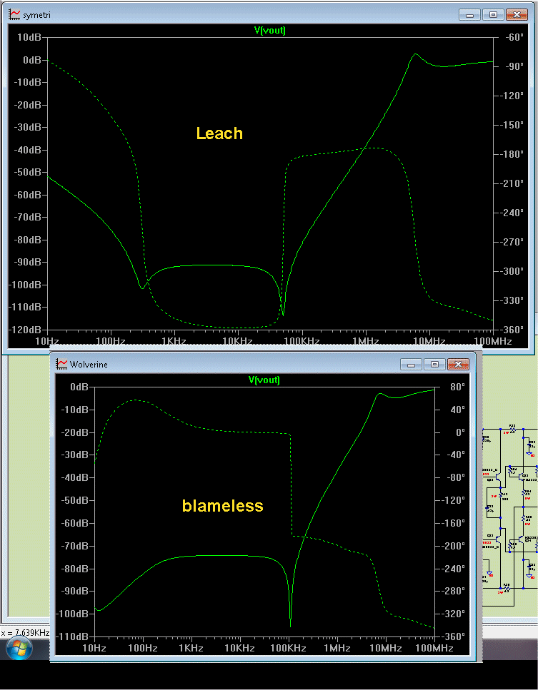

Lets just see ....
I never directly compared the "blameless" to other designs in any manner other
than raw THD.
(Below 1) is PSSR. The blameless's CCS/filter versus the cancellation (+ccs's) of the "leach".
Blameless has better LF PSSR but the Leach is a bit better in the audio band.
A draw ?? Throw both behind a capacitance multiplier , both are >-110db (audio
band).

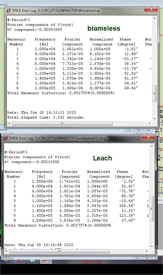

(below 2) is THD20 ... look at that , another "draw" !! EF3 as output stage ,
blameless without TMC. The lines have "blurred" , performance wise.
Offset might have to adjusted for the leach by adjusting it's two current sources ,
the only drawback.

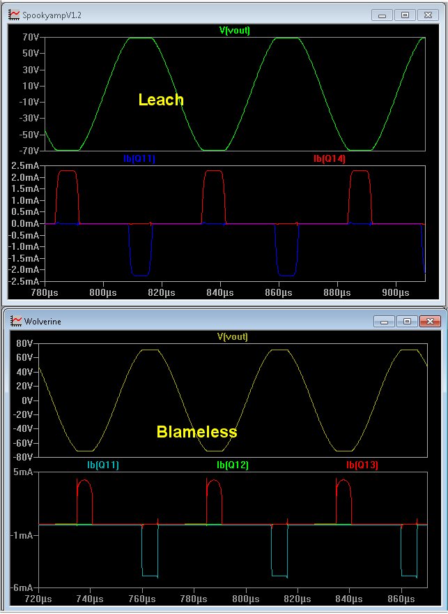

(below 3) - clipping. Active clamp (bc550) on the darlington (blameless) -
Leach has it's native Hawksford cascode. Thing do look a bit "nastier" on the blameless. I'm sure 5ma saturation won't kill the bird , but 2.3ma is way better.
Some symmetric cascoded VAS's "self clamp" (baxandall) and have NO
saturation and a rounded waveform.
For the hell of it - I destroyed a tweeter with a blameless while the cascode
did not do this. No way around this. BTW - the VAS CCS also saturates
on the blameless. At least the saturation is symmetric. 😀

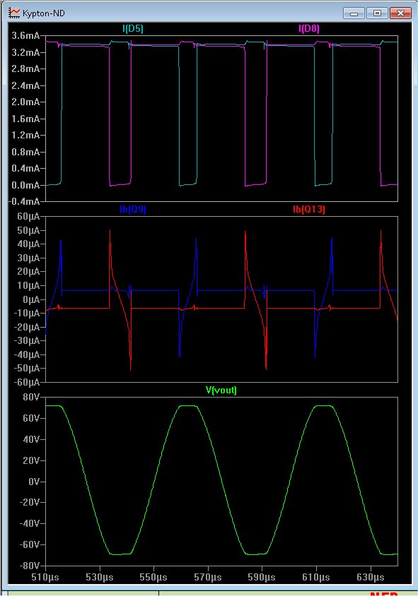

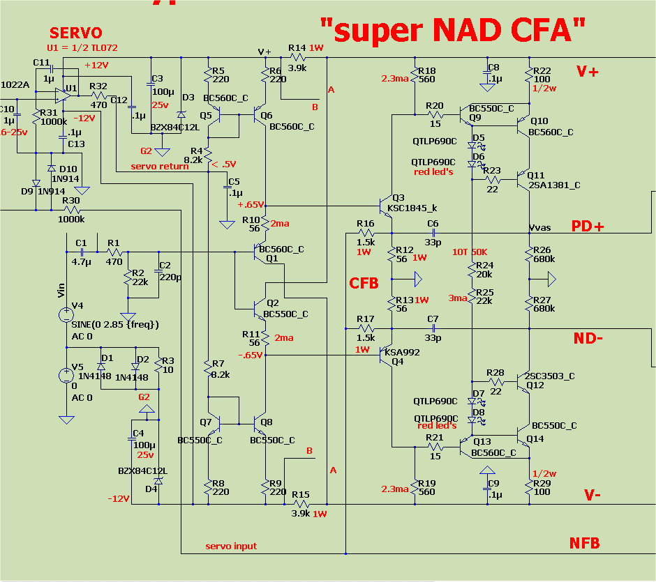

Look at the blameless clipping compared to the Baxandall hybrid -
(below 1). It does not saturate (at all).
And that design (below2 ) , is <10ppm 20K. OMG - it's a CFA !
It also sounds great , can be abused eternally - but it is a CFA.
It might have useless 250V/us slewrate and slightly poorer PSRR .
But we filter the rails a little , it's other attributes are stellar.
PS - I really don't believe >100V slew rate is a big factor , but
the impedance variations "transmitted" back to the FB node might
affect SQ.

members CFA project at .002% THD20K/8R , similar to my CFA ....
I'm sure all (the symmetrical ips's) will be close.
OS
If I am right that you speak about my amp then I have to add some explanation.
The amp was measured with the workshop power supply and long temporary connected wires. With the amp in proper chassis with proper power supply and proper wiring THD should be much lower.
