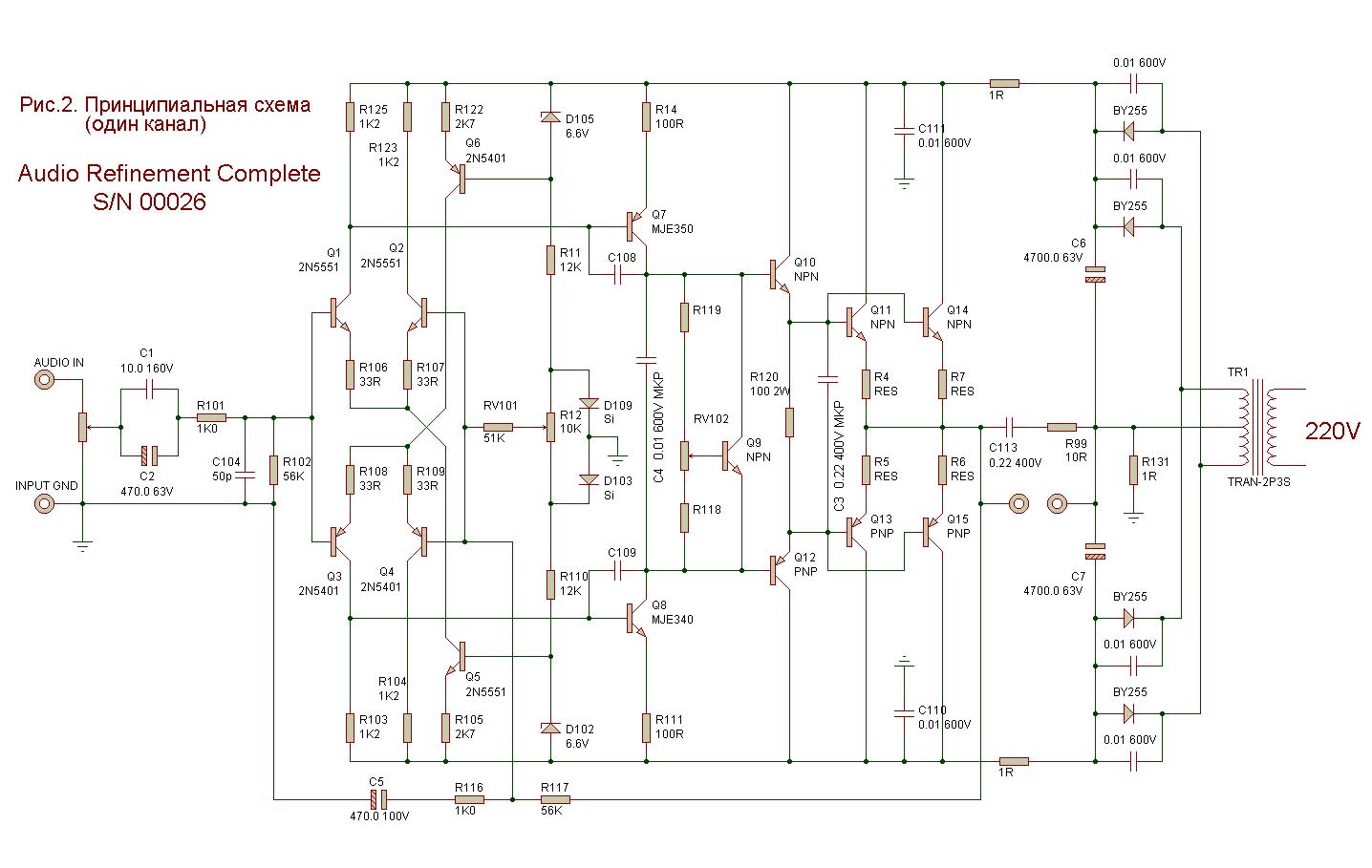

Can you post the schematic of the YBA please?
My Holy Grail is to achieve 1pp zillion THD with very simple circuits. My prejudice is that this will give good sound cos it is amenable to rigorous analysis, testing and there is less to go wrong.
You will be very disappointed, the distortion is going to be high. Only 33ohm degeneration resistor, no cascode on LTP, no darlington VAS and 2EF. That's the hallmark of a cheap amp.
To me, distortion means nothing. It's the sound. I don't care to even debate tube or SS. It's the sound and that's the only thing that matter.

Then there is the "YAP" amp - The YAP Output Stage
This was my "ground zero" inspiration for the badger and especially the
slewmaster. Separate OPS/IPS - then the "PGP" amp with EC @ 1/2ppm 20K
uses rail stars and a central ground star - Schematics
Real good stuff - and really measures good , too !
