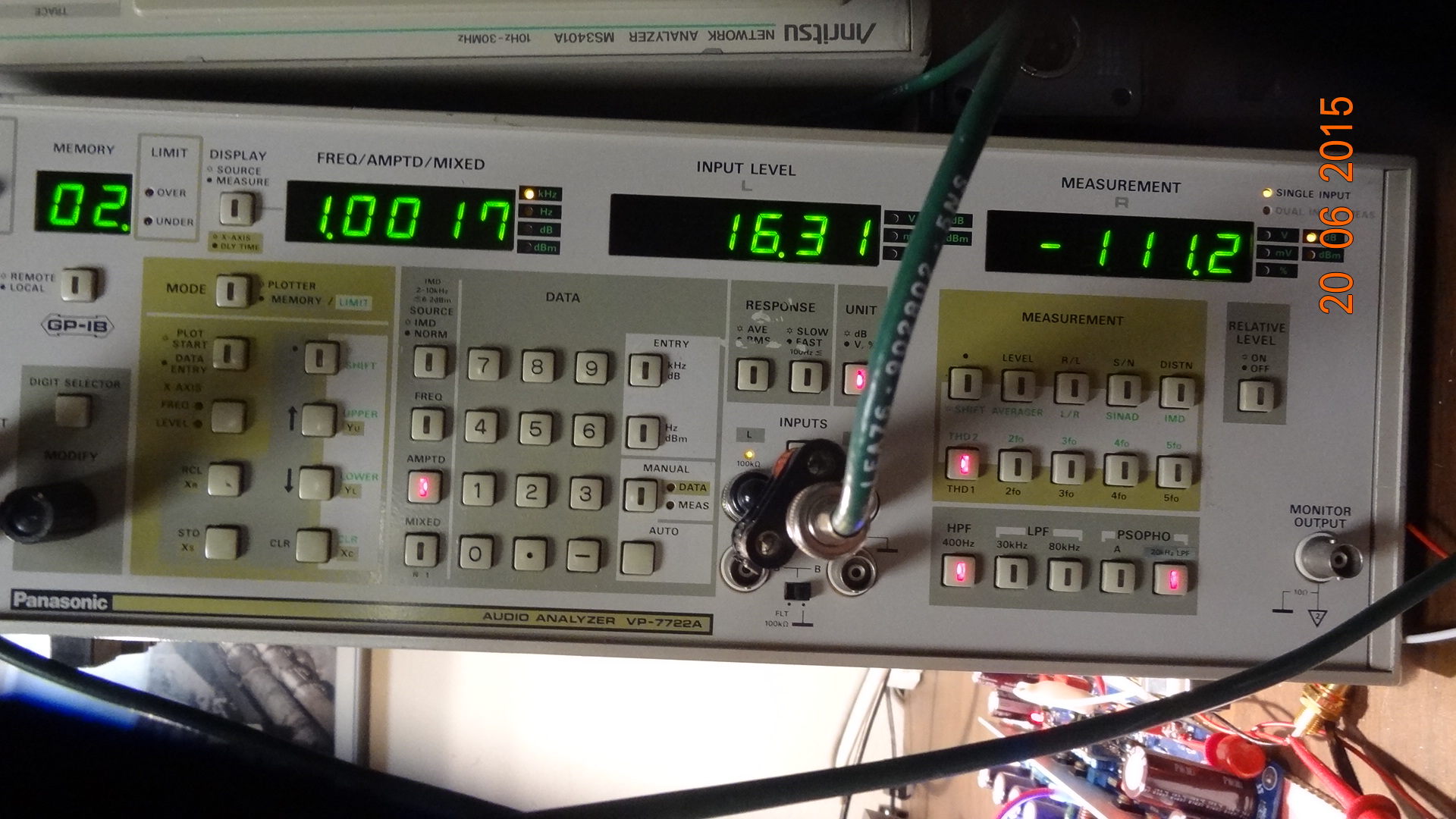

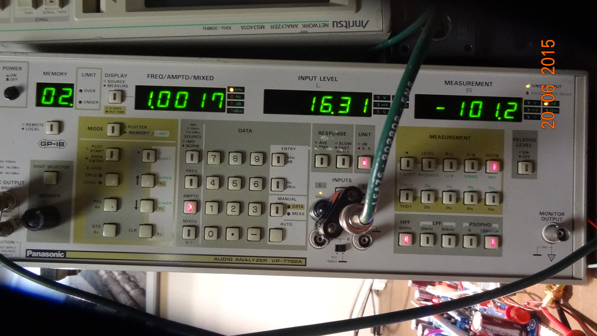

measured data -
Hi..... I too have very specific ideas about low Z pcb layout of power traces and grounds. But I've covered that else where in principle.
if I adhere to dadod's scheme in grounding and using his current pcb layout, I am getting some better numbers than before. I am done for now with listening and assured it is stable under a wide variety of speaker load characteristics. So I went back to test again.
With better grounding paths but still not the best... still on the bench... I am getting better numebrs than before..... Without all the numbers and power levels done over again, just take a look at one quick test i did this evening ref 3 Watts; 1KHz THD+N and THD:
-101dB thd+N
-111dB THD That is about .00025%
If anyone doubts how important power and grounds and pickup points are --- with this amp i will produce .015% under same operating conditions but different grounding arrangement.
THx-RNMarsh
THx-RNMarsh
Not a criticism , but 3W /1Khz is kind of a "light" load. Pitchfork line buffer
or a LME49600 will do .00003% right out of the box ???
Maybe like 20K/50W/8R ?
One might also note that a multi-pair OPS is pretty much running class A at 3W.
At >6W is where a 5 pair OPS transitions to AB , 1K THD jumps from sub ppm
to single digit PPM. I'm sure this simulated fact would scale to the real test.
The OPS is the major contributor to total THD (at higher power).

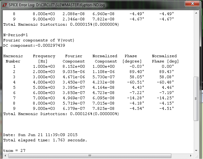

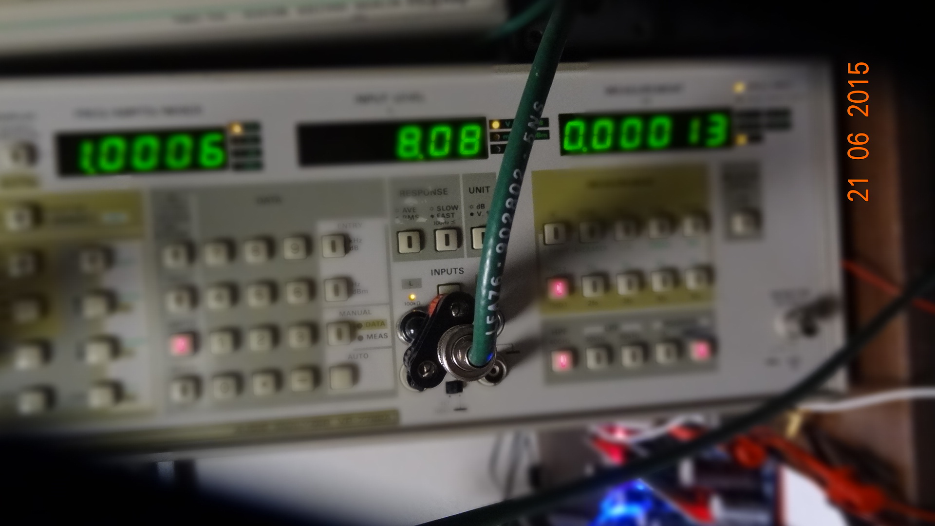

Sure. But grounding will still cause thd to be higher if not done right at any power level. It makes a big difference in realizing your sim results or not.
8 Watts:
![DSC01779.JPG DSC01779.JPG](https://www.diyaudio.com/community/data/attachments/443/443687-defaa35be498257e5b7c5151f0282c3c.jpg)
I'll do more testing tomorrow. too late here. Better grounding will help find minimum thd value.
-RNM
8 Watts:
View attachment 489600 .00013% THD [approx -115dB]
-RNM
Still very interesting .... Richard. I know it's not Dadod's amp , but my CFA (ND)
transitions from sub to single digit near 7-8W @70ma bias (below). All 3 of my
CFA's do this.
I know what you are saying with the LME49600. I simulated it and my discrete
version of it in a FB loop with an OPAxxx - got 1/2ppm @ 1K .
It all comes down to listening ... you heard Dadod's amp mostly in first watt (did
you "crank it") ?
I've noticed mostly on the CFA's , they "like" my huge 1KVA PS when I "crank" it.
SQ/ soundstage "opens up" considerably. PSRR is the factor here , way less
ripple on the big trafo /100Kuf PS.
The VFA's typically sound the same with my much smaller test supply or with the
big one. The "Blameless" is power supply "blind".
OS
