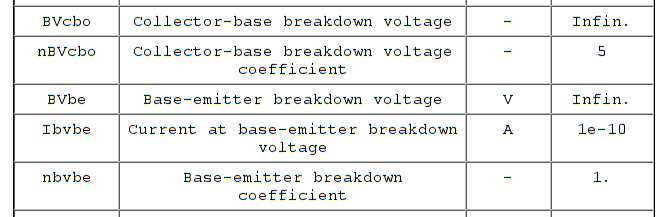

No, this is not true. Early effect is modelled as a straight-line, which is not the case (see Fig 7.13 in APAD6)The Early voltage is properly modeled in spice
Definitely true. A huge number of SPICE BJT models show the Early parameter VAF as exactly 100 Volts, which is suspicious to say the least. I guess it's not of much interest to anyone not doing audio, so manufacturers don't bother with it.it's the lack of interest from the device manufacturers to provide the proper model parameters.
If you're saying that SPICE doesn't incorporate device operating limits then this is indeed true.Quasi-saturation is not - I find this the most annoying problem in the standard spice. It is also interesting to watch in spice BJTs blocked (with Ic=0) by Vbe=-25V.

No, this is not true. Early effect is modelled as a straight-line, which is not the case (see Fig 7.13 in APAD6).
Yes, it is true. The Early effect is a linear dependence if Ic to Vce following Ic~(1+Vce/VA) where VA is the Early voltage. Therefore, in a small signal model, considering the Early effect leads to an output finite conductance of the BJT.
The nonlinear dependence Ic vs. Vce is the result of either (or both) of the non-uniform base doping, and approaching the base punch-through region. These effects are indeed not modeled in spice, however they don't fall under "Early effect". I would agree that these effects could be important e.g. in a VAS, because under large signal conditions, they modulate the VAS output conductance, and hence the VAS gain, resulting in nonlinearities.
LTSpice does have models for high voltage leakage and breakover point. Would this be sufficient? I haven't used the parameters yet because I haven't worked out how to get the data, but maybe using them to model Vce curves is a step in the right direction?
I'm not saying it's correct, but everyone I know lumps all the Ic vs Vce effect together and calls it Early effect for convenience.
It's worth noting that the linear dependence as modelled in SPICE still gives rise to non-linearity in a VAS simulation. This is normally only significant at low frequences. (see APAD6 p175-p180)

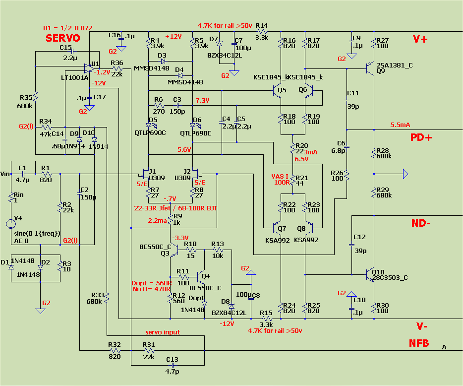

The only reason I did the IPS/VAS with complementary IPS and push pull VAS si because the amp that got me into all these is YBA, they use this topology. They don't even have cascode for the LTP and use resistor load for the LTP. They are even more primitive. It sounds fantastic to me. In the showroom, it was jaw dropping.
There is so much more than just slew rate, distortion and clipping. Clipping is particularly easy to fix, use diode something like the good old schottky TTL way to prevent the transistor from going to FF region. It's easy to put one diode up and up diode down to replace schottky diode with a good old 1N4149!!! Clamp the collector and you'll never see the waveform sticking!!! Or better yet, like Mr. Self said, don't crank it!!!
I definitely going to do a Blameless IPS/VAS. It's easy as I have separate board for IPS/VAS, it's only going to be about $30 a run for 10pcb. But I just want to try the complementary topology for the sake of the YBA first.

.I'm not saying it's correct, but everyone I know lumps all the Ic vs Vce effect together and calls it Early effect for convenience.
Some do not; Prof Sansen discusses separately the linear Early effect distortion contribution, and then the high injection effects.

I think the neatest arrangement is a "blend" of the standard LTP with a fully
symmetrical VAS (below). Member Vzaichenko measured <30ppm 20K with a
Valve as the first stage (in his version - http://www.diyaudio.com/forums/soli...erformance-yet-rather-simple-hybrid-more.html
. My builder used BJT's with more degeneration , but did
not have analysis capability. Simulation shows even the ability to have MORE
gain margin at 20K than a blameless. Sub PPM at 1-10Khz and better PSRR.
It's a 32 year old Sansui , repaired 3 of them .... main PS caps were shot ,
amps still worked on all 3 !!
Hey , it's not a CFA !! But , it's not a blameless either. There are many
good designs out there. Alan , when you start swapping out input stages ...
you will just see subtle differences in the presentation of your audio.
No one stage is so different that it is "bad" , unless it was improperly
designed in the first place.

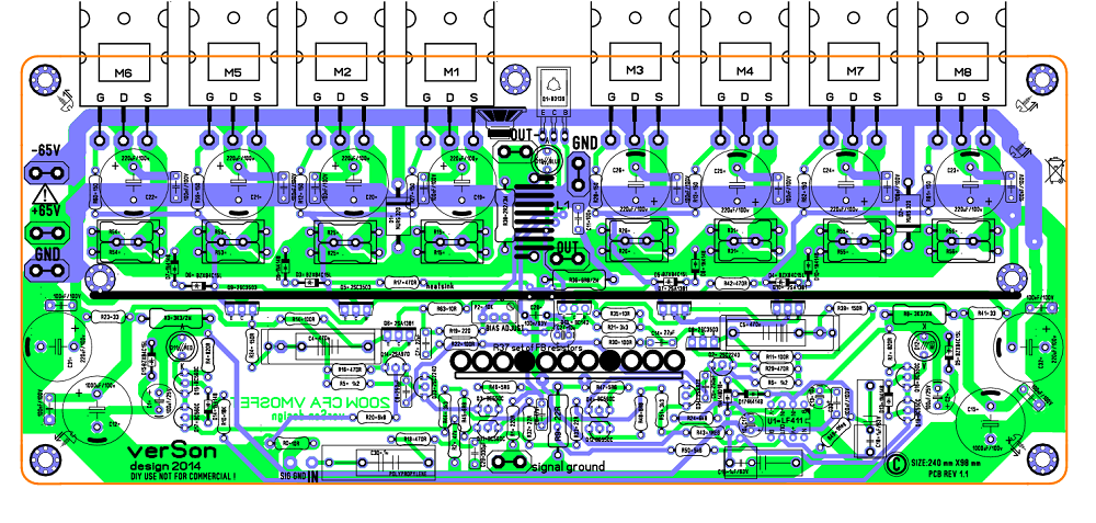

Kgrlee, yes I know all that but it's not easy to implement it to make perfect layout. I followed many discussion how to make good audio layout and this amp is my attempt to achieve all that, how good I am not sure.
Maybe you can comment on this layout, it is the one where I hope that distortion could go down when the boards are wired inside the chassis?

Dadod, I have to admit this PCB is very close to how I would do it.Kgrlee, yes I know all that but it's not easy to implement it to make perfect layout. I followed many discussion how to make good audio layout and this amp is my attempt to achieve all that, how good I am not sure.
In particular, all the high current flows in what is almost a bunch of twisted wires.
