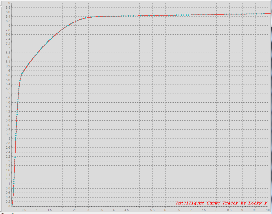

Isn't it a good idea to make sure that the active BJT (s) is always in the active region and thereby never enters or leaves the quasi sat region?

Yes, but [quasi saturation is] device dependent and not usually specified. You just have to be careful and make your own measurements.
Here's my own measurement of a MPSA42, whose quasi-saturation took D. Self by surprise (APAD 6ed p.186). Ibe is about 90uA. That's a seriously quasi saturated transistor!
