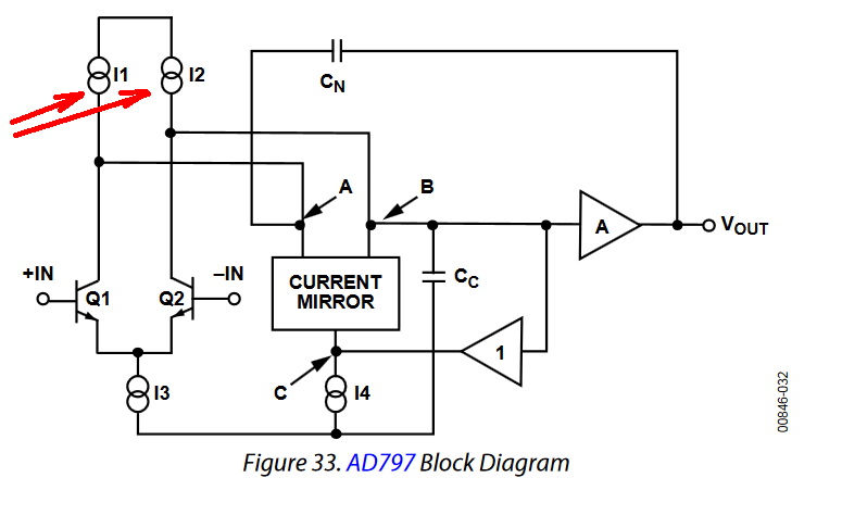

Finally we have the opportunity to ask ourselves: why does the world's lowest noise device (AD797) use current source loads on the input stage, rather than resistor loads? Are resistor loads STUPID?
Opamps have to play nice with realistic PSRR and voltage budgets.
emitter coupled folded cascode current mirror? Low Z at nodes A and B.
-RNM
Investigate the NE5534 and the LT1028 opamps. In both cases the input stage is an undegenerated NPN diffpair with resistor loads. OP27/37 too, but it was designed by the same guy who did the LT1028.Opamps have to play nice with realistic PSRR and voltage budgets.![]()
LT1028 PSRR is 130dB, DC gain is 143dB, CMRR is 122dB, input common mode range is (|rail| - 3.3V), output swing is (|rail| - 2.3V). It doesn't appear to me that the resistor loaded input stage has produced unrealistic PSRR and voltage budgets.

Here is the (30 years old, can you believe it?!) ISSCC paper about the LT1028 low noise opamp. The bottom left paragraph on page 1 says
The input stage is resistively loaded (R1 through R6 in Figure 2),
and the noise of the resistors is 11nV / rtHz. The sum of the second
stage voltage noise and current noise flowing through the load resistors
also equals 11nV / rtHZ at 1kHz; i.e., even the second stage has to be
a relatively low noise amplifier by itself. When these noise sources are
attenuated by the input stage gain of 100, and is rms summed with the
input transistors' noise, the net increase in the total amplifier noise is
1.3%.
I don't think George Erdi is lying or simplifying; In my opinion this paragraph tells the truth, the whole truth, and nothing but the truth.and the noise of the resistors is 11nV / rtHz. The sum of the second
