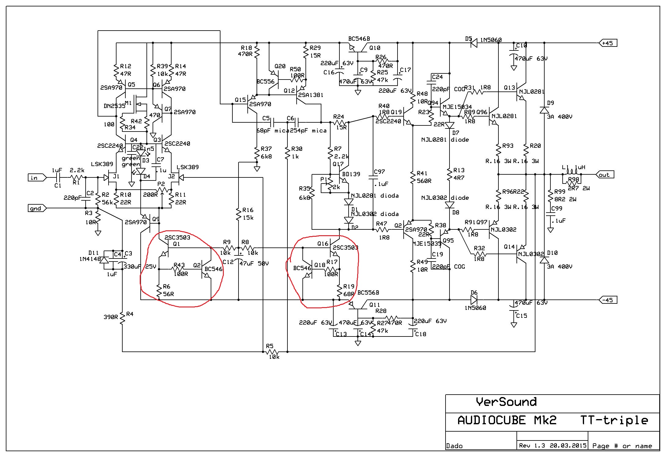

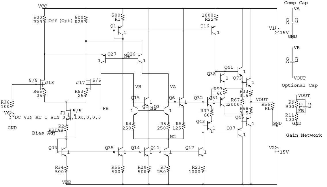

Sorry, the guys are right that was very simplified to show the basic signal path. This is more like it. I was simming this with 2N4401/03's and LSK389's a few years ago never made any boards but it was working pretty well.

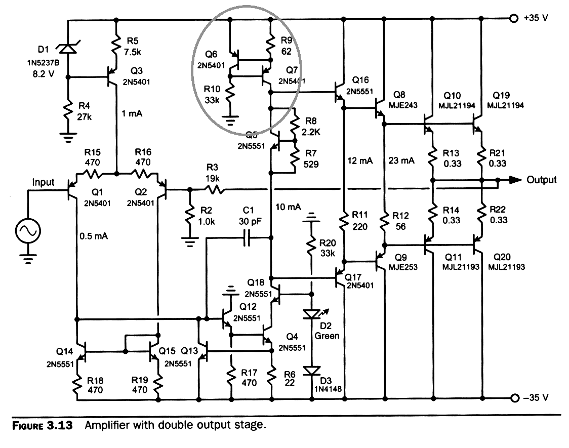

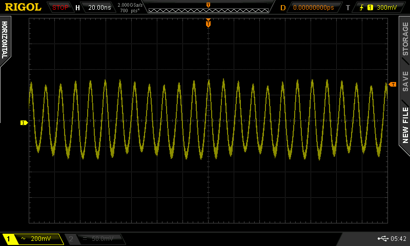

I laid out a PCB of a small power amp a couple weeks ago. It used the 2T current source circuit, seen many places including Bob's book: image #1 below.

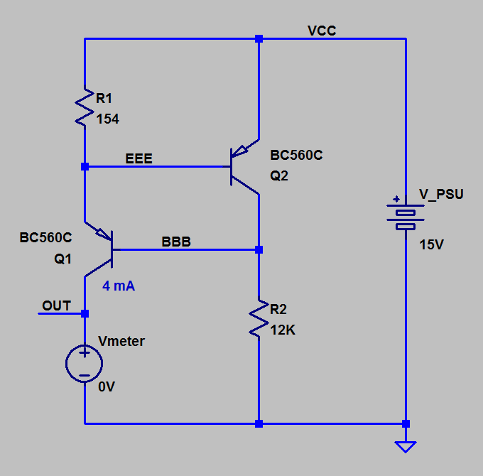

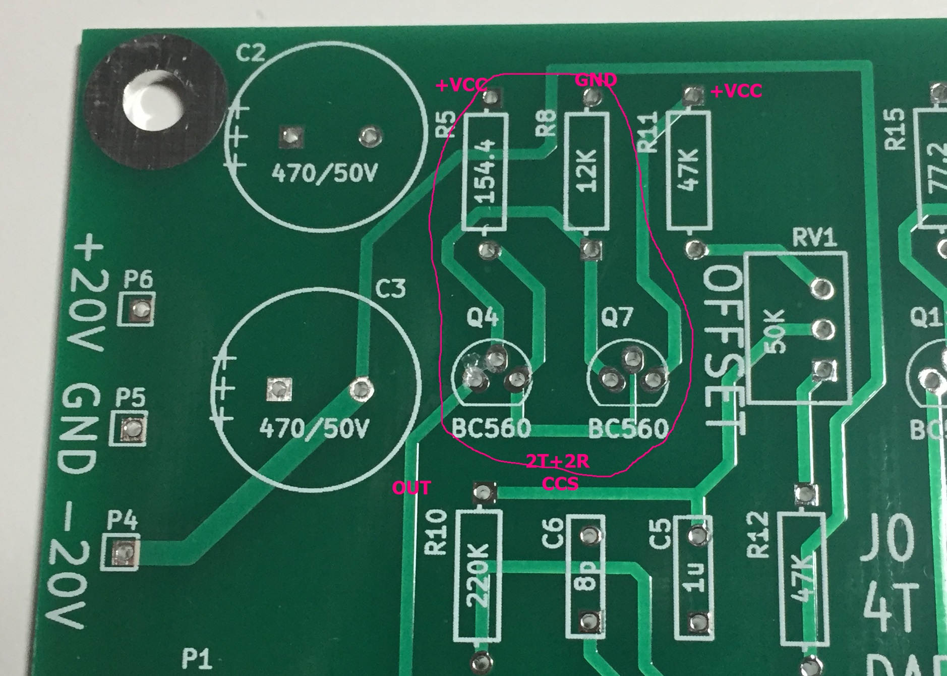

My PCB layout is shown in image #2. It's a dual layer PCB, some connections are on the other side of the board. Schematic (with different reference designators; sorry!) is image #3.

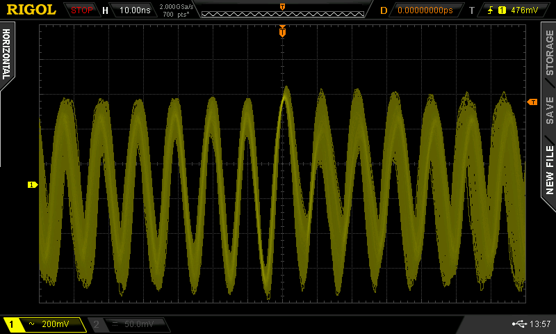

When blank boards arrived, I populated these two transistors, these two resistors, the power supply bypass capacitors, and nothing else. I just wanted to verify that I had correctly calculated the resistance to give (VBE / R) = 4.00 milliamps. And to my surprise, the meter reading was unstable. I connected the oscilloscope and: horrors! Oscillation.

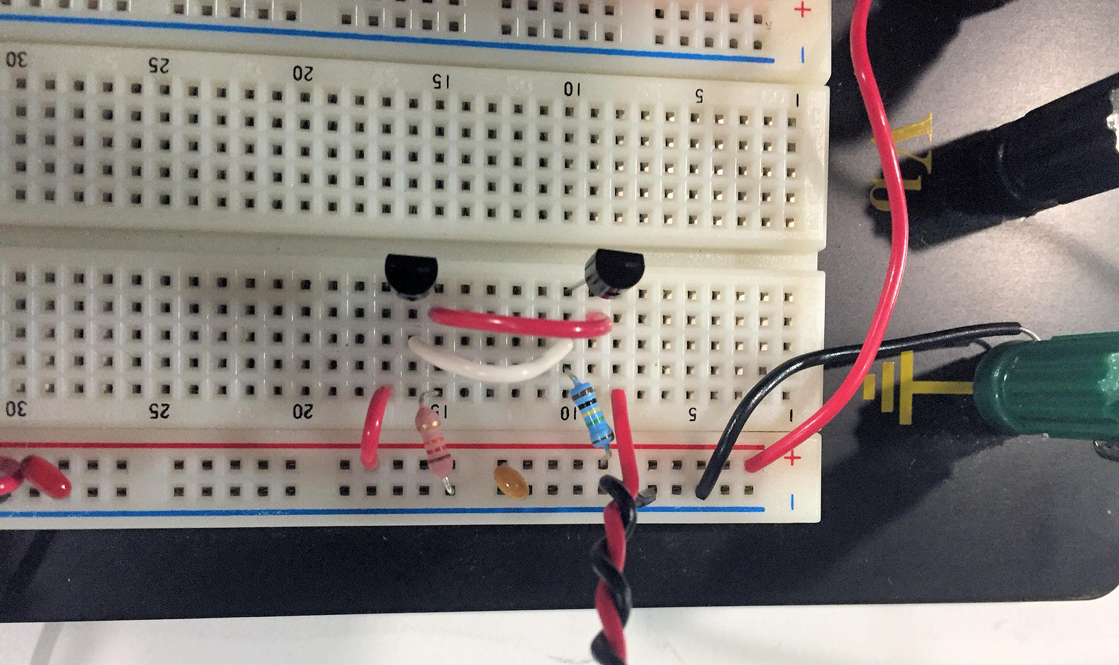

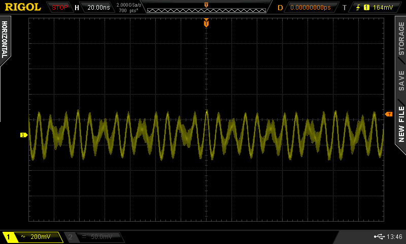

Not believing my eyes, I built up the identical circuit on a solderless breadboard: image #4. Q2 is on the left {its emitter is wired to +VCC} and Q1 is on the right. The white horizontal wire is node EEE and the red horizontal wire is node BBB. Image #5 is a scope photo, the damn thing oscillates even on the protoboard.

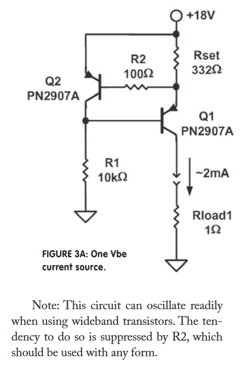

So then I read Walt Jung's article on current sources (here) and found Figure 3A plus accompanying text. D'oh! Image #6.

Because the circuit has both gain and feedback.
You can also compensate the gain with a small, usually 5-10pF, cap in the usual place.

Hi Mark,
Although I have not had trouble with this current source, I'll look more closely into it and make note of it in my second edition. It is not uncommon for circuits with as few as 2 high-speed transistors in a tight feedback path to raise concerns like this. The current mirror with helper transistor also has this kind of a feedback loop. A cascoded 2EF VAS with Miller compensation has 3 transistors in the loop and also can exhibit some HF stability issues.
BTW, I have also seen the resistor in series with the base in the CE VAS arrangement where that transistor comes into play when current-limiting the VAS.
Thanks for this feedback.
Bob

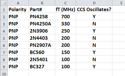

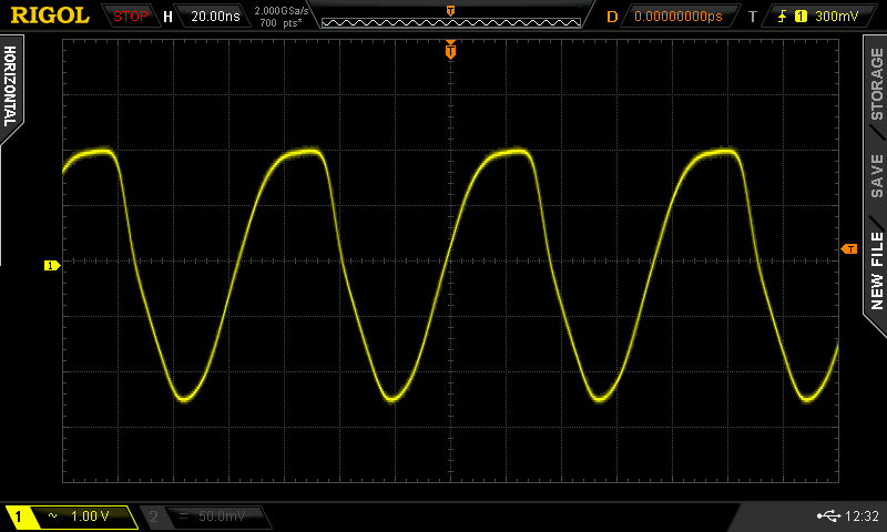

One of the nice things about a protoboard is, you can swap devices easily. So I tried seven other transistor types in addition to the BC550s shown in post #7525. Some of them oscillated in the 2T CCS without base stoppers, and others did not oscillate. I don't see a strong correlation to datasheet "transition frequency" fT but maybe that's not the right datum to study. Here's what I found; hover your mouse over the scope photos to read the part# embedded in the filename.

Nice work, Mark.
One factor that may influence the tendency to oscillate is the relationship of the current supplied to the "refrerence" transistor to the operating current of the actual current source transistor. The latter is generally chosen to be larger than the former, often by a factor or 10 or so.
The collector-base capacitances of the two transistors may also influence the tendency to oscillate.
One thing I always do is to try to minimize the possibility of my probing the circuit causing it to oscillate due to probe effects like added capacitance. I'll often use a probe with a 1k resistor at the tip, or use a low-capacitance 10:1 scope probe.

In every case the current source transistor is running at (VBE / 154R) = 4 mA
and the "reference" transistor is running at (15V - 2VBE) / 12K = 1.1 mA
I probed the circuit using Rigol RP3300A probes (image below) connected to a Rigol DS2302A oscilloscope (-3dB bandwidth = 300 MHz).

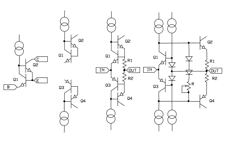

Have you ever seen this used anywhere? On the far left is Barry Blesser's "super" transistor IMO a different take on the CFP, published in 1968 IIRC. I took it in progression to the far right, something that behaves a lot like the two CFP output stage kind of an error corrected (with feedback) buffer. You synthesize a high input impedance from what is inherently a low one rather than a low output impedance from what is inherently a high one, an interesting flip-flop. The designer has a lot more control of the drive end than the load that gets hanged on the output, food for thought.

You might try running the reference transistor at 0.4 mA or less and see if the tendency to oscillate falls. Also, it looks like from your diagram that the current output is being connected to the rail through only 1 ohm. Try a 1k resistor, since in most applications the load for this current source will be of moderate to high impedance. The Miller effect introduced by load impedance and Ccb of the current source transistor may be in play in the stability behavior.
Nevertheless, that little 100 ohm resistor in series with the base of the reference transistor is a very inexpensive belt-and-suspenders technique, and I don't think it introduces any disadvantages.
Hi Scott,
No, I don't think I've seen this circuit. I really like the progression you showed. It would be a fun circuit to SPICE. How is the stability of the right-hand version?
Bob
Bob
It all needs to be explored, the basic circuit with some real models seems fine. Hanged/hung catching up on too many Sergio Leone movies this week.:)
@Bob
Aren't the right side Q1 and Q3, together with the base diodes, actually current mirrors? If the BE junctions ratio is 1 then the diodes and Q1/Q3 currents are equal and the delta between the base and the collector current sources forward biases the output pair through the 2 diodes in series. Is this some sort of sliding bias scheme?
