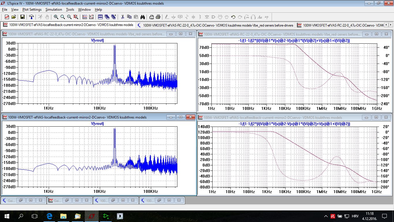

I think it does. It is simply something that is not in the input signal, so feedback will reduce it, the more so, the more loop gain is available at that low frequency.
Reading Bob's very good post above I believe we should more emphasize the falling of distortion at lower frequencies, rather than thinking the high frequency distortion rises, which it doesn't.
Jan
OK Jan you are correct.
I simulated mine two CFAs, one with wide bandwidth of 80 dB of LG and the same amp, but now instead of simple resistor loaded IPS it is active loaded with CMs and it has not so wide bandwidth but with 120 dB LG up to 1kHz.

But John's designs are not really state of the art as far as distortion goes. Distortion clearly standing out of the noise. It s probably not wise to lower the noise further at the expense of increasing the distortion even more, which as Dadod showed is what would happen.

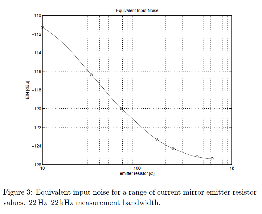

Bob, I don't understand this - I would have thought that the mirror degeneration resistor might be too high for low noise?
Jan, take a look at Samuel Groner's critique of D.Self's 5th edition, page 4, Figure 3. Groner built several "model amplifiers" (all TO92 IPS + VAS + classA_EF_OPS) and measured their equivalent input noise with different values of emitter degeneration resistors in the current mirror. What he found in real life, exactly matches what you and I see in LTSPICE ".NOISE" simulations: bigger degeneration resistances in the mirror, give lower noise. Groner realized that measured data on real amplifiers woulld be a LOT more convincing than simulations or equations, and that's what he did.
This forced Self to add a couple of paragraphs to the 6th edition, not quite admitting that he made a design error, but instead marvelling over this discovery of a new noise source (6th edition p.152).
_
Mr. Cordell is right this time. In a current source, the emitter degeneration component of the collector noise current is inverse proportional to the square root of the emitter degeneration resistor value. Perhaps counter intuitive, but that's it.
Grab a pen and calculate; you'll find that the collector noise current is about the emitter degeneration resistor noise voltage divided by the emitter degeneration resistor. Since the emitter degeneration resistor noise voltage is proportional to the square root of the resistor value, it follows that the collector noise current is proportional to the square root of the emitter degeneration resistor value.
Perhaps more intuitive, it happens because the emitter degeneration resistor noise voltage is divided by the resistor and the transistor rb'e. The larger the emitter degeneration resistor, the smaller the transistor "input" voltage, but since the resistor noise increases only as sqrt with the resistor value, increasing the resistor actually decreases the output noise current.

I took a look at Samuels document, I found it on his home site.
It seems like he is only focusing on the value of the Emitter degeneration resistor in the current mirror to get the lowest noise.
In my opinion he should have looked at the voltagedrop across the Emitter degeneration resistor RE (AKA the feedback resistor in the CM). That is because the value of RE depends on the Collector current IC.
As I have posted earlier in this thread as an answer to a question from Edmond, I have found that a 5V voltagedrop across RE is a good compromise between noise and gain (low THD).
