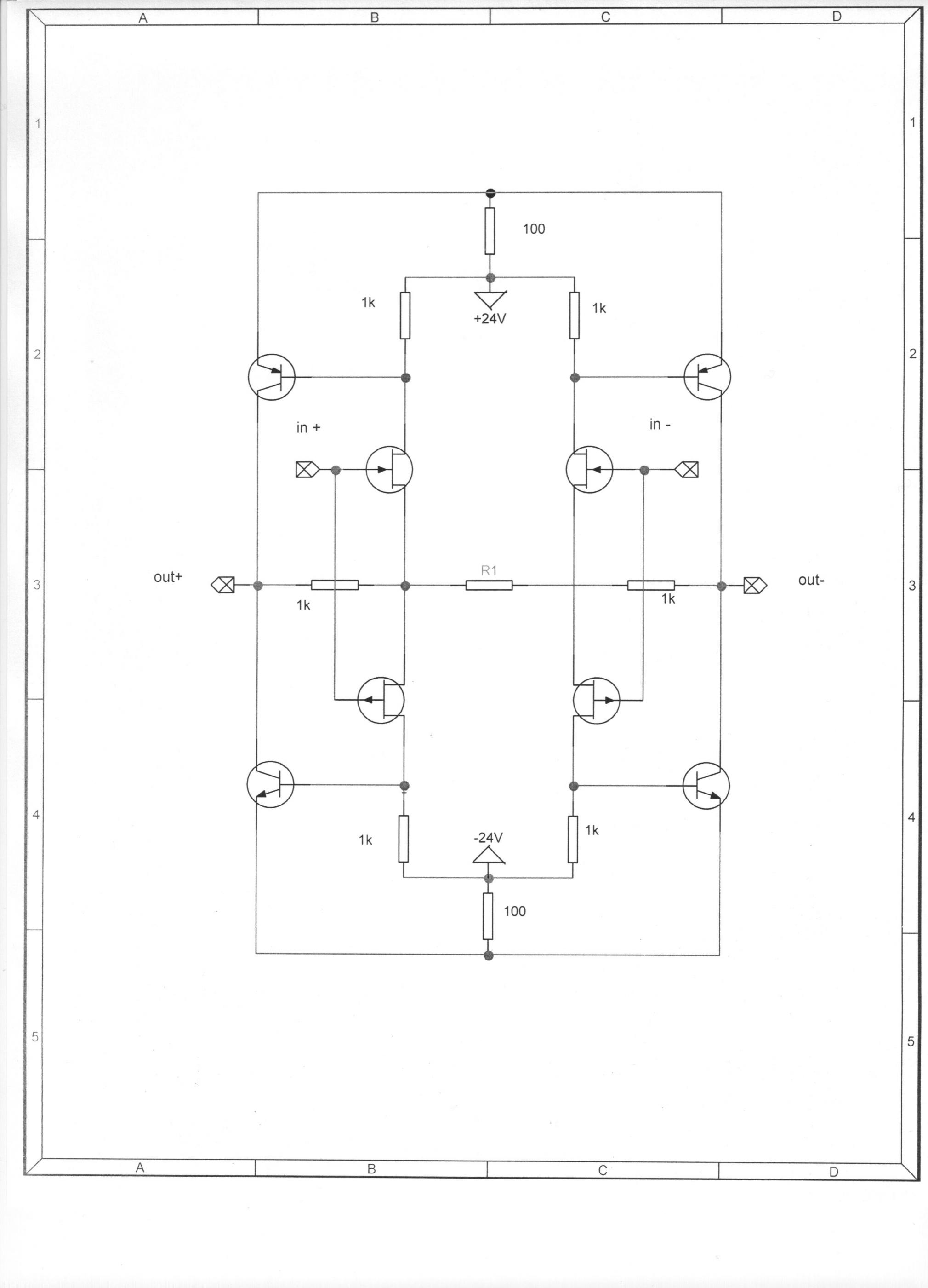

Not input conversion from balanced to single ended , but fully balanced from input to output, this takes two complete ampifiers with the speaker driven by two output stages, one for the positive and one for the negative half of the signal. Carefull matching of gain determing resistors for each amplifier section is needed to acomplish it well

You can think of a "balanced amplifier" as a bridged connection. Instead of using the single input, inverting and amplifying that for the second amplifier, you are supplying both inputs. Of course now the onus is on your to provide the two exactly matched output signals exactly 180° out of phase with identical impedance.
The only values of using a bridged (or balanced) amplifier are reduced voltage requirements for a given power output, and it also requires less rise time to achieve the minimum needed for a signal. That shouldn't ever be an issue with a good pair of amplifier circuits. So we are down to lower supply voltages and more SOA limits to worry about as a result. I see this as an advantage only for high power output situations.

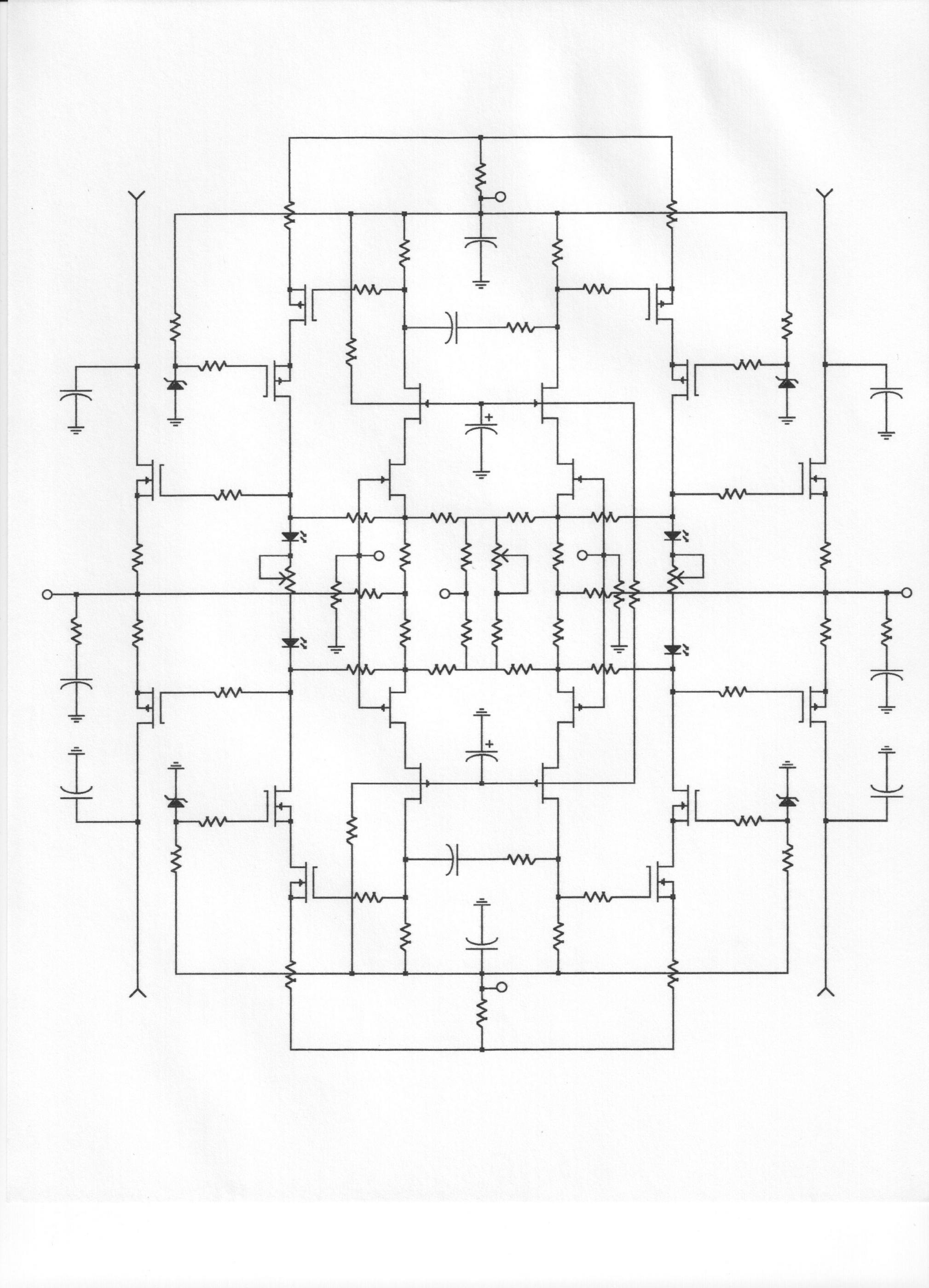

Sometime around 2007 we learned of a way to make fully balanced differential amplifiers with only a single input stage. While I didn't invent the topology, our team worked very hard to simplify the design to maintain top performance and to add ease of manufacture.
I believe the fully differential balanced design with our four-quadrant input stage and current feedback is the best way to achieve my goals.

Personally, I like drawing the distinction between a "true or pure balanced" design and a "bridged" design as Bob has done. Presumably the bridged design means a trade-off in terms of distortion as evidenced in the specs for this amp. The slew rate isn't impressive either but presumably sufficient.
As regards the size of the toroids, they didn't comment. But is it really the case that one should think of 16 x 150W as Waly wrote? Is there not efficiency to be had from the power supply as a result of the full wave rather than half wave current draw?
The input stage sounds interesting. Perhaps based at its core on the work of Barrie Gilbert?
You may be forgetting that "bridged" requires inverting one channel and summing the output. From my perspective [...] I believe that qualifiers as "full differential and balanced."
You've also uncovered one of the advantages of the balanced design which I usually summarize as, "1/2 the noise, twice the slew rate and 1/2 the operating voltage."
With the Signature amps and other Kessler designs that share the single 4-quadrant input stage we actually get 1/4 the noise.
