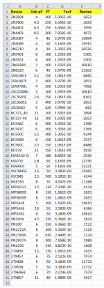

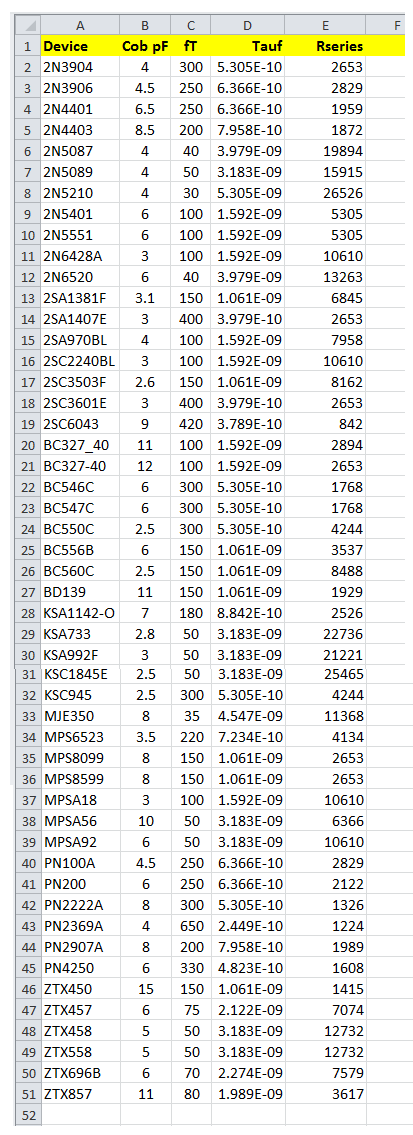

I told Excel to build a table showing the calculated values from
Why not wait and see what Bob Cordell has to say? Perhaps he has a different rule-of-thumb in mind. I think it is possible that Bob may suggest
Bob may suggest that you use the "min" value of Beta from the datasheet.
Rseries = (20 * Tauf) / Ccb
for some commonly used transistors. ("Cob" is datasheet speak for Ccb). The table includes several resistors greater than 10K, which, as member Ranchu32 points out, is greater than the 2.7Kohm value mentioned by Douglas Self and quoted in post #7618 here in this DIYA thread.Why not wait and see what Bob Cordell has to say? Perhaps he has a different rule-of-thumb in mind. I think it is possible that Bob may suggest
- Connect a resistor in series with the control transistor's base, chosen so that (base current) x (resistor value) equals 2-5 millivolts

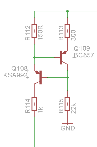

Better would be to put a smaller resistor in the emitter of the control device.
How much would you degenerate it - about 10:1? Is this the sort of thing you have in mind? NB: 35V rail.
Yes. But the resistor can be a LOT smaller for 'similar' effect. The ratio is hfe.
eg if you find a 3k resistor in Q109 base gives you the desired stability and Q109 has hfe 300, .. an emitter resistor of R113 = 3k / 300 = 10R should do the trick.
But this is just a suggestion on my part. I haven't tried it.
