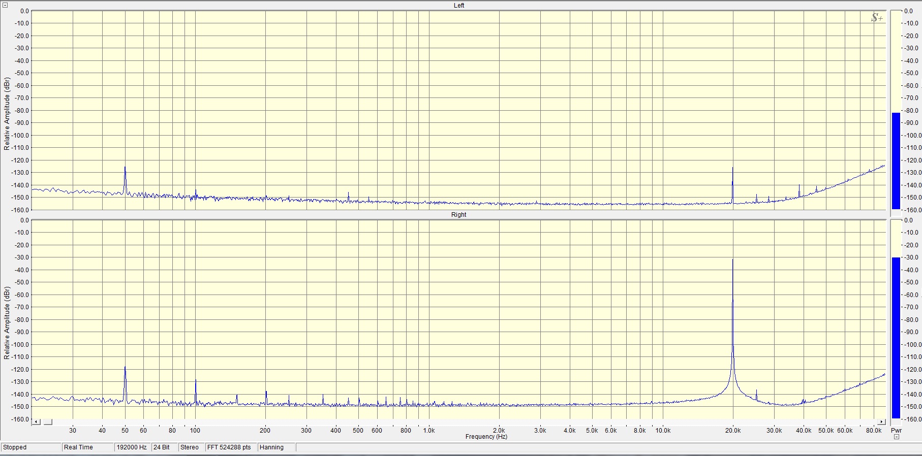

For example, here are a couple of graphs, made using a filter with a suppression of 20 kHz by 20 dB.
All I can see is that your filter suppresses the 20kHz and also the harmonics above 20kHz ...
Yes, I see that also, Dick Moore very easily obtained 60 dB nulls with only .5 dB attenuation of the 2nd harmonic. Working hard he says he was able to get 100 dB nulls but could not hold them for very long. Dick used good modern OP amps, no need for a composite.

Yes, of course. This suppression must be considered.All I can see is that your filter suppresses the 20kHz and also the harmonics above 20kHz ...
I was interested in the coincidence of the results of simulations and measurements. The results of the simulation were confirmed by several harmonics.
I can't hear the second harmonic of the signal of 20 kHz and above. So I don't see much sense to measure harmonics above.

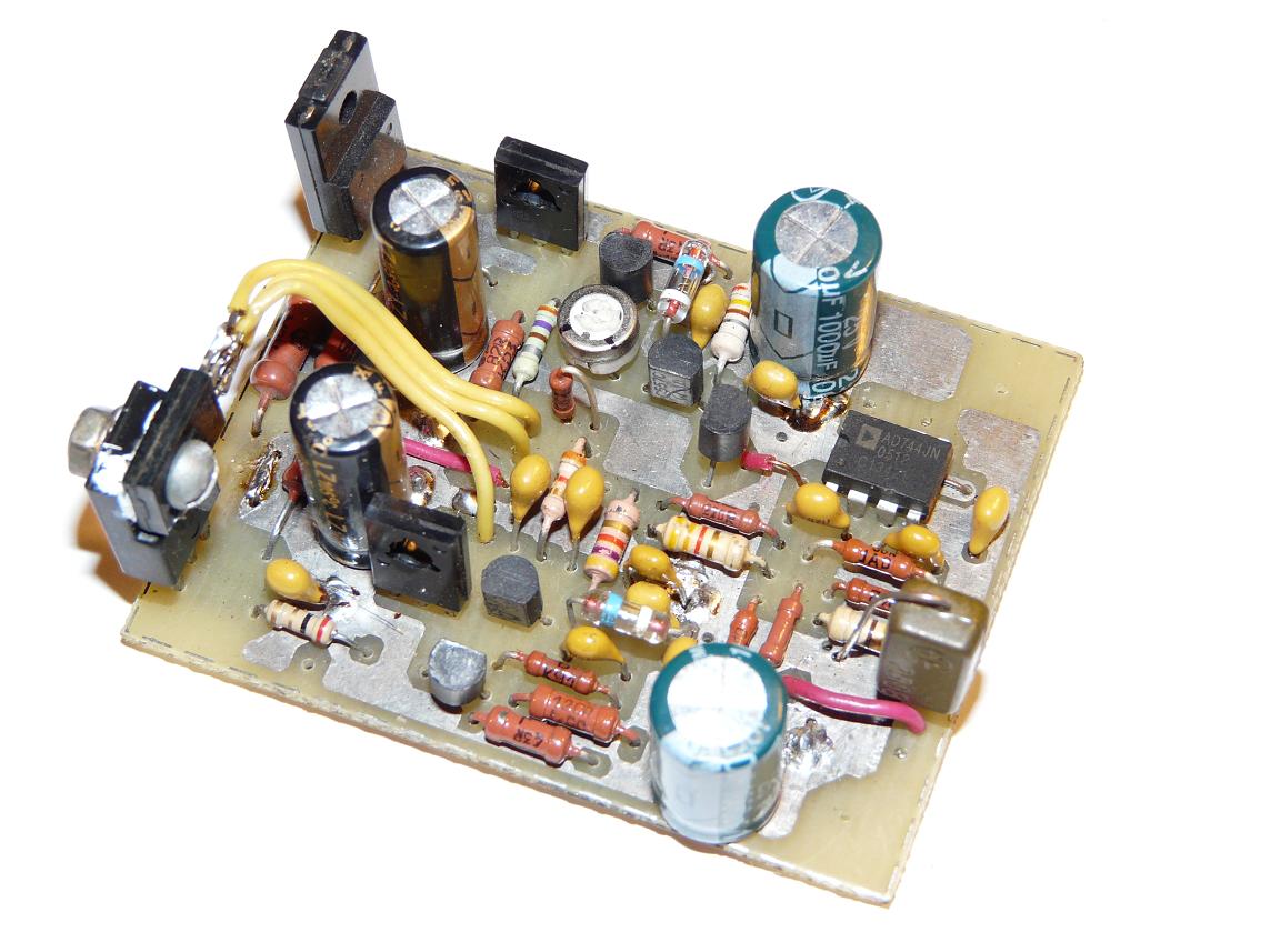

For example:
This model amplifier, with which I began. This scheme is as simple and just as effective.
2 ppm @ 20k @150 W @ 8 Ohm according to the simulation, 3 ppm according to measurements.![]()

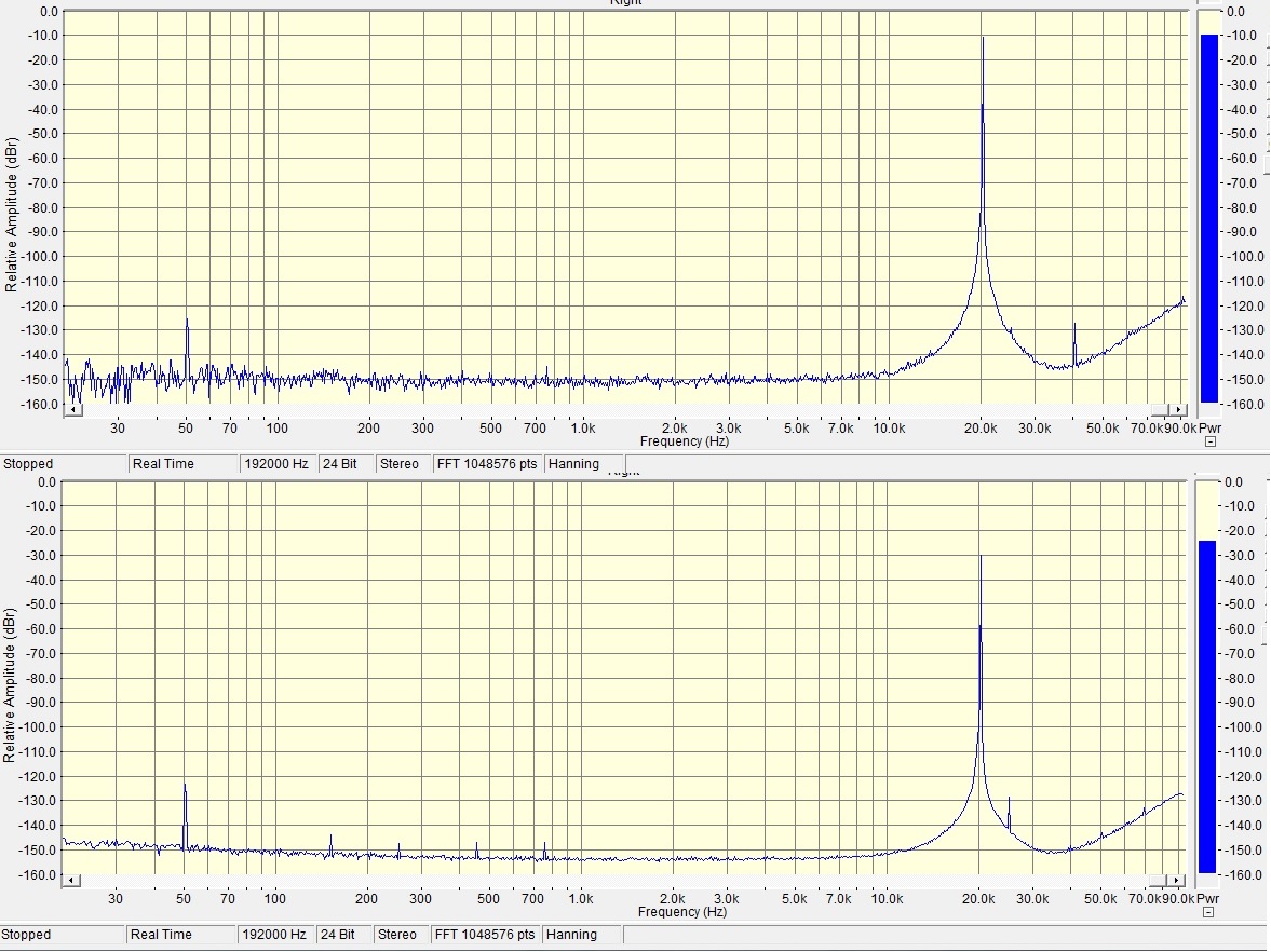

Thx! I try to ask again: how do you measure the 3ppm THD20k@150W8R? With the filter shown be4?
3ppm is 0.000,3%. This value can be measured without a filter and with a filter, but, of course, seen only two or three harmonics.

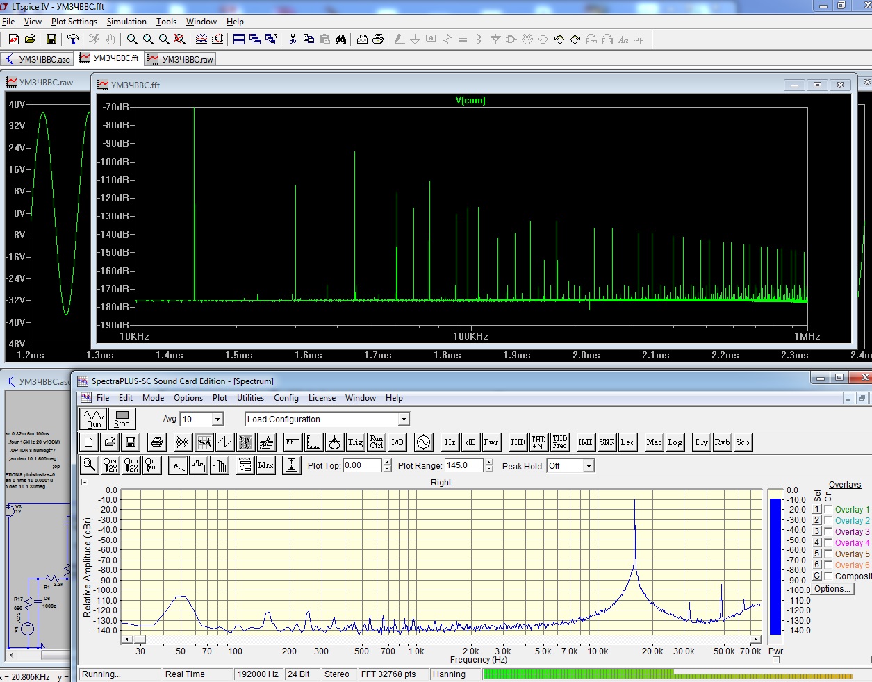

The photo - comparison of simulation and measurements for this amplifier.
H2 has a delta of -102dB
H3 has a delta of -85dB
IMHO this is far away from 3ppm ... it smells like >50 ppm.
Maybe I'm completely wrong - maybe one can do a calculation?
