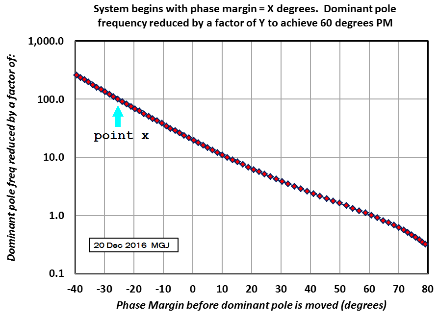

Bob, I've been thinking about what you might say in your 2nd edition, regarding Michael Kiwanuka's modified current source circuit. I've wondered what might be a simple and robust design procedure for choosing the values of his frequency compensation components R3 and C1 (schematic below).
One design algorithm for choosing R3 and C1, which does give a robustly stable circuit, is the following:
1. Put the circuit into LTSPICE (omitting C1 and R3), and run an AC analysis simulation. Find the magnitude of the open loop transfer function at a very low frequency like 100Hz. Call this number LFGAINDB. Also find the frequency at which the open loop transfer function has fallen 3dB below LFGAINDB, i.e., the dominant pole frequency. Call this number DPBEFORE.
2. Calculate the impedance at the collector of the control transistor Q2. This is roughly equal to (R1 * BetaQ1) // R2. Call this number ZCOLL.
3. Choose C1 such that ZCOLL and C1 form a pole at a frequency 100X lower than DPBEFORE. Numerically,
4. Choose R3 such that R3 and C1 form a zero at 2X the new unity gain crossover. Numerically,
5. Install R3 and C1 into the LTSPICE simulation and assign them the values calculated in steps 3 and 4. Simulate again and verify that the phase margin and gain margin are acceptable.
C1 = 100 / (ZCOLL * 2 * PI * DPBEFORE)
DPAFTER = DPBEFORE / 100
LFGAINX = ANTILOG10(LFGAINDB / 20)
UGCNEW = DPAFTER * LFGAINX
R3 = 1 / (4 * C1 * PI * UGCNEW)

edit- here's a complete non-sequitur (attached below). Point x represents my opinion of the worst case starting point (-25 degrees of Phase Margin, i.e., guaranteed oscillation). If you lower the dominant pole by 100X, Phase Margin becomes +60 degrees. Much more better. That's where "100X" came from in step 3 of the design algorithm.
