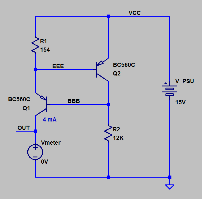

Actually this brings up a good question for Mark Johnson & Bob.
Would wriggles in the output Z on a plot to 100MHz be a reliable indication of stability problems with the 2T CCS?
I ask as I'm having problems interpreting my poor attempts at simming the instability that Mark found.
I'm hoping, of course, that making the output Z plot look nice means I'm making the CCS stable too
Found this post by Michael Kiwanuka which said,
For those who prefer .TRANsient analysis instead of .AC analysis: Inject a current impulse into node EEE and observe the transient behavior. Do it again with 30pF of stray capacitance from EEE to VCC.
He ought to try simulating two BC560's and the Cordell Audio spice models as shown below. Phase margin is NOT in excess of 90 degrees.... simulating the ANF current source's loop gain in SPICE. This should demonstrate that said ANF current source possesses completely innocuous LHP singularities giving a phase margin in excess of 90 degrees.

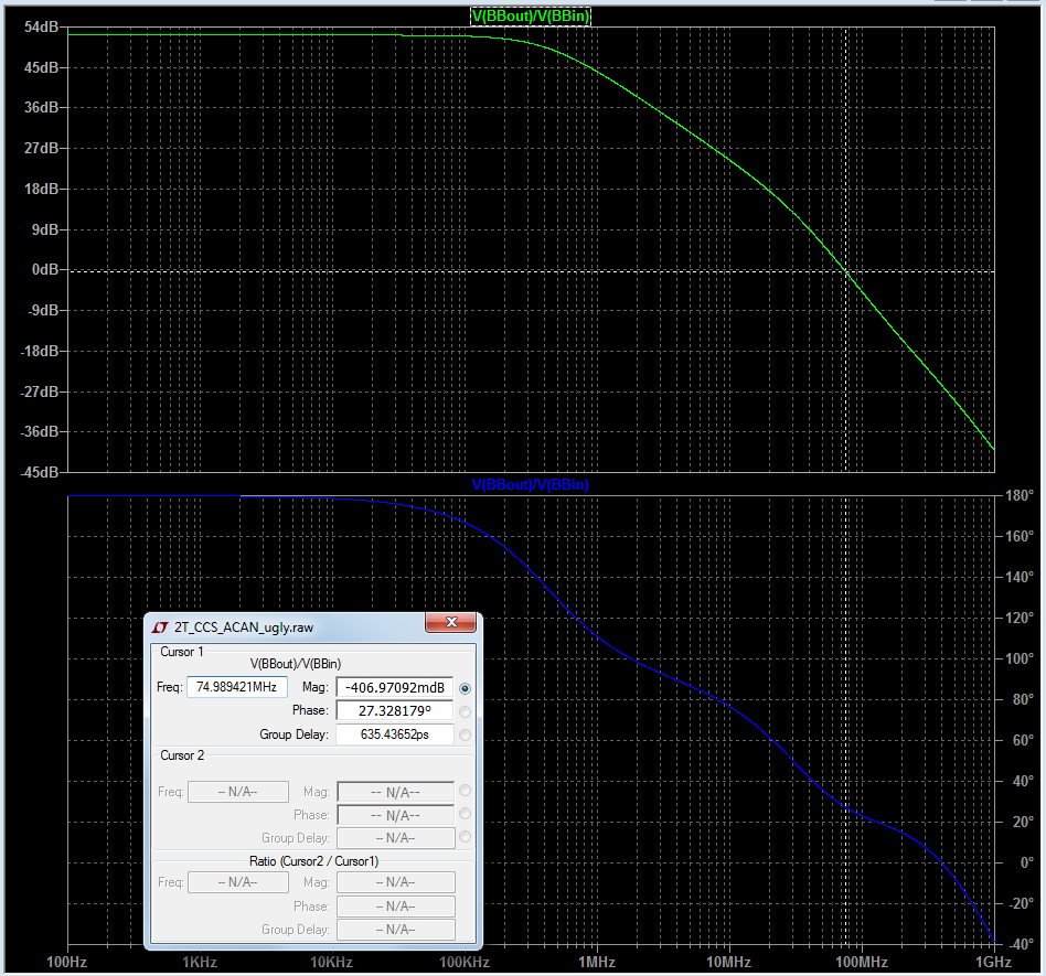

And here it is. We can measure phase margin two different ways.

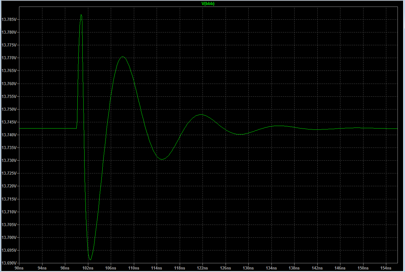

Perhaps the easiest is to run a .TRANsient analysis, inject a disturbance, and plot the ringing. Then we use the method of Logarithmic Decrements to find the damping factor Zeta. Measuring the first and third "troughs" in the waveform:
The not quite so easy way to measure phase margin in simulation, is to run an .AC analysis. The result is Figure 3; Phase Margin = 27.3 degrees as seen in the little cursor window. The two answers are satisfyingly similar.
At least for this one particular instance of an "Amplified Negative Feedback" current source, using Cordell Audio spice models of BC560 transistors, Phase Margin is dangerously low: waaaaay less than 90 degrees.
x1=51.5mV
x3=2.5mV
delta=1.513
Zeta=0.234
Now that we know the damping factor Zeta, we can use the handy second order linear systems formula from this web page to convert from Zeta into phase margin in degrees. The answer is: Phase Margin = 26.3 degrees when Zeta=0.234.x3=2.5mV
delta=1.513
Zeta=0.234
