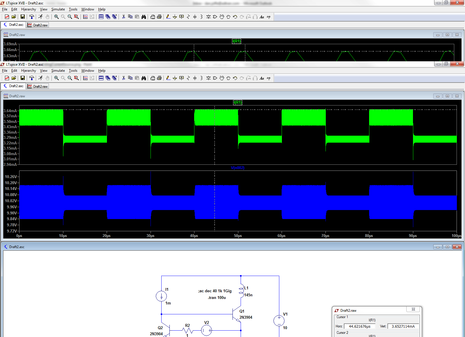

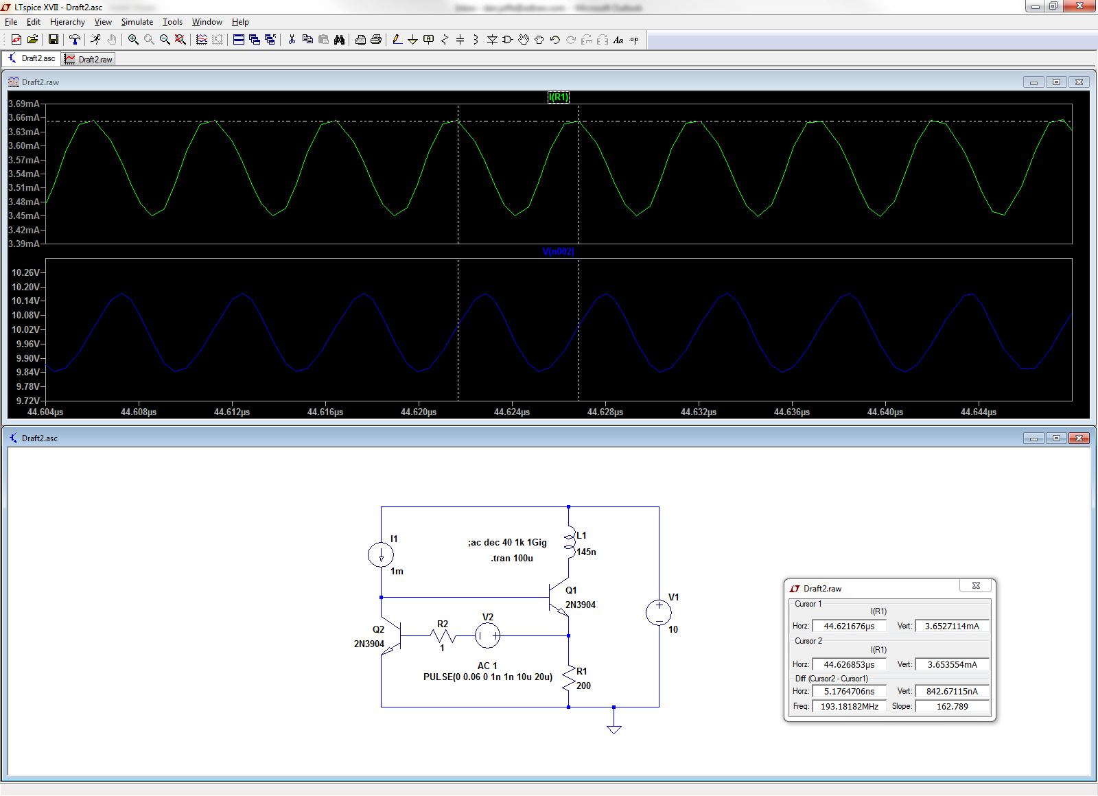

The famous 2 transistor current source oscillating in LTSpice
You need to add a little bit of inductance to get it to oscillate, and a bit of stimulus to reliably kick it off, but you can see the two transistor Vbe referenced current source oscillate quite nicely. 145 nH was about the minimum to get it to oscillate. The frequency was 193 MHz. Node 2 is where the 145 nH meets the collector.
Dan, I got it to oscillate in real life, both on a PCB and also on a solderless protoboard, with no extra inductance: post #7525 shows the waveforms.
I also got it to oscillate in LTSPICE simulation, by choosing the "right" transistors, by connecting a low impedance load to the current source output, and by adding ten picofarads of stray capacitance to the output transistor's emitter: post #7585

145 nH isn't much inductance! If I used the admittedly crude approximation of 1mm/nH, this would just be 145 mm...about 6 inches of wire. Given some "appropriate" transistors...I'm sure you could get it to whistle with even less stray inductance.

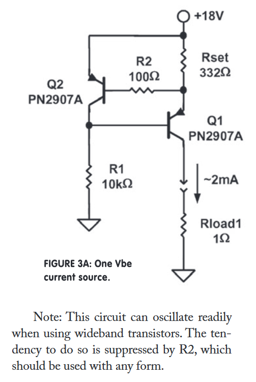

Walt Jung's schematic is attached; he is careful to explicitly include (a) the load resistance driven by the current source; (b) base resistor R2 which allows pole-splitting; (c) a warning that the circuit can oscillate.Is the 2T current source what's shown in Figure 2.9a in Bob's 1st edition?
When I plot open loop gain and phase of the circuit in LTSPICE AC analysis, I find that item (a) above is crucial. Small changes in load resistance produce large changes in stability margin.

Bob, I suspect it is possible to write up a few recommendations that will help people avoid trouble with the 2T current source, and I was hoping that other readers of this thread would contribute a few of them for your consideration.
I believe it might help a whole lot to point out that a resistor in series with the base of the control transistor, works in conjunction with the control transistor's Collector-Base capacitance, giving classical "pole splitting". The final location of the LF pole depends on the external resistor, the Ccb capacitance, the stage gain (Ceffective = C*(1+gain) i.e. the classical Miller Effect), and other factors. You could suggest, as I occasionally have done, that people select Rbase such that (Rbase * Ccb) > (20 * Tauf) where of course Tauf = 1/(2*pi*fT). It's overkill but it's also very safe.
