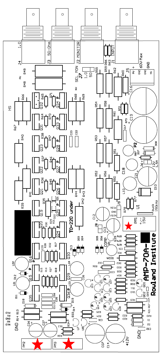

The PCB layout is included in Winfield Hill's thread, linked above.
