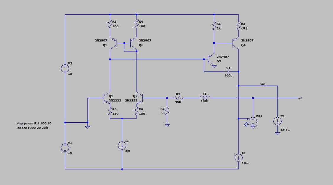

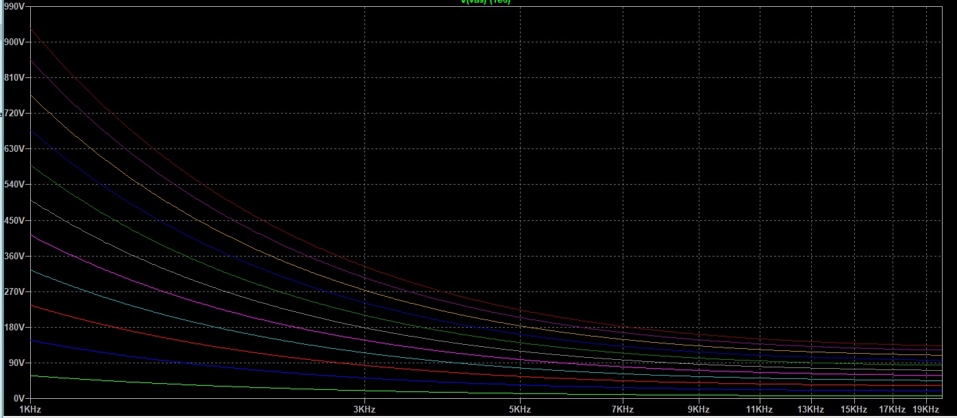

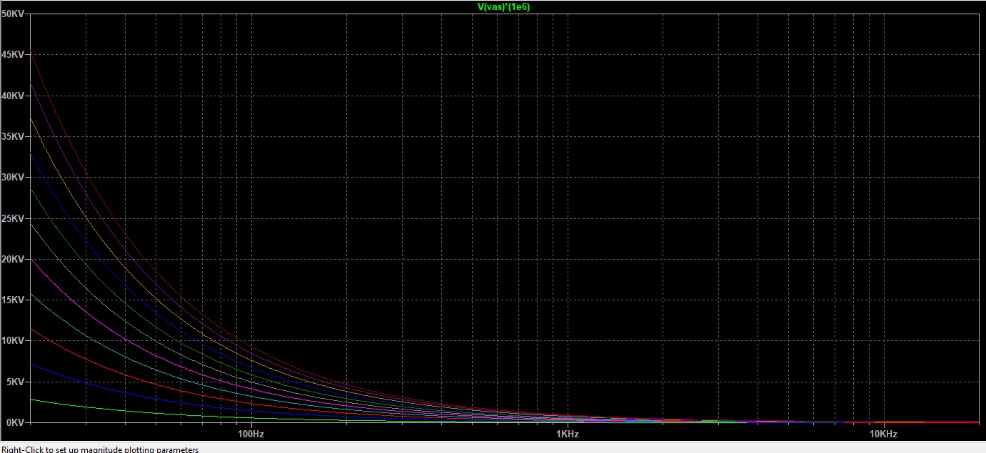

Here is a quick simulation of an idealized amplifier plotting VAS collector impedance:
The VAS emitter degeneration is stepped from 1 ohm to 100 ohms in 10 ohm steps.
The 1uA AC current source facilitates measuring the impedance at the VAS collector.
The vertical scale in volts can be read directly in ohms.
The 100T inductor disables the global feedback loop for AC analysis in the frequency range of interest.
Even at 1kHz the difference in collector impedance is still very significant, spanning from 60 ohms to more than 900.

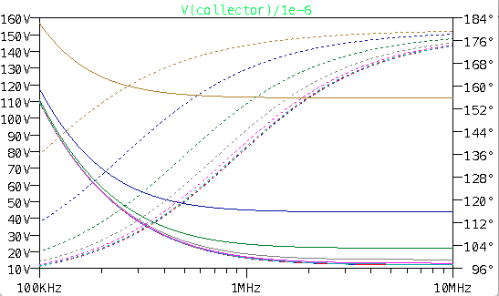

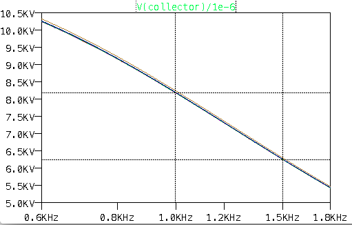

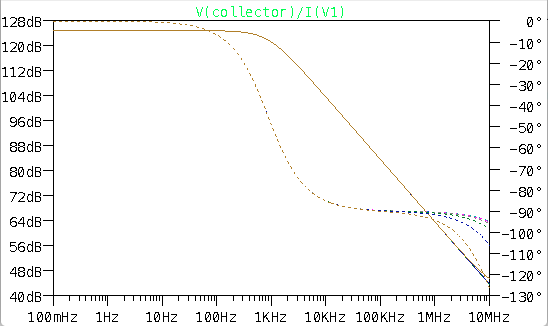

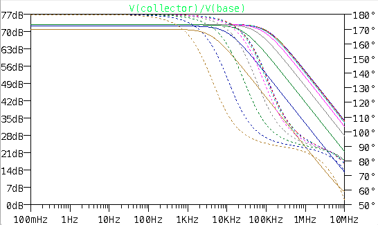

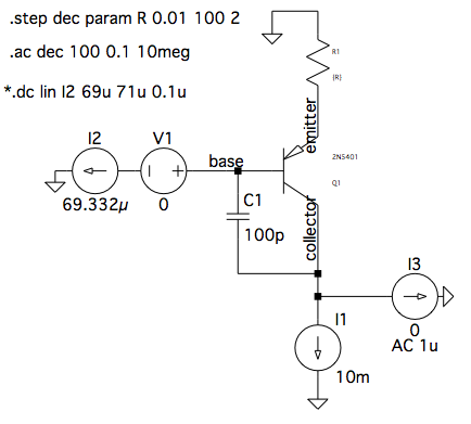

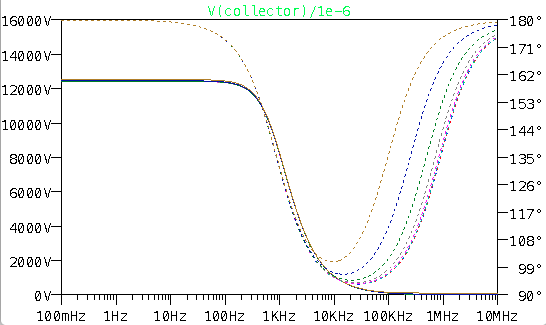

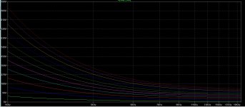

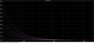

The recent post by poldaaudio prompted me to revisit the simple LTSpice model that I began some weeks back. I prefer to focus in as much as possible on the thing of interest so I didn't create anything more involved than I thought absolutely necessary. Having done a dc sweep to determine the base current that will result in about 25V on the collector I set the current source at the base to that value. RE was stepped over 4 decades and the impedance at the collector node plotted vs. frequency. Substitute "ohms" for "volts" on the left axis and the numbers may be read directly as impedance.
Most of the variation in impedance is seen above 100 kHz and not much is seen at 1 kHz. The last graphs shows the transresistance gain, V(collector)/I(base_node), and the voltage gain, V(collector)/V(base). So is the current source connected VAS better viewed as current or voltage driven?
Find out how the design in front of you behaves, don't burden yourself with rule of thumb if you don't have to.

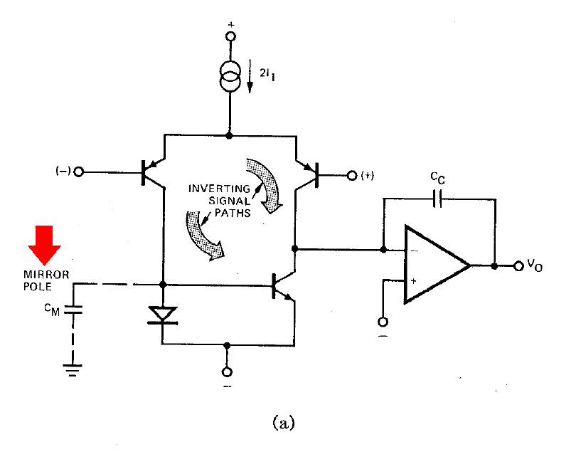

Minimalists prefer not to put the signal through another two (!) highly nonlinear devices. They also prefer to avoid what James Solomon's educational article calls "the mirror pole" as shown in his Figure 19(a), attached below.
A link to the Solomon article appears in post #7322 of this thread, among many other places.

Mark, why is this Cm-pole significant, since the voltage across it is pretty much constant?
That's irrelevant. The "mirror pole" is draining current from the transistor collector, at a frequency of I/(2*PI*C*Vt) where Vt=kT/q and I is half of the long tail current. Assuming this is the one an only pole in the input stage, since it drains current for only half of the input stage signal, the overall frequency response has a pole-zero pair, separated by an octave. But unless this pair occurs close to the amplifier UGF, where it can significantly degrade the phase margin, it is of little importance. You can plug some values in the above pole formula and you will find that mostly micropower op amps could be potentially affected. So while the "mirror pole" can be significant in certain cases, it can safely be ignored in any discrete design.
The expression given in the Solomon paper for the pole frequency due to Cm involves the tail current, I1. In his example I1 = 1 uA which gave a pole frequency of just under a MHz. Assuming the capacitances are otherwise the same, and a discreet implementation with a tail current 3 orders of magnitude greater, this pole would be around 100 MHz.
I'm sorry, not looking for a fight, but sincerely don't get it.
We have a cap where (assuming an ideal supply) the voltage is absolutely constant. How can any current flow through a cap that has a non-varying voltage across it?
I'm sure you're right, I just don't get it ...
Jan
I believe you are confusing the DC voltage (indeed approximately constant) with the AC Vbe voltage. Drawing the equivalent schematic using the bipolar small signal model will show the difference.
As usual, large signal vs. small signal models can be confusing...
