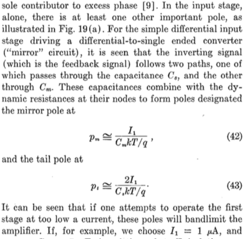

I believe you are confusing the DC voltage (indeed approximately constant) with the AC Vbe voltage. Drawing the equivalent schematic using the bipolar small signal model will show the difference.
As usual, large signal vs. small signal models can be confusing...
No I get that, it's only the varying Vbe that would appear, but with the very small current excursions we're talking a couple of mV across the Cm. In parallel to the dynamic b-e impedance.
Jan
Jan-I concur with syn08. Here is a snippet from the relevant section of the Solomon paper and the figure to which he refers.

Really, I don't understand what's bothering you here. The rule of (manually) calculating pole-zeroes is to get each cap (Cb'e, Cb'c), apply a current/voltage source (whatever is more convenient) at it's terminals (while all other caps are disconnected) and determine the impedance (it will always have a real part only, since no other reactive components exist). This impedance multiplied by the cap value will be 2*PI*fpole (or zero). In this case, at the node of interest, you have at least 2*Cb'e of the transistors in the current mirror, plus whatever comes from the signal transistors Cb'c. As the conductance at the Cb'e terminals is certainly not zero (it's at least 2/Rb'e of the mirror transistors), here's your "mirror pole".

Minimalists prefer not to put the signal through another two (!) highly nonlinear devices. They also prefer to avoid what James Solomon's educational article calls "the mirror pole" as shown in his Figure 19(a), attached below.
A link to the Solomon article appears in post #7322 of this thread, among many other places.

Hi Mark, I just finished reading the paper you suggested, it is a great one! thank you for the suggestion, however the paper is taylored primarily towards IC designed opamps, with very low LTP currents in the order of 1-10 uAmps.
I see, so using a current mirror not only doubles the transconductance but also the Slew Rate!, whilst helping reduce distortion by keeping the collector currents balanced, it seems like that current mirror is a huge bargain.
It is a bargain, but yes and no on the doubling of slew rate. While the current mirror doubles the amount of current that the IPS can deliver to the VAS, doubling the slew rate for a given value of Miller compensating capacitor, it also doubles the transconductance. This means that, for the same gain crossover frequency and feedback stability, we must double CM, bringing the slew rate back down to where it was, all else remaining the same.

The current mirror is not really a highly nonlinear device, especially if it is degenerated, as it always should be.
The mirror pole is at a quite high frequency in any reasonably designed discrete power amplifier. Consider an IPS with 2mA tail current and 1 mA in each transistor. Its current mirror load will also have 1 mA in each of its transistors. the re' of the current mirror transistors will be about 26 ohms. If we degenerate the current mirror by about 10:1 with 220-ohm emitter resistors, the impedance at the node in question (the anode of the diode-connected transistor) will be on the order of 250 ohms. If the stray capacitance at that node is 5 pF, then the pole will be at about 128 Mhz, way above the frequency range we need to consider. Because of the way that the current mirror gain path works, a pole-zero pair will actually be created, with the zero about an octave above the pole. There is thus essentially no problem or degradation for an audio power amplifiers.

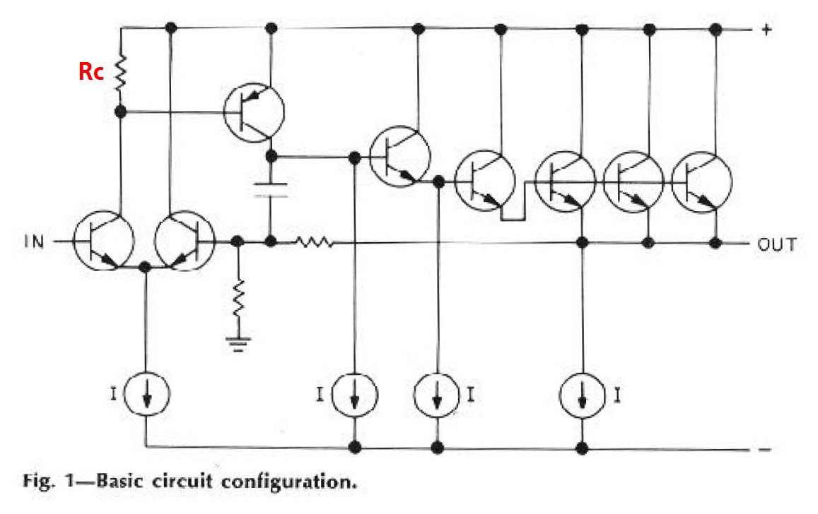

minimalists (e.g. the famous designer in post #9136) use just one resistor.
_
I recognize that from his first published design which appeared in Audio magazine (RIP). I've got the specified power transformer for that PA... I recall Bob had a rather ambitious construction project published in the same magazine. I've got PCBs, ICs and switches for that...
