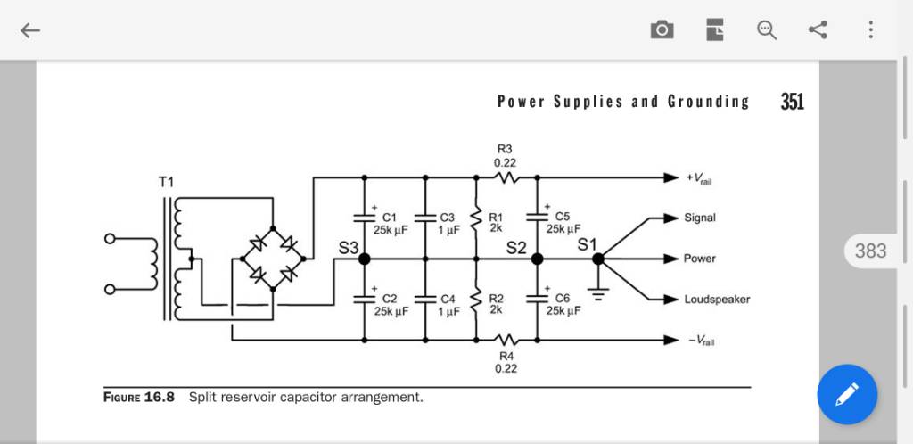

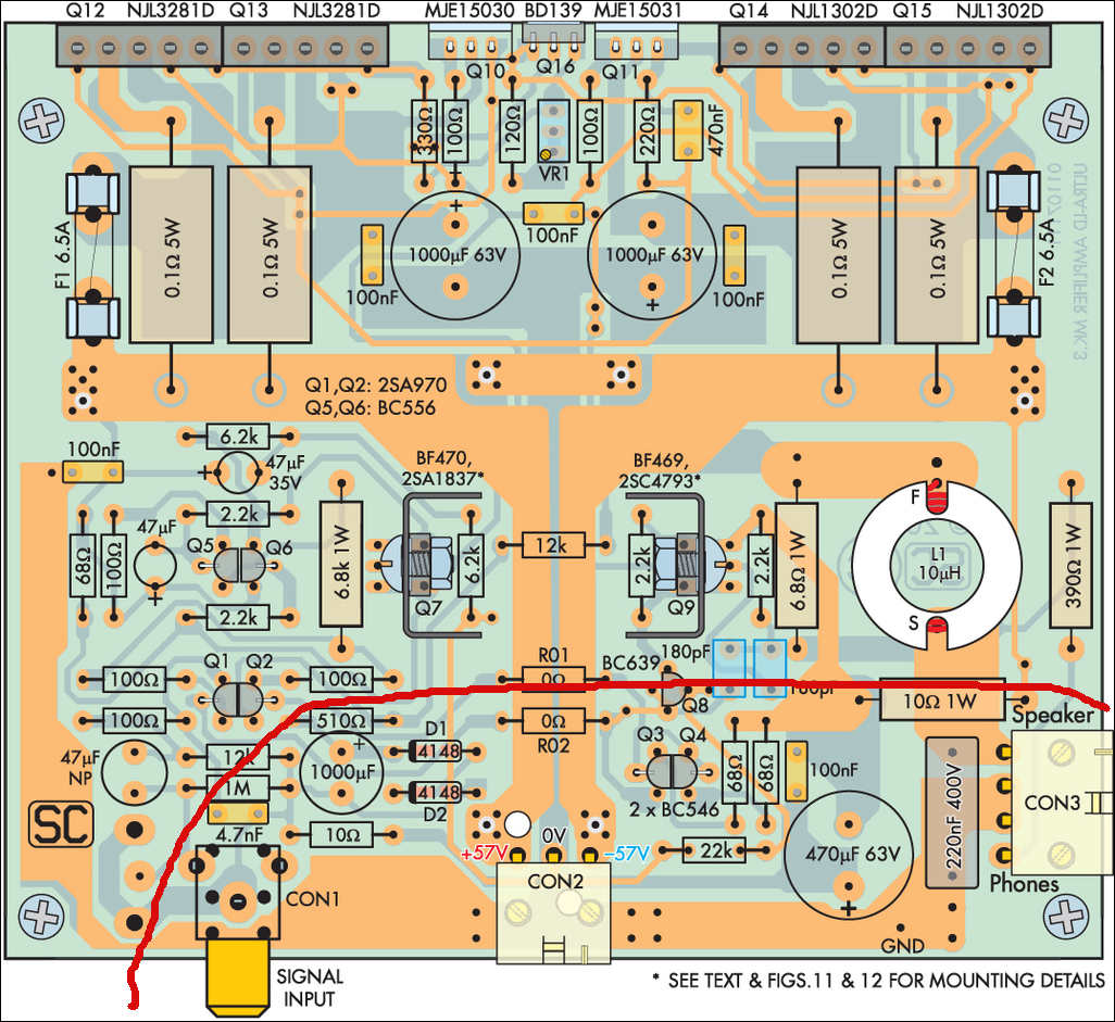

Hi Bob and other forum members.
When you have time I'd be interested to hear you opinion on the grounding layouts. One is from your book and one is from another thread here on DIY. View attachment 749428 View attachment 749429
The most important on board grounding is to return the signal ground to the load and then to the local star ground. Returning the signal and load ground's separately to any other locations will cause a error voltage to develop which will lead to increased noise and worse THD measurements. All PCB designs from proven high precision designs follow this formula. For example have a look at the attached PCB from a low distortion design, you can see the signal ground from the left joining the speaker (load) ground from the right before then joining the local star ground in the middle at the bottom layer of the board.
Low Distortion PCB design is a black art involving proper grounding, decoupling, stray capacitance/inductance considerations, loop area reductions (note in the attached PCB how the V+ and V- traces are right next to each other) considerations etc and i am unable to find any book which tackles this subject. I wish Bob would consider adding a chapter on low distortion PCB design for amplifiers in his next book, if he has not already done so.
Hi Stuart,
That illustration from my book is a bit over-simplified, depicting what one might call a traditional star ground in a figure whose main purpose is to illustrate the use of a split reservoir capacitor. In reality, I usually don't use an idealized star ground like that. It tend to use an arrangement more like a star-on-star ground.
The most important guiding principle, in my view, is to follow the currents, recognizing that every ground wire or trace has some impedance. One can also use the fact that current tends to follow the lowest-impedance path to advantage, directing currents to flow in the directions that you want them to, and through the paths that you want them to.
I also don't like to have high ripple currents flowing through a star ground for which other parts of circuits rely on as ground, recognizing that a physical single star ground can really only be truly equipotential in an ideal world. For example, I merge the common of the reservoir capacitors and the transformer center tap together at a single point and then route that ground point to what might be considered a single point ground. This keeps the heavy ripple currents from flowing through the single point ground node. The split reservoir capacitor approach helps in this regard, and the small-value resistors between the first and second sets of reservoir capacitors help keep the heavy ripple currents flowing in the paths desired.
The fact that the amplifier board is physically different and apart from the main power supply also influences the choice of grounding architecture. On the power amplifier board, there is the essence of a modified star ground. On the board, I will virtually always bypass the main rails locally with 1000 uF capacitors. I usually join the common (ground) ends of these capacitors together and then route that node to what I will call the equivalent of the amplifier board star ground. This again keeps ripple current that flows through those capacitors from flowing through the local star ground. This also helps to resolve the positive and negative rail half-wave rectified signal currents into a sinusoid before being connected to the local star ground.
At this board star ground, the ground from the power supply, the ground from the 1000 uF rail capacitors, the ground from the loudspeaker, and the ground from the rest of the amplifier are tied together. A significant choice that I make is to not route the loudspeaker neutral line back to the power supply star ground; I always return the speaker current to the amplifier board.
Bob
Bob I've questioned whether the board power rail bypass capacitors should be returned on a separate ground to the main reservoir. What's you take on this.
I always return the board rail capacitors, like the 1000uF local rail bypass/reservoir capacitors, to the local ground on the board. As mentioned earlier, I connect their commons together, then return that to the local ground node on the amplifier board. This is the node where incoming power supply ground, speaker return, and the rest of the ground meets. It is pretty much a star ground on the amplifier board. From that ground back toward the input end of the board, I have what could be called a tree ground structure. This is like a ground line that travels across the center of the board, to which other grounds along the way connect. Relatively little power supply rail bypass current and signal current flow in this ground line.
If a ground plane is being used, this is where it would connect. A ground plane is not usually necessary, but if one is used, bear in mind that it is not necessarily equipotential if currents are flowing in and out of it. With a ground plane, you actually lose some control of where and how such currents flow.
I also use what I call progressive rail decoupling. The output transistors are fed from the rails that are locally bypassed with the 1000 uF capacitors from the rail voltages from the power supply. An R-C filter consisting of an ohm or two and 100+ uf to ground then feeds further filtered rail to the driver collectors. From there, a second R-C filter consisting of 10-20 ohms and 100+ uf feeds still further filtered rail voltages to the predrivers, VAS and IPS. This really cleans up the rails, especially at higher frequencies. It also effectively blocks high-frequency signal voltages induced onto the rails from making its way back to earlier stages, suppressing the possibility of HF oscillations.
Finally, the low impedances of these R-C filters, and the fact that they look like Zobel networks to the feeding node, damp HF resonances on the rails, further contributing to stability at high frequencies. Those series resistances also reduce the likelihood of those additional bypass capacitors dumping garbage current into the ground as it progresses back toward the input stage of the amplifier.
For stability, I generally put a zobel network shunt from the output of the VAS to ground. This network is usually about 100 pF and 100 ohms in series. It helps guarantee that that node stays relatively resistive-looking regardless of what the VAS Miller compensation feedback is doing The output of a shunt feedback circuit can sometime begin to look inductive at high frequencies). Bear in mind that if the amplifier clips, that Miller shunt feedback may stop being effective in keeping that node low impedance at high frequencies. The 100 pF limits VAS slew rate to about 100 V/us for a single-ended VAS operating at 10 mA.
If using a 3T current mirror with a helper transistor, I place a 470 pF capacitor from base to emitter of the helper transistor to reduce its ft and reduce HF inetractions between the output of the current mirror and the input of the 2T VAS.

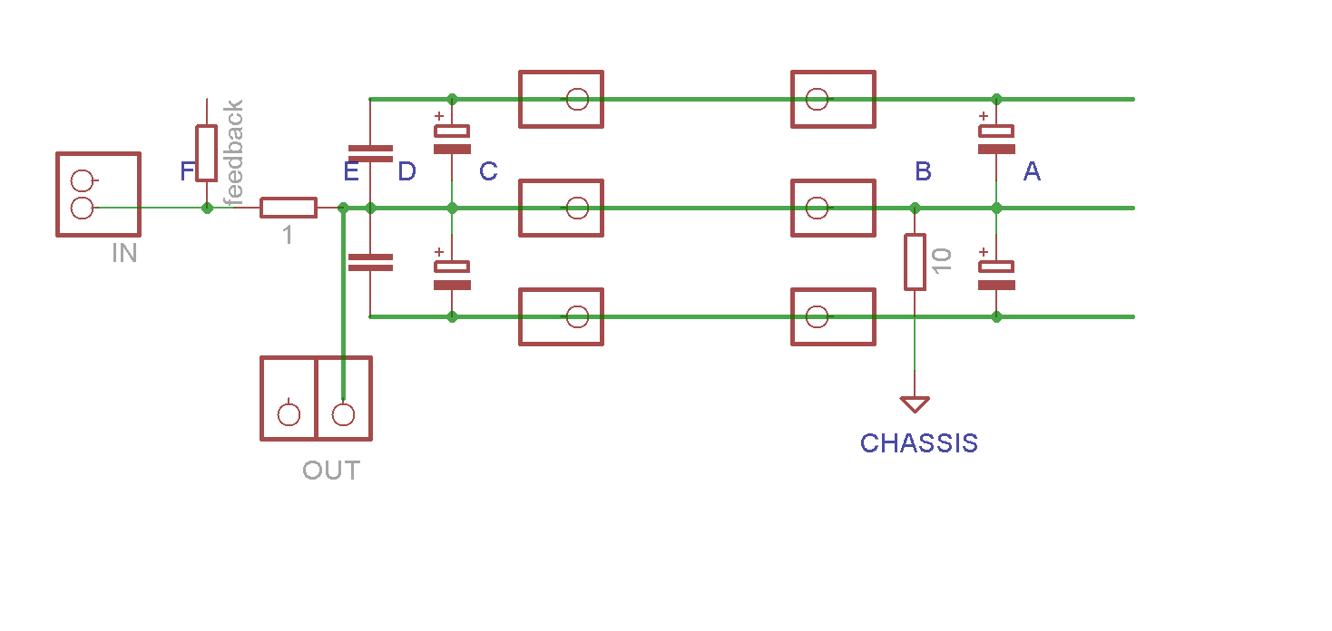

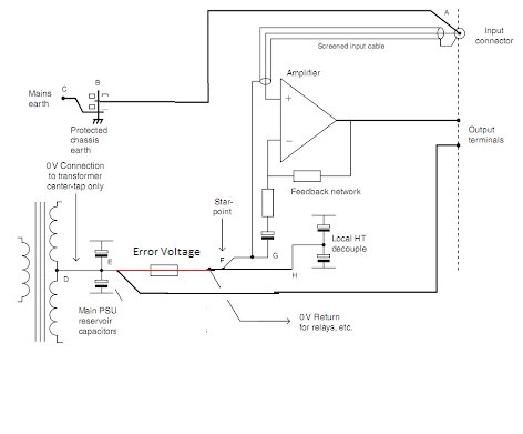

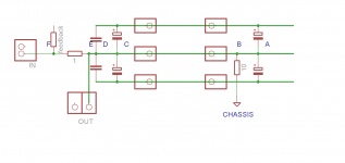

This is what I try to achieve. A-B PSU, the rest is the amp board.
I follow a similar layout, except i dispense with the 1ohm resistor as it induces a output error voltage (albeit small) when referenced to the input voltage. In order to minimize ground loop area, i prefer to join the supply earth and the chassis earth at the input signal ground.
This leads to a dead silent amplifier, no hiss or hum.
