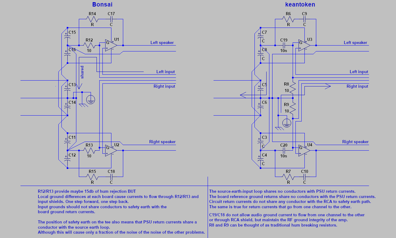

Yes, this is a surprisingly complex topic and it's hard to find a layout without faults. And I agree the optimal layout can change between implementations. I think Bonsai has come closest to making a complete writeup on the topic, but somehow whenever I read it I'm left unsatisfied. Jneutron has shared some advanced ideas from his work on scientific equipment in other threads.
What do you think is the optimal layout for an amp where the channels must share a trafo winding?
Ok - I accept that you are left unsatisfied after reading the presentation. But unless you are much more specific, I cannot address your concerns.
What is it that you do not like about the presentation, or that you feel is lacking?
Here it is, page 58:
http://hifisonix.com/wordpress/wp-content/uploads/2019/02/Ground-Loops.pdf
What I don't like is the reliance on ground breaking resistors which only add 15db or so of rejection. But that seems to be a necessary evil.
I made my own diagram. I wouldn't be surprised if this has been proposed on DIYaudio before, but it's easy to pass over this EMC stuff without seeing the significance. The 10nF capacitors entirely break the internal ground loop between channels and between PSU returns and input. This layout is no longer susceptible to magnetic interference when the RCA shields are shorted, as there is no need for any loop area before the 10R resistors. The resistors are no longer as critical as they were, but they still help with common mode hum from the source.
I'm not sure 10nF is enough, I think 330nF would be a fairly safe value.

The diagram is correct. The feedback reference is on the other side of the ground resistance, as it is blocked by the 10R resistor. If the feedback reference were at speaker return before the ground resistance, you would be correct. However this would likely result in a number of other layout problems.
I disagree, the 10mV is outside the feedback loop. You could increase the ground resistance so that the voltage drop is 1 V. Would that mean that the output would only be 19V?
The voltage across the speaker would be 19V. The voltage to ground at the amp output would be 20V.
How does the 10mV across the ground resistance change any of the feedback voltages? That 10mV is no different than if you put a resistor in series with the speaker and measured the voltage drop across it.
You didn't answer my question of how the 10mV affects the feedback loop. The 10ohm resistor is only shunting the ground resistance. They share the same nodes. One pin to speaker return, the other pin to ground. The resistors are in parallel. There is no voltage between the two ground symbols, they are the same node.
On the other hand if you disconnect the input return from ground, you will get 20V across the speaker because the signal reference is floating at the speaker return voltage.
