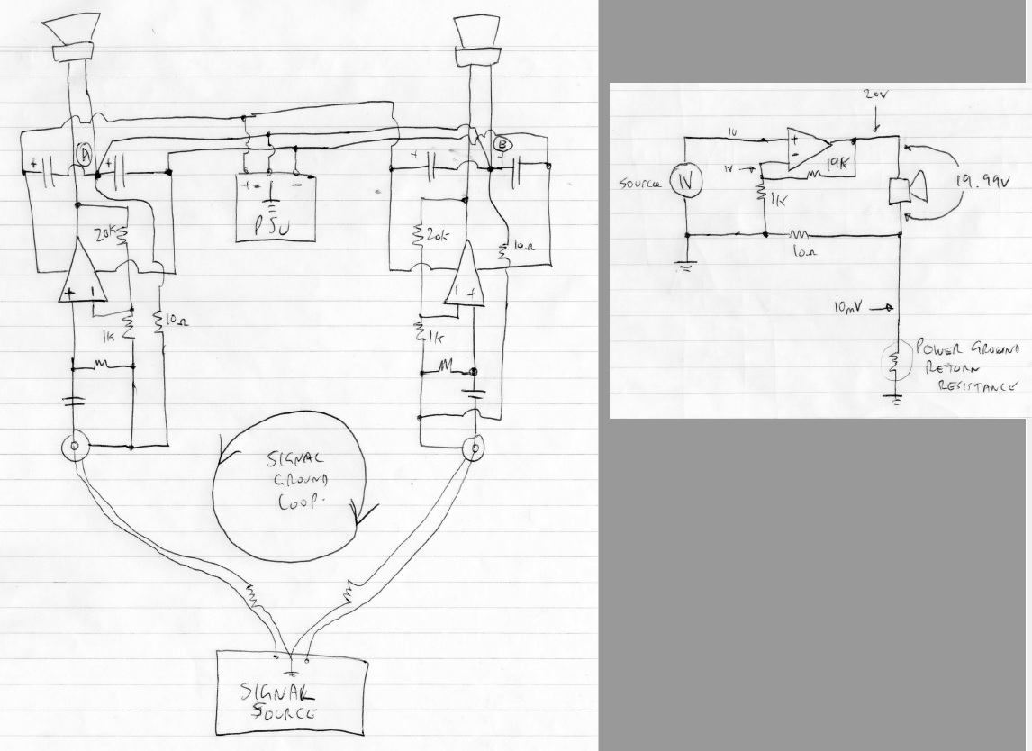

I have attached a simplified scribbled drawing that illustrates the problem that everyone seems to be missing. It shows a pair of typical amplifier modules with the speaker returns terminated at the amplifier PCB and the amplifier modules sharing a common power supply.
Between points A and B, due to the finite impedance of the ground return wires to the PSU, a potential difference will be induced by both the speaker signal return current in addition all of the rubbish coupled from the power supply rails into the ground return by the local supply rail bypass capacitors.
So we now have separate "signal ground" areas on each power amplifier board. The problem occurs when the signal source is plugged in, forming a loop by shoring these signal ground together.
The unavoidable potential difference developed between points A and B is now impressed across the signal ground. A common "cure" to this problem is to attempt to isolate the "clean" signal grounds on each amplifier PCB by connecting it to the "dirty" power ground via a low value (typically 10 ohms or so) resistor.
This approach reduces, but does not eliminate the issue because any potential difference developed across these resistors is still a signal ground disturbance and essentially subtracts from the voltage developed across the speaker. The disturbing thing here is that the effects of this signal ground loop will not show up in distortion measurements unless the signal grounds at the input jacks are deliberately shorted together (as they are when a signal source is connected). I have seen amplifier distortion performance and inter-channel cross-talk degraded by anything up to 30dB by this simple expedient.
Separately returning the speaker ground returns to the individual amplifier boards is perfectly fine when each amplifier has its own independent power supply, but no matter how much anyone many care to moan, it is a sub-optimal and inferior approach when all of the amplifier modules share a common power supply.
I believe that many here already do understand this problem.

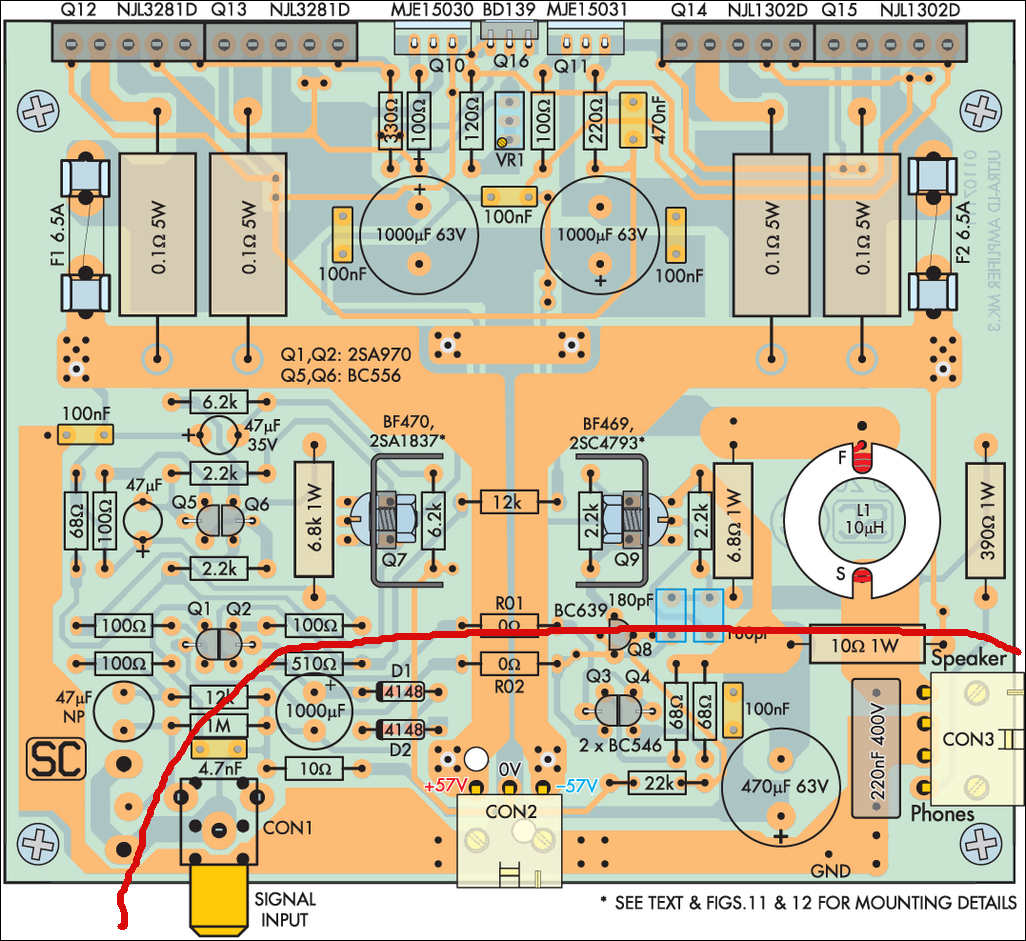

Bob is correct here, the speaker (load ground) should be joined to the signal ground and then returned to the local PCB star ground. Connecting the speaker ground and signal grounds to separate places means a error voltage develops between the two. This error voltage is worse if you connect the speaker ground to the offboard main power supplies ground which carries heavy current pulses.
Please have a look at professional, low distortion PCB designs, they always return the load ground to the signal ground on the PCB, and then the local star ground is returned to the main power supply star ground. Have a look at the attached low distortion (0.004% THD) design and see that the signal ground on the left meets the speaker ground on the right and then is joined to the local PCB star ground in the centre. There is no hum breaking resistor. This leads to dead silent amplifier modules, no hum.

That speaker return and signal ground termination is perfectly, 100% fine so long as the amplifier module has its own independent power supply, and it doesn't in any way contradict a single thing that I have written!
If, on the other hand, a common power supply is used amongst multiple amplifier modules, then it is sub-optimal (hum-breaking resistors or not!) for exactly the reasons I detailed with a schematic diagram in my previous post.
In this case an "ideal" wiring arrangement, as far as signal ground integrity goes, can only be approached if BOTH the speaker ground returns and the signal input grounds all share a common earthing point (although the speaker grounds can be actually be a terminated a little bit down stream in the star-earthing hierarchy).

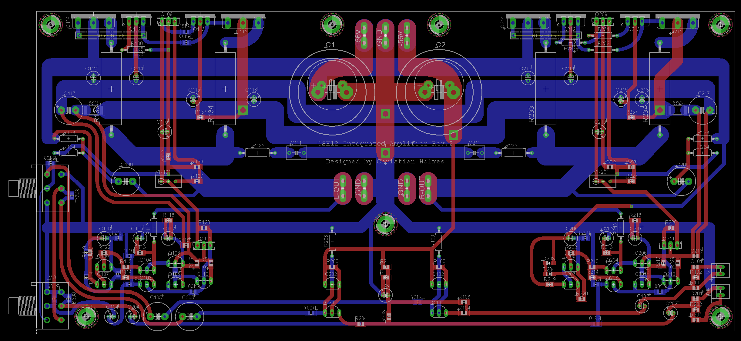

Yes, this is a surprisingly complex topic and it's hard to find a layout without faults. And I agree the optimal layout can change between implementations. I think Bonsai has come closest to making a complete writeup on the topic, but somehow whenever I read it I'm left unsatisfied. Jneutron has shared some advanced ideas from his work on scientific equipment in other threads.
What do you think is the optimal layout for an amp where the channels must share a trafo winding?

Agree with that, the ground layout is so important to get the best out of a design and very little to be found in the books or online.
