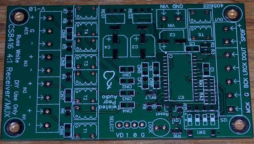

Thanks again, that does raise another question; if I have two S/PDIF sources (this will likely be at home only, so Optical S/PDIF and Coaxial S/PDIF), would I need to use a multiplexer like the WM8805 or can I run two wires straight to the Sabre DAC? I'm thinking a simple DPDT switch is also an option, but I haven't found one that is 75-Ohms.
I designed this just for the occasion.
Cheers!
Russ
