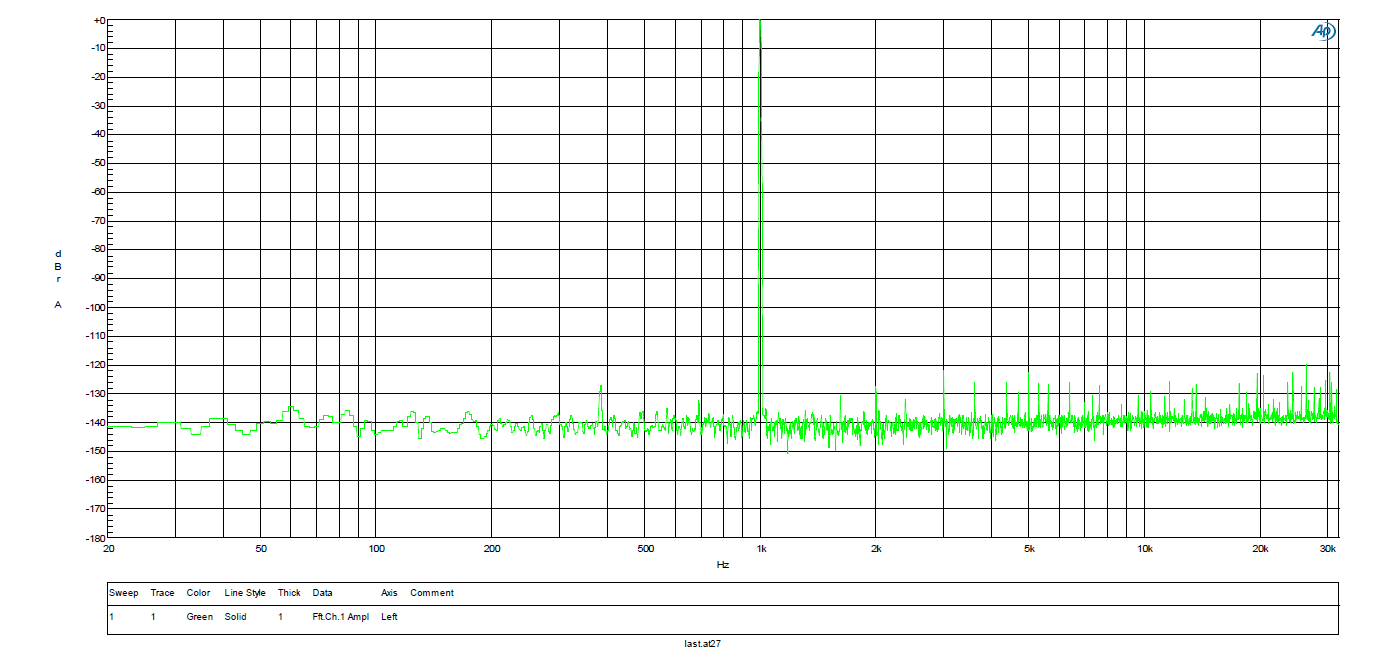

So, the loopback measurement was done SE?

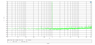

Previously presented measurments was done balanced (PP). Whed I disconnect one balaanced output eg OUT- then 3rd harmonic stays and additionally 2nd harmonic shows up
BuffaloII SE (one complementary output) to EMU:
You should not be seeing that degree of 3rd harmonic, something is clearly wrong either with the setup or the measurement. It is not easy to obtain good measurements from a PC solution even from the EMU device. The problem is that the ADC itself can introduce some very nasty errors. This will not really be noticed in a loop-back situation. Also simple things like how you run the measurement cable etc can make very large differences.
Since you are using the DAC in an extremely bad setup (voltage out etc) I am not completely surprised. But your measurements are particularly off even compared with what others have posted here and other threads, but most of those people are measuring complete solutions.
We have had the Buf II tested several times with AP. And we easily achieve the results stated in the datasheet with IVY-III. Legato also comes very very close, but it has no global feedback, so THD is very slightly higher.

If problem is in EMU's ADC is must be visible on loop test (physical cable from EMU DAC to EMU ADC) but it isn't. Both situations are the same, only different DAC

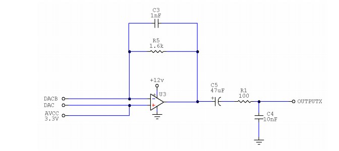

Sabre32 DAC in voltage mode should have -108dB THD - its enough for me. I use this setup because of testing tube output stage (tube is voltage driven device).Before I do measure performance of tube stage I need to define source (BuffaloII) and meter (EMU ADC) performance. And I did, and my results are that the EMU DAC with OPAMP output stage has better THD performance that alone BufII (I'm suprised).
I know that datasheet THD is true for sure - I try to figure out what is the reson of my bad results.Maybe I made something wrong or my BufII is lightly broken...
