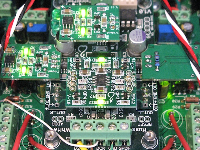

I am running two buffalo II with one legato 2.0.
I am in the process to replace the linear PSU with Salas shunt.
On the Legato manual there are the current requirements, but these are for the Legato 1.
How much current should I give to the legato 2.0 ?
Does it change anything the fact that I am running double current ?
What's the contribution of the balliste ?
Additionally it looks my buffalo drain only 65 mA. Am I doing something wrong ? The manual says 290mA.

Are you measuring the correct current? - If you are using the Placid for the Buffalo supply, 65mA looks like the shunt current. If you are using the Pladid check that you are measuring the voltage drop across the correct resistor. I have Tridents installed so I can't comment directly on the standard install but 290mA would seem about right given that after adding the Trident shunts the draw is around 500mA.

I just put a 0.5 ohm resistor and measured the drop. I have a linear regulator now.

Did you have the AVCC module installed?
Out of curiosity: what is the rationale behind, and benefit of, two Buffalo's for one Legato?The real reading is 240mA for each Buffalo and 200 mA for the legato

I was fortunate to order a set of the fast-selling tridents offered last week and they came today. My chassis restricts overhead space so I managed a low-overhead installation by using straight header pins - after taking a little bit of liberty on the board corners using a Dremel.
The top of C11 is insulated using electrical tape because the VDD_XO board plugs into place and can drop to contact the top of the cap.
Early concerns surround Placid temperatures. Mods for the hotter of the two heatsinks have temps down to about 150F (~65C) while supplying ~440ma. What sort of minimum stable shunt current do you guys suggest?

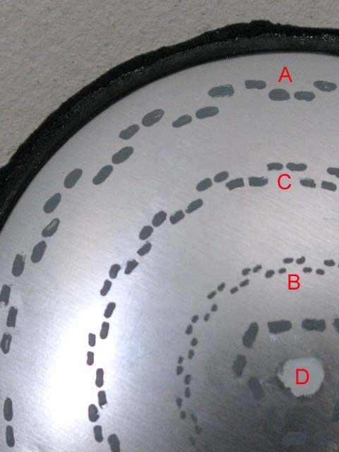

The new tridents in my system were causing low-treble fatigue (centered @ ~4500 Hz) and I discovered ~90% of the problem. The added energy in the output signal was causing the surface of my midrange domes to break up and support radial surface distortion. This is strong evidence for the fundamental power involved in Tridents' sound enhancement because the drivers sounded absolutely clean before Tridents were added to the B2.
The solution to this problem: The JBL LE8T-H domes are 2" in diameter. I previously tamed them for the stock B2 using interference rings A and B, plus the center treatment (D). Today I added interference ring C to the 1.6 cm gap between A and B and almost all of the objectionable treble is gone. I'll listen for a while before deciding what to do out on the paper cone - if anything. The great thing about these ring interference patterns is that they don't need to be perfectly drawn and they don't hurt the sound if they are placed somewhere that didn't really need them. In this case, the new ring (C) was very helpful.
Bottom line: Tridents are not a minor tweak!
