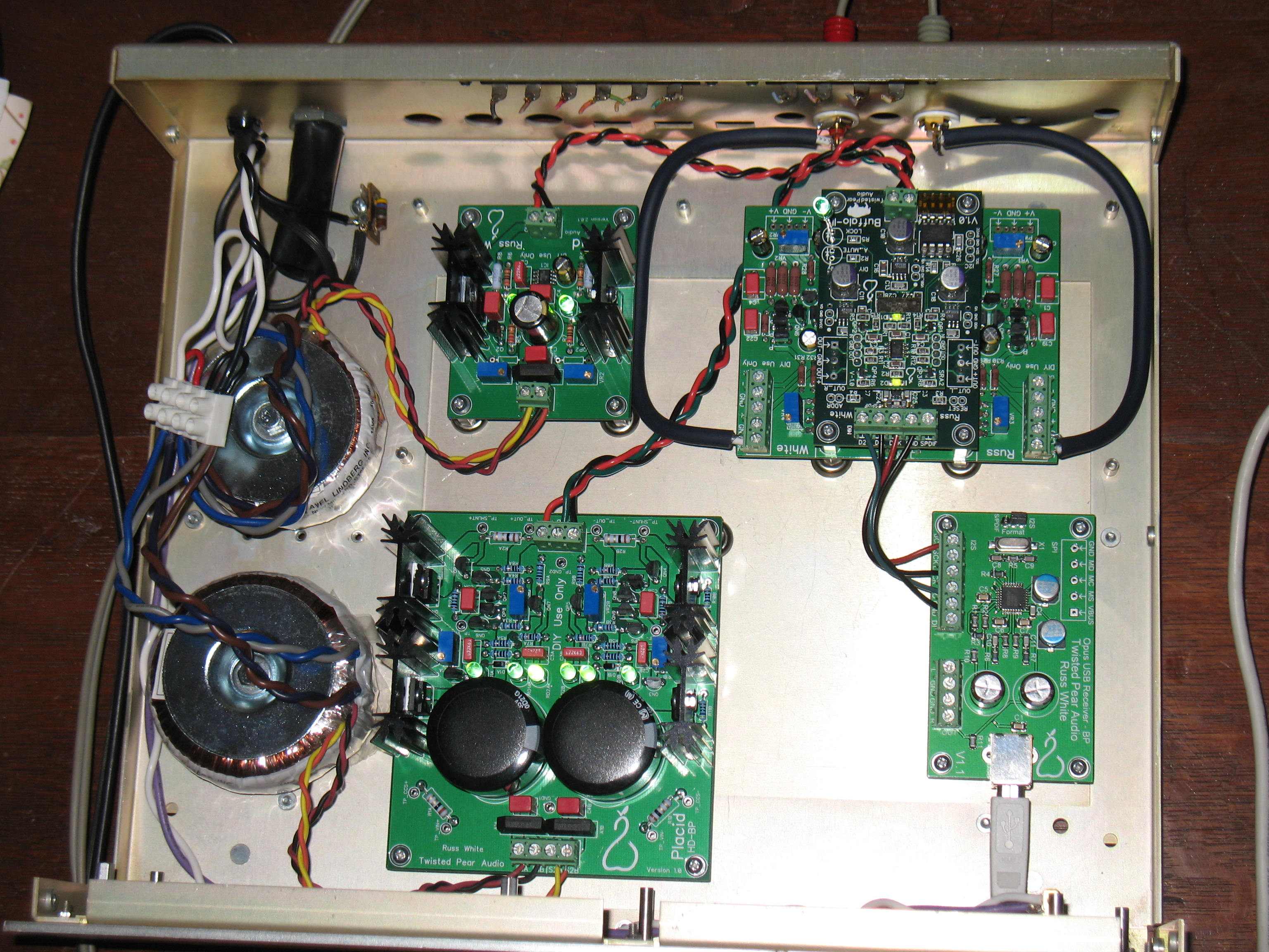

BII drop-outs
Help: I'm still getting drop-outs from my BII system. I've tried a bunch of different approaches and I'm still getting the occasional hickup, averaging 1/minute. Although sometimes a whole song (3 min) will play cleanly, other times I'll get 3 drops within 15 seconds.
I assembled my BII about 2 months ago using all TPA components: USB receiver/DAC into a BII via I2S, BII into a Legato 3 I/V stage. Placid for the BII, Placid HD for the Legato. AC via the recommended toroidal transformers. A few weeks ago I installed the Firmware Update chip for the BII.
Following Leon vB's excellent integration guide and the other manuals, everything fired up smoothly, yielding wonderful sound, really much better than I expected. So now that it is so, so good, I want it to be perfect.
I started with this Mac PowerBook G4 with Itunes, then I installed COG, then I tried my girlfriends Intel Mac laptop using Itunes, then Audirvana. Switched USB cables. No difference.
I've attached a photo of the assembly. I tried to make the I2S connections equal length: they are about 3 inches long.
I have not tried switching to S/PDIF between the USB receiver and the BII, yet.
I would appreciate any suggestions or corrections to my build.
Thanks very much, - David

Do you mean you installed this:
"High Bandwidth" Firmware for Buffalo-II
Alternate firmware chip for B-II users experiencing lock issues with some particular I2S sources.
How does it work with the original firmware?
[Note: let the DAC warm up 30 minutes after power on before you do your observations]
