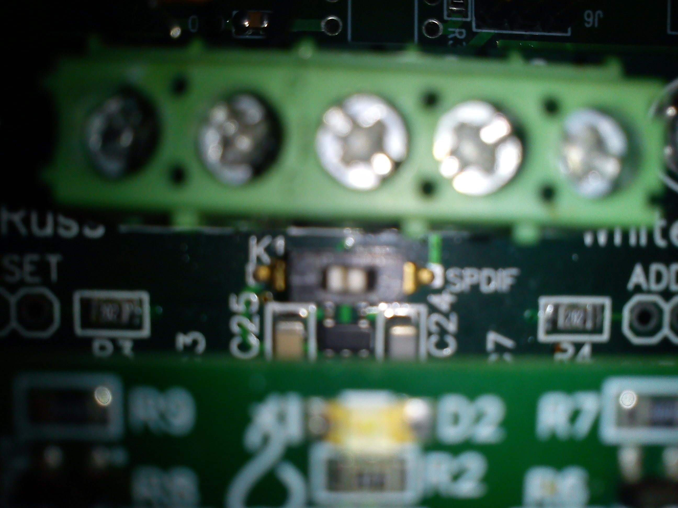

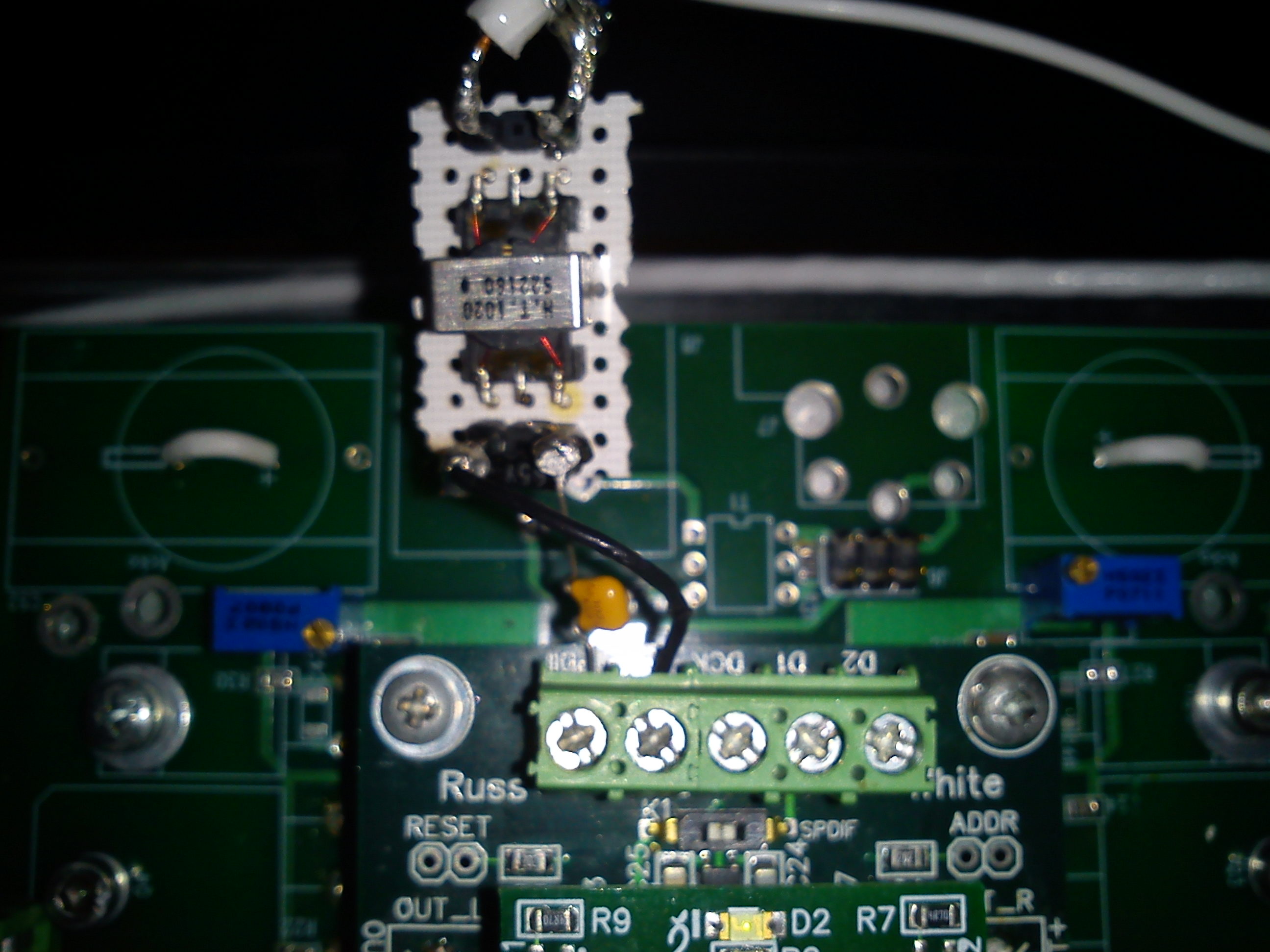

BII glitches/dropouts
After adding a pulse tx with a 75R & a 0.01uF ceramic cap still I have glitches/dropouts each 6 or 7 songs, stops 2 or 3 seconds & starts again playing.
I'm using S/PDIF input with hiFace & with a CD transport, with both I have the same issue, I tried to use D1 input instead S/PDIF changing the switch S/PDIF to off but no sound, the problem is with all formats 16bits/44kHz (CD transport) or hirez files with hiFace usb-s/pdif 24bits/192kHz or 24bits/352.8kHz (hiFace usb-s/pdif)
I left the DAC powered 30 minutes or more before playing music.
I heard changing the clock solves the problem for hirez files but my problem is with all formats, any idea to fix the issue?
AVCC module LED D2 don't lit
Attached pics pulse tx & S/PDIF switch in ON position.
