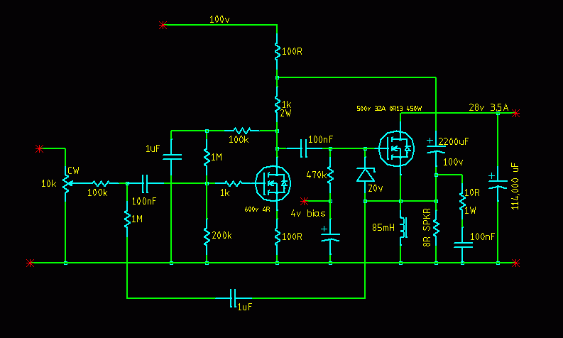

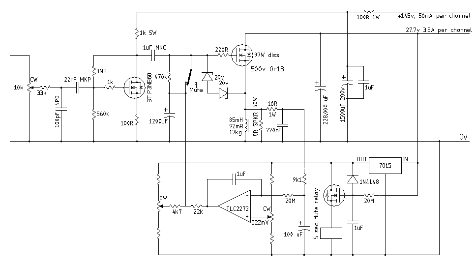

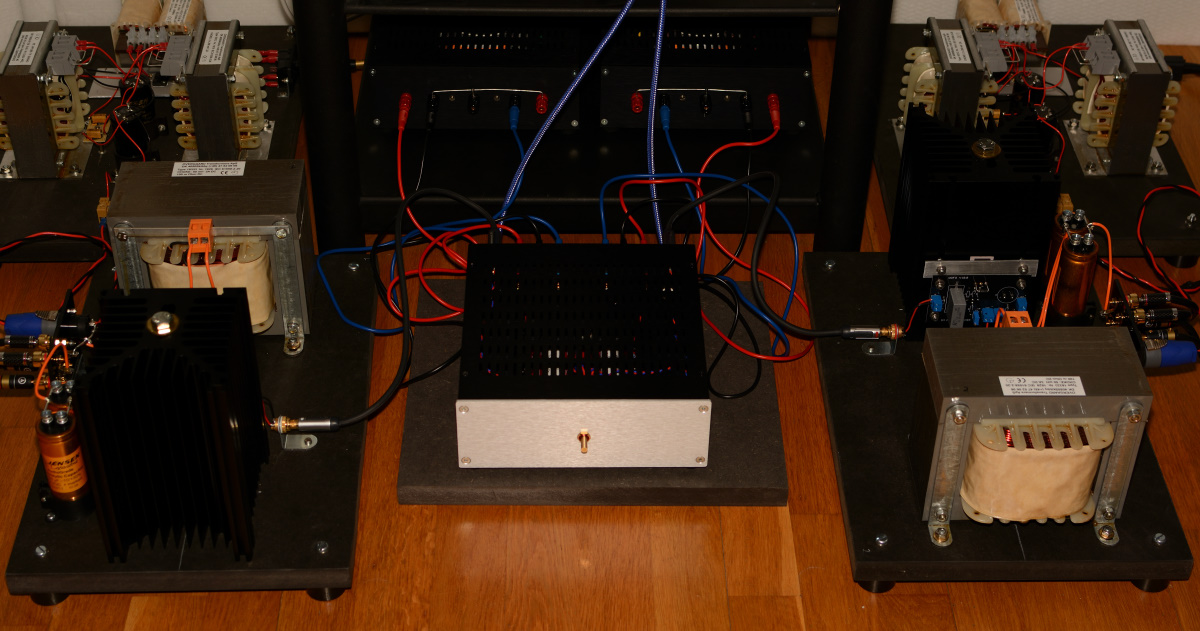

Hey Michael, thanks for bringing this topology back to everyone’s attention. For those that haven’t heard this kind of setup, it can sound believably good, especially considering it’s simplicity. For those that haven’t seen it, here’s my adventures with making this kind of amplifier some time ago. -> My first ever Class A amp.
Hi Circlotron,
Nice work! Thanks for sharing your build (from 2002) again. Seems that you are getting great efficiency at 50% - impressive as it takes me 150w dissipation for 50w output, so only 33%. Also, was dissipating 100w from your MOSFET with a conventional passive heatsink (which doesn't appear to be all that big) an issue?
Can you explain what the 2200uF cap tied to the speaker +ve and then the other end tied to the voltage divider from 100v does? It appears to be a bootstrap, and perhaps this is one way you were able to get the higher output without clipping the top?
Thanks,
X
2880d1033008529-class-amp-50w-class-gif
353157d1370612447-class-amp-class-005-jpg
Yeah, it's for bootstrapping. I was trying to get the gain of that first mosfet as high as possible. Eventually used a CCS load as well as bootstrapping and the gain was something like 3000. There was issues with LF instability where the speaker would slowly move to and fro on loud program material.Eventually settled on the cct attached here. Still have the amp sitting in the corner. Hasn't been fired up for yonks.

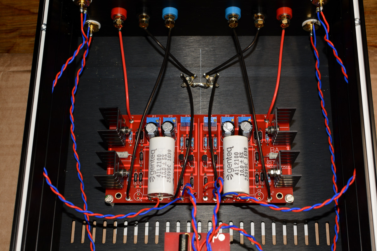

I just finished my BA3-pre with dual mono external regulated PSUs. I use 1m long lab banana cables in the moment for powering the BA3-pre (will make some dedicated cables later) but even then the setup is silent with no noise or hum. This also shows that twisted pairs can be quite good as signal cables. I was able to put two gnd wires in the same hole on the BA-3 pre PCB. BA3-pre works perfect with MoFo! ….a nice pair!
I have not played with P3 yet so P3 is just in the center position. Compared to when I use the pre in NAD M3 music is more dynamic and room definition better.

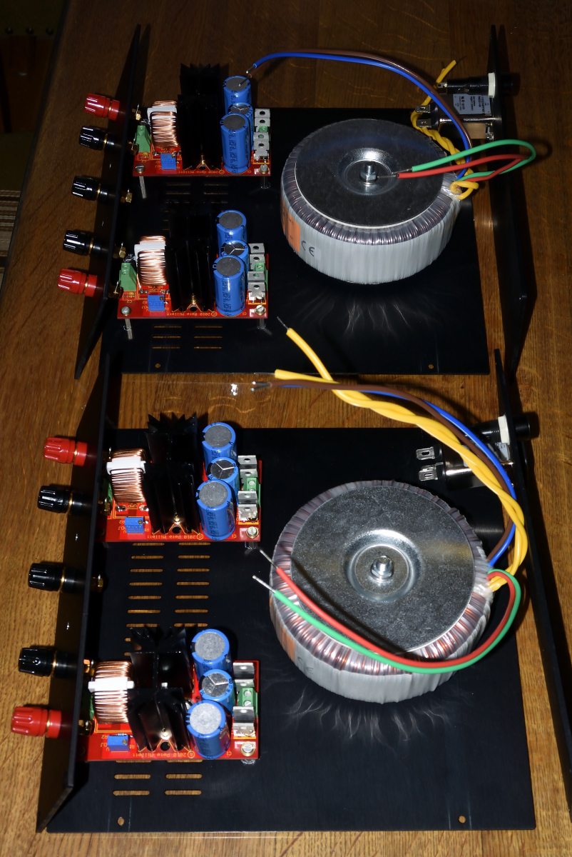

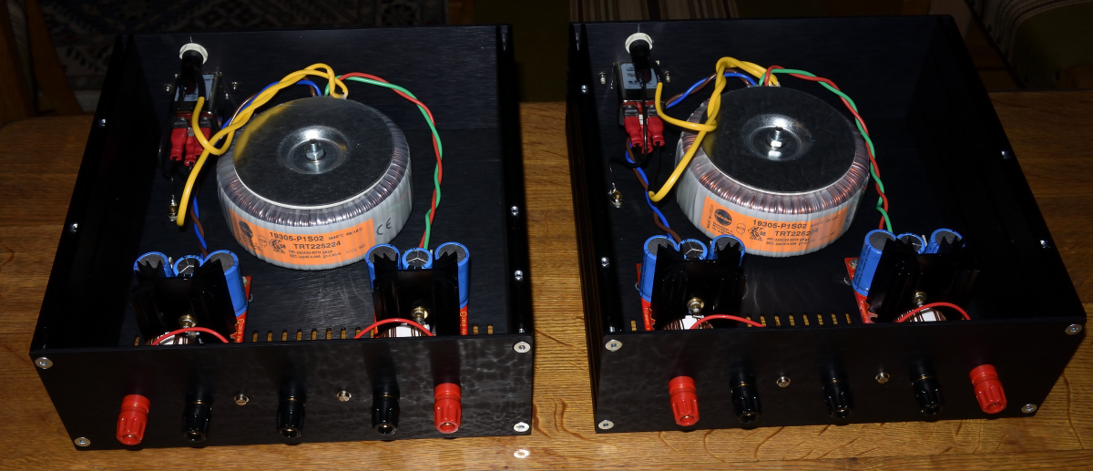

MEPER: I'd like to see some details about the regulator you are using for your BA-3. I built a set of regulators as indicated here Using 3-pin regulators off-piste: part 4 but they don't seem to perform as promised. My noise floor for the PSU seems to clock in somewhere near the -75bB mark...
Those regulators are Pete Millett's designed primary to be used as 5V filament supply for e.g. 300B tubes. It was also my intention but I found another solution. Then I asked Pete for recommendation for component values if I wanted about 24 VDC (I have adjusted my for 26.5 VDC) so I run -+ 26.5 VDC.
Regulated DC filament supply
It is based on a 1084 regulator. C3 is interesting as it will suppress "noise". In the application notes for 1084 it is described down in the last sections…..and it seems Pete has read it all 🙂
This was the suggestions from Pete for component values when voltage is raised from 5 to e.g. 24 V:
"To keep power dissipation in limits, you should change R3 to 270 ohms. R1 + R2 would then need to be about 5k. You could make R2 4.7k and R1 (the pot) 1k. R4 should also be 5-10k.
You need to use caps with a high enough voltage rating, the biggest that fits is good, probably 2200uF 50V on the input and 100uF 35V on the output."
I think it is a straight forward design around a standard regulator but with all the small tricks to make it as clean as possible. I think the layout of the PCB and the compactness has something to say also. 500 mA is not problem but at 1A the heatsink temp is too high so it is low current PSU and also the amount of on board caps are limited. Perfect for preamps.
