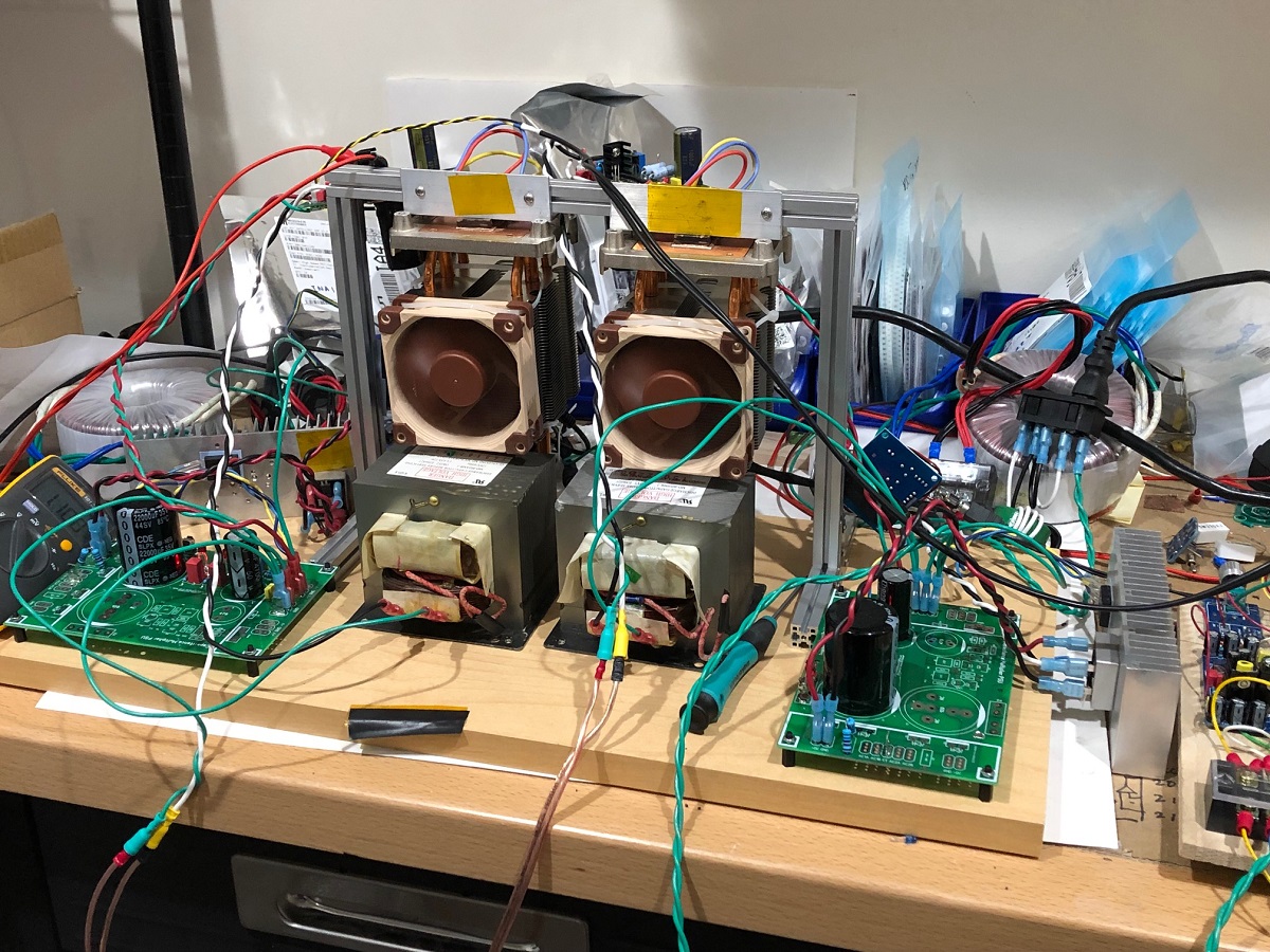

Finally, MOAMOFO playing in stereo. Dual mono setup with independent 37v @ 4.5amps provided by a pair of Antek AN-3232 powering JK-MrEvil Cap Mx's, and voltage gain provided by Aksa-Lender Melbourne preamp. Good for 50wrms into 6.8ohms. Quick test at loud levels and sound is not congested - nice sounding and can get loud. Now also fitted with Noctua silent PWM fans pushing air through CPU coolers to maintain air temp at 45C.
