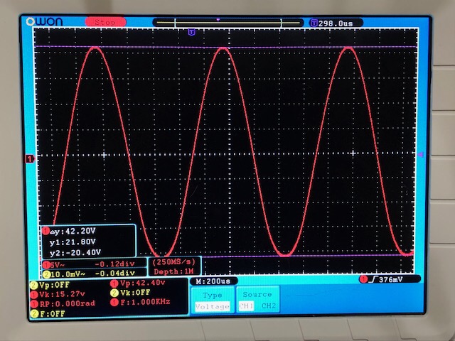

I am currently running the Mother of All MOFO’s and it’s putting an ear to ear grin on my face. 4.65 amp bias current at 37v supply rail with big fat IXYS MOSFET putting out 160w per channel, microwave oven transformer and Melbourne Preamp driving it. My Melbourne was running on +/-24.5v rails so max output was limited by Preamp at 42.4Vpp into 8ohms. I will boost preamp rails and should be able to hit 50wrms into 8ohms. Here is recent O-scope shot at onset of clipping.

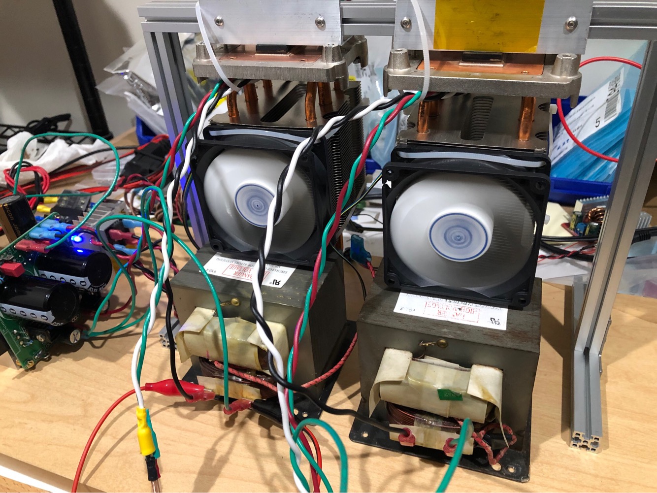

Cooling is of course provided with a heatpipe CPU cooler and PWM fan. MOSFET body temp is only 50C so not even hot.

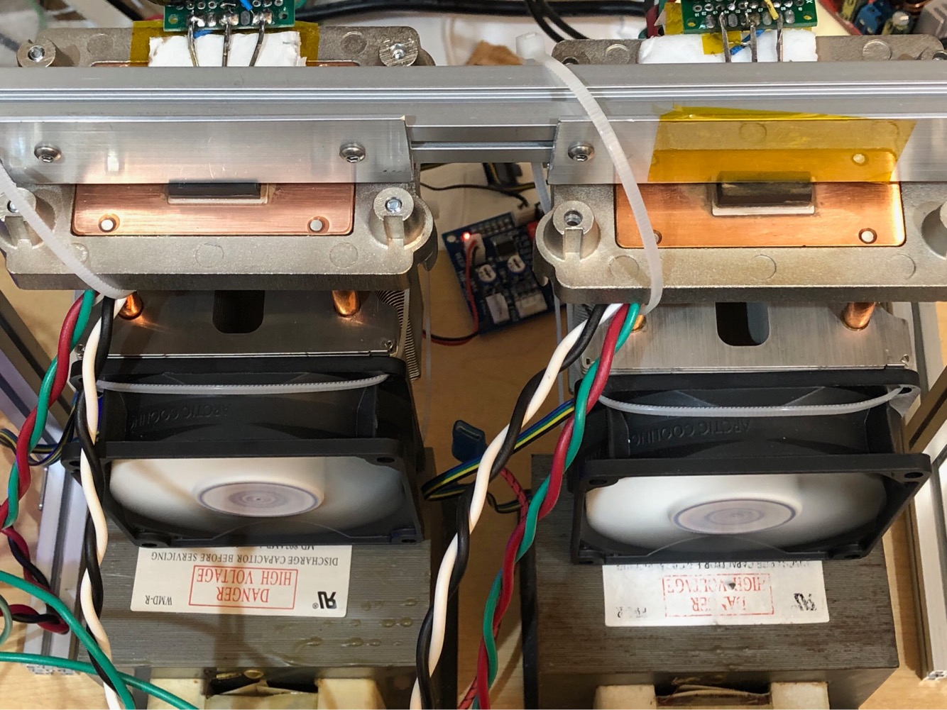

Here is how the CPU coolers are mounted to the MOSFETs. I am using ceramic spacers and heatsink compound (2x better than keratherm pads). CPU coolers are surplus Dell units with the big copper pad. I recently got these 15mm T rails from Maker Beam. Nice stuff.

Thanks for the kind words KP, but it’s no big deal to use tinker toys to assemble heatsinks.
I am still assembling the cap Mx and second power trafo, will have stereo soon and will describe sound once I hear in stereo. In mono, it sounds like a MoFo for the smoothness and transparency but with the grunt of what feels like a 100w Class AB when driving a low sensitivity speaker.
Very smart idea to put the CPU cooler upside down. I have ordered some Arctic F8 PWM rev.2 fan tonight. It should do the trick.
Cool built, thanks for sharing your pics, congrats!
I had an F8 and it’s kind of noisy. Just got a Noctua NF-A8 and OMG! You cannot telli it is on based on sound. This is with the little LNA (low noise adapter cable that comes with it limits RPM to 1750). I mean silent with ears 3in away. They did some amazing CFD tweaks to the airflow to stop sources of the noise. Very few products have blown me away quite like this one. I mean there is no comparison with any other fan I have heard. Totally worth $15ea.

With Noctua NF-A8 MOSFET body temp is 70C at lowest (inaudible) fan speed. With temp sensor in place it brings MOSFET temp down to 50C and fin temp at 40C. Noise is audible barely at 8in.
