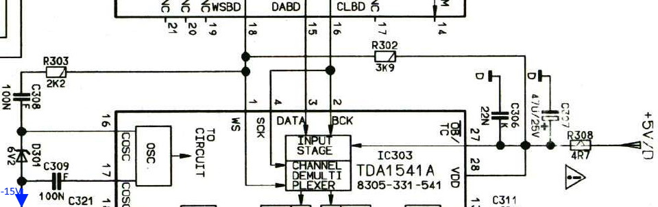

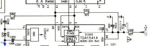

I just want to hang in there ... I was about to try the Grundig mod, but I'm usually to lazy to setup a measurement....
From the Philips FT990 DSR (a Grundig Design, as can be clearly identified when one sees the layout)
@ John: have you tried that particular setup?

Hi weissi,
This mod works, but the DEM frequency (standard component values) should be somewhere between 200 KHz and 250 KHz.
In this schematic I assume that 4x oversampling is used. So WS signal frequency (that drives the DEM clock here) equals 44.1 * 4 = 176.4 KHz.
When using NOS, WS frequency will be 44.1 KHz and that's too low for standard (data sheet) active divider decoupling cap values.
The decoupling cap value is related to the DEM frequency, lower the DEM frequency requires higher value decoupling caps.
One option with NOS is dividing down the BCK signal. The division factor depends of the frame size. Frame size of 64 bits (I2S) is most often used.
For 64 bits / frame BCK frequency equals 2.8224 MHz @ 44.1 KHz sample rate.
The DEM divider therefore needs to divide by:
2822400 / 176400 = 16.
So this Grundig circuit can be used for NOS DACs by dividing BCK by 16.
It is best to use a synchronous -binary- counter like the 74HC161(74HCT161, 74LV161) for example.
pin 3, 4, 5, 6, 8 -> connect to GND
pin 1, 7, 9, 10, 16 -> connect to 5V
pin 2 -> connect to BCK
pin 11 -> connect to Grundig circuit.
Don't forget to place a 0.1uF ... 1uF decoupling cap between pin 8 and 16 (as close to the chip as possible).
When using SIM (Simultaneous, feeding L + R data into the TDA1541A simultaneously) interface, BCK rate may differ, that's no problem as we can choose between following options with the 74HC161 divider:
pin 11 -> divide by 16
pin 12 -> divide by 8
pin 13 -> divide by 4
pin 14 -> divide by 2
So all you need to know is the exact BCK frequency for SIM and choose correct division factor (output pin of the 74HC161) to get 176.4 KHz DEM frequency.
Other option is to use 44.1 KHz WS frequency and increase decoupling cap value to 2 ... 2.2uF.
One could stack 2 x 1uF/16V SMD 1210 SMD film cap from Panasonic / Cornell Dubilier or use (WIMA) 2.2uF film caps.

Hi Berny,
I tried the circuit from Henk ten Pierick, it sometimes works and sometimes doesn't. It's a critical circuit and transistor properties (HFE, Vbe) have impact on stability. I also got spurious oscillations from both 1.2nF caps so I increased the value to 100nF (Grundig mod also uses 100nF).
Even when it locks, there is still considerable jitter on the DEM clock and it can lock out again as chip temperature (and related Vbe) changes. It helps to thermally couple both, transistors and TDA1541A and use a dual transistor with good matching.
Best results (lowest jitter / noise) clock injection was obtained using ECL (Emitter Coupled Logic). It serves two purposes, a very low jitter divider (using ECL flip/flop or ECL divider) and it offers differential output to drive the DEM oscillator.
The trick is DC level shifting in order to obtain stable triggering of the DEM oscillator. I used a split emitter resistor (ECL requires external load resistors). The resistor connected to the ECL output needs to be bypassed by a capacitor to maintain full signal amplitude while DC level is changed to the desired value.
DEM clock injection is always a balancing act between locking, jitter and noise injection. Remember we are trying to stop oscillation and then inject a signal into an oscillator circuit that is designed to oscillate.
