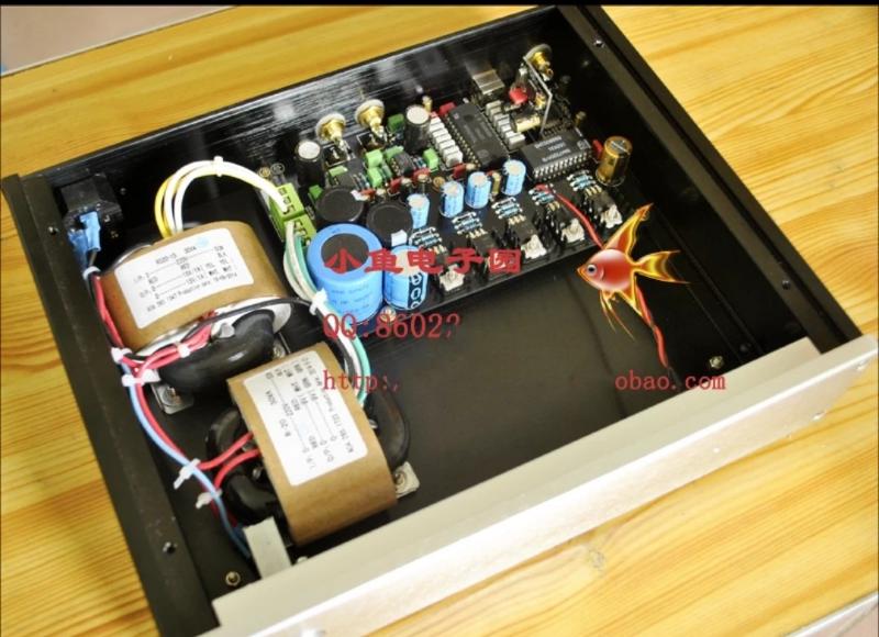

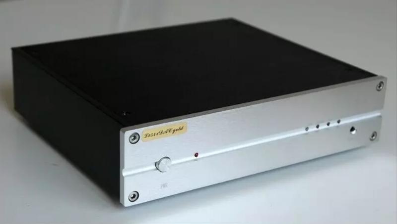

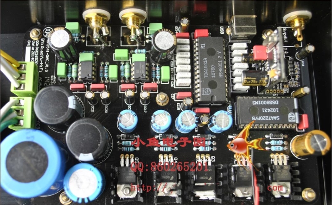

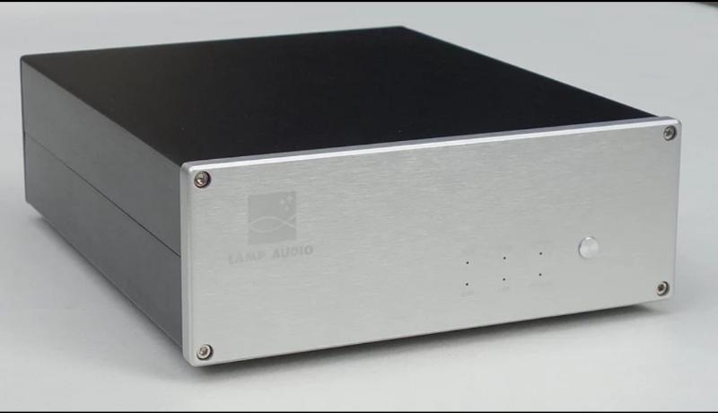

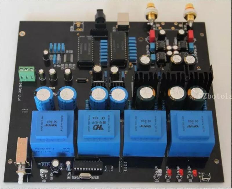

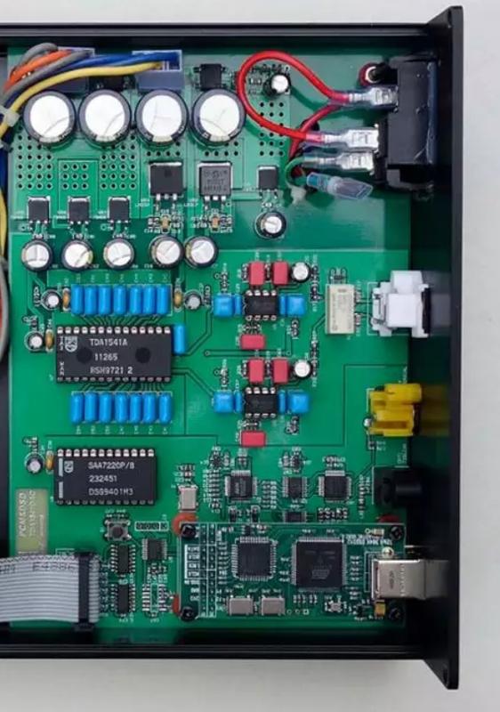

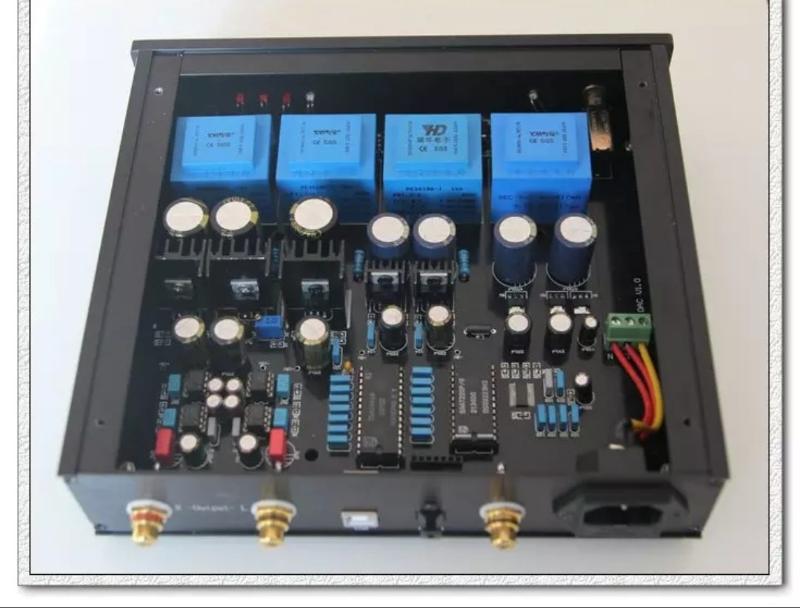

I may be posting this in the wrong place - forgive me if that's the case. I'm a noob to this forum.
Once covid is over I plan to take an electronics course and build a DAC. Until then I've bought a CD player with a TDA1541A chip.
I'm intending to buy a "finished" Chinese DAC to use the chip. I can find three alternatives that are possibilities but I wondered if anyone could advise on which of these three looks the most promising for immediate use and future modding.
Many thanks in advance!

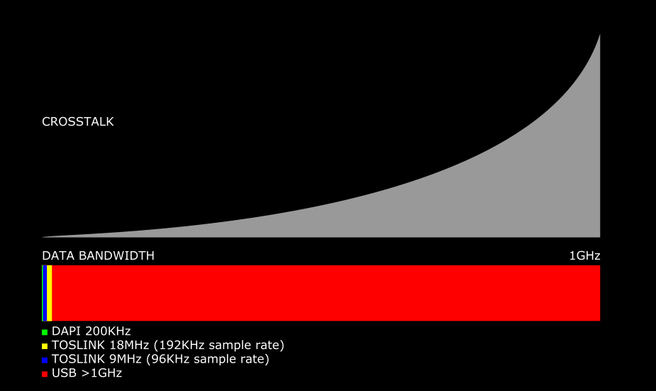

Hi matthiasw,
The S/PDIF DAPI receiver does not replace UPL96 or U192.
With DAPI we have 32 ... 48 parallel data bits (L+R data), these change simultaneously. After all bits have changed, one single LE (Latch Enable) signal is used to latch the outputs and output a new sample.
MCK / BCK clock signals are no longer needed as we use parallel data interface.
This DAPI interface sits between both, the digital audio receiver and Fractal D/A converter.
The receiver part is now based on a single chip (microcontroller), 4-input, 192 KHz S/PDIF Toslink receiver with independent low jitter LE sample timing signal (not recovered from S/PDIF).
It converts S/PDIF directly to DAPI. My brother developed the required software for this micro controller, one could say this is a complete digital (software) based S/PDIF receiver.
Because the LE timing signal is no longer recovered from the jittery S/PDIF input signal, both, source & interlink jitter dependency are greatly reduced.
Now we finally have all required ingredients:
- Perfect galvanic insulation (Toslink / ElectroTOS).
- Minimum data bandwidth (18 MHz, Toslink ElectroTOS).
- Effective source & interlink jitter blocking (independent low jitter timing signal).
- Silent receiver -> DAC interface (DAPI).
- Accurate Fractal D/A converter with "passive" low impedance output, low enough to directly drive headphones & speakers, completely removing audio interlink and (pre) amp related distortion & degrading from the signal path.
Yes, we plan to offer an affordable medium power entry level version that is primarily intended to be used with (pre) amps but is powerful enough to directly drive 32 ... 600 Ohm headphones. Prototype is already up and running and is being thoroughly tested.

Hi matthiasw,
We already designed, built and tested a USB DAPI receiver and I reported about this. Further research showed that this was not the most optimal solution. The same DAPI receiver (everything else being the same) with S/PDIF Toslink input exceeded our expectations.
The S/PDIF DAPI receiver does -not- recover the S/PDIF clocks for D/A converter timing like most other S/PDIF receivers. It uses an -independent-, local low jitter clock for D/A converter timing. So S/PDIF jitter is no longer relevant.
Low Toslink bandwidth and very low DAPI parallel interface bandwidth effectively attenuate S/PDIF -noise-
So we are now free to choose whatever S/PDIF Toslink source we want without worrying about S/PDIF signal quality or S/PDIF input switch related degrading.
The 4 S/PDIF inputs on the new experimental S/PDIF DAPI receiver are I/O pins on the micro controller. Each pin offers the same properties (signal quality) anyway.
-> Macbook pro has 3.5mm Toslink output and can be directly connected to the PowerDAC series, even with 5 meter Toslink fibre and a 3.5mm adapter plug if desired. I am using this for driving my Fractal PowerDAC prototype.
-> Most streamers have Toslink output and can also be directly connected to the Fractal PowerDAC series.
IF one -must- use USB no matter what, any available USB to Toslink converter will do. We offer a tiny (2cm x 5cm x 10cm) USB Toslink converter module that is USB bus powered. The big difference here is that we no longer need a low jitter source as we fixed this problem in the S/PDIF DAPI receiver. This greatly simplifies converter design.
Why on earth provide Toslink only? Why not add each and every existing digital audio interface on the DAC for maximum flexibility like all others do?
The short answer: Unwanted large bandwidth noise injection and ground loop noise injection (poor galvanic insulation). This is the reason we had to abandon the USB DAPI receiver project that we already completed and tested in favour of the S/PDIF DAPI project.
I added a graph illustrating USB vs Toslink vs DAPI data bandwidth.
Larger data bandwidth -> more high frequency noise enters the DAC (fused to the data signal, must enter the DAC to retrieve contained data) and the easier this noise spreads across the DAC (stray capacitances and parasitics).
We can also see from the graph that lower sample rate support also reduces required data bandwidth and related noise injection and spreading.
The ideal digital audio interface foe connecting a source to an external DAC would be a DAPI interface based on 48 separate optical fibres (one for every bit) plus one fibre for sample timing (latch). This would reduce data bandwidth to 100 ... 200KHz, 20,000 times lower bandwidth compared to USB!
When providing multiple different digital audio interfaces on a DAC, one interface can inject large bandwidth noise, degrading all others (noise, galvanic insulation bypass).
With Toslink we don't have this problem (lowest noise injection + perfect galvanic insulation).
More on this subject in my next post.
